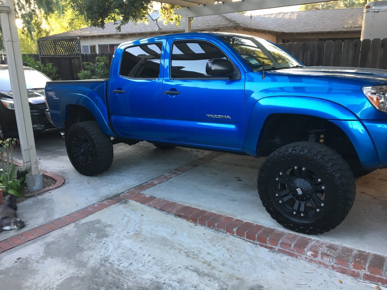

    Hello all, strange one here .. I’m stumped need some help..
    My steering wheel shaking at minor breaking.. So I checked rotors they were not warped..? I was surprised
    But got them turned them anyway.. new pads too.. problem almost solved less steering wheel shake..3 months later they were shaking a lot more and I was a bit concerned.. So I bought 2 front new high temp ceramic bullshit rotors and new pads too..
    Now.. 2 months feb 21 .. shaking a lot.. but only when light breaking which I normally do... when under heard breaking it doesn’t happen or when I’m driving 70mph no shaking..
    Bent rim.. out of balance.?? Wouldn’t it shake at all time and worsen as I speed up.. if that ..? Wheel bearing already changed one few years back going bad..? Ball joints bad ..? A arms bushings bad..?
    I’ve jacked up truck checked everything they seem tight.. .. no play in steering.. at all..
    Torsion bar bushings good..tight I’m at a loss...
    00C2D91F-2DCD-42AF-9E12-12F06DDB2EE0.jpg Thanks in advance..
    2007 taco..
    2 wheel drive
    V6.
    6lug 1 1/2 wheel spacers
    150k
    Well taken care of..

    Follow up:
    checked all caliper pistons functioning/smooth...
    checked new calipers .. no warpage...
    Problem was the Wheel hub bearing..
    replaced entire hub assembly...
    Works perfect no shimmer whatsoever...At soft and heavy braking..!!
