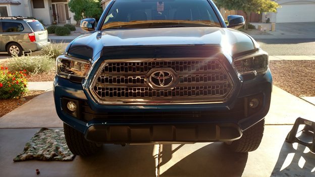

    Below is the truck on the lot…and who Bruce is today.

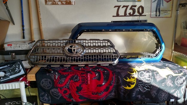

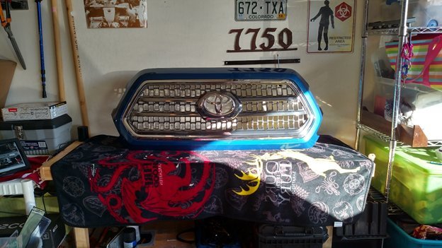

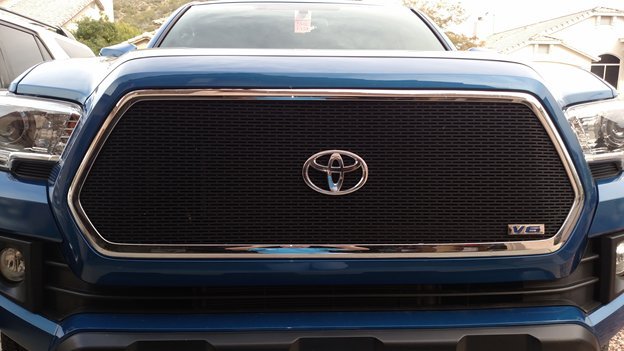

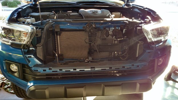

    When I bought my Tacoma I hated the “chain-link fence” grill (that’s what the sales man called it). I actually wanted the SR5 grill. After looking around at other year models I liked the gen 2. All black with a Chrome Toyota emblem. I went on line and found a grill at CustomCarGrills.com with an easy install. Then I looked for a emblem. I found a chrome one off a Solaris 2006 trunk on Amazon (I could not find a Solaris in my neighborhood J)
    The build is as follows. Pretty fun… Kept me out of trouble. (not really)
    Parts list
    Custom Car Grills Mesh Insert-- $79.99
    Automotive Goop-- $8.99
    Solaris Trunk Emblem--- 14.99
    V6 Emblem--$8.99
    Zip Ties
    1 Hour of work
    Remove the grill and frame
    Remove the grill.
    After…

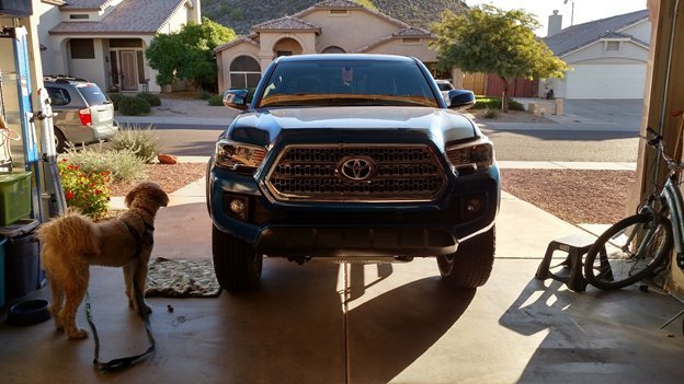

    Before…Yes, Oliver helped.

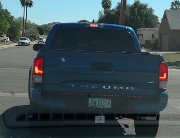

    Below is my write up for installing RAMPAGE PRODUCTS APC LED TAIL-LIGHT W BACK UP on my 2017 Off-Road.
    Just too wet you whistle…this is what it looks like in action. I guess you kind of can see it...

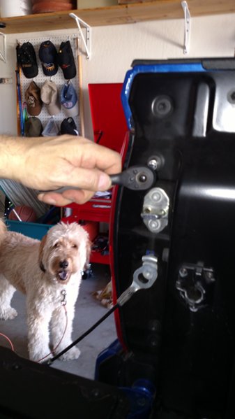

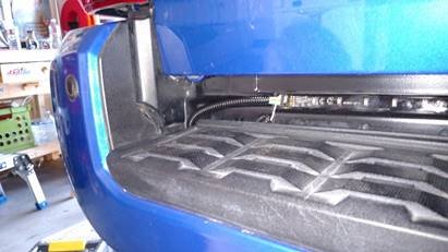

    1. Measure out the bar on the brace between the tailgate and the bumper to align the LED bar. I used some masking tape to temp fit the bar for fit between the space to make sure it was visible. After getting the look I wanted, I marked the ends with masking tape. I made sure the wire harness was on the driver side. If not the L and R will be swapped.
    2. I cleaned the attachment area with alcohol and pulled the strip off the 3M tape on the bar and lightly placed it on the brace. Once I had the right spot I pressed it on tight.
    3 .The next step was to remove the drivers tail light by removing the second bolt from the
    top and the bottom bolt. Oliver is my puppers helper.

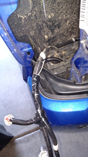

    4. After removing the housing, I found the reverse light and traced the wires into a wire tube conduit. I rang out the power line with my multi-meter. Then took a swig of my frosty beverage. My first cut in the factory wires. (Shit). I cut the wire and spliced the white wire from the LED bar and covered the splice with electrical tape then re-wrapped the wires with the factory wire tubing. I ran a separate wire tube to the Led bar for the single backup wire. I taped the whole thing up with electrical tape. The pict shows the white reverse wire and the wire tube before I wrapped them.

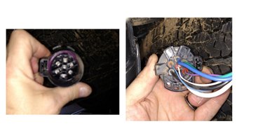

    5. The next step was to attach the LED Bars 4 pin wire harness to my 4 pin plug on by the hitch. I wanted to see how I liked it before I cut more wires. I drove around like this for a week.
    I love it…time to finish the install.
    1. I got on my creeper and looked at the wires that go to my 4 pin & pin plug. The bumper outlet is made by Pollakand connects with a cannon plug. I took a screwdriver to release the plug from the bumper and removed the cannon plug from the outlet.
    2. The cannon plug pin setting is as below. The 4 pin harness has 4 wires---L Turn—R Turn--Brake—Ground. I found a wire diagram on line from the Pollak company and traced the pins. Then I had my 15 yr old son do the turn signals and brake as I verified the signal with my Multi-meter.
    3. I removed the factory conduit from the wire harness and stagger spliced in the wires as follows:
