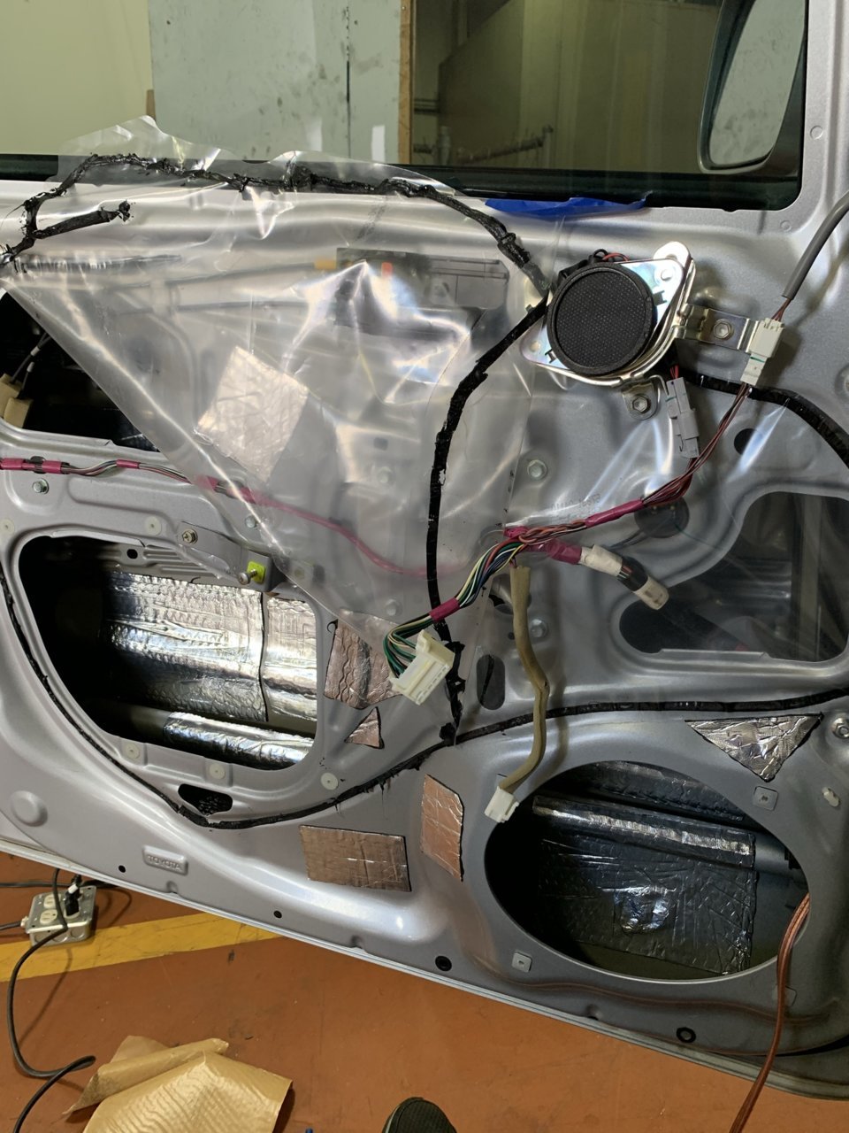

    You are right about that. I’m currently running my Kenwood on the stock speakers but I deadened The doors and it made a world of difference

    if you got time, the door cards are easy enough to remove and replace and you'd get better at r/r the door card doing it mult times, lol. You could try to sound dead'n the inner door skins to start off with and go on from there. I believe I used 16sq/ft(<$100) to cover the inner door skin. Pretty sure that was at least 50% coverage, if not more and having a little left over pieces. Can't tell you how good that sounded only with the inner door done as I covered my outer door skin between the door skin and door card at the same time, it REally brought out the mid bass in my doors. I decide to replace the JL C1 6x9 front door woofer after the fact with better 6.5" woofers, looking for more mid bass detail, as I have a subwoofer to cover the lows. Everyone has their opinion of the sound they want or to their satisfaction having a limited budget or not.

    I've heard sound deadening should be applied to the inner frame of the door and I see yours is the outer or inside the frame. I know you can, and probably should do that as well, but I thought the whole point in adding dynamat is to not only eliminate vibrations and echos but also to create a makeshift speaker box like subs go in. To do that you should cover the holes in the inner door where the vapor barrier is that's normally there to access the inside for repairs and place a small sheet directly behind where the speaker sits. This creates a chamber for your door speakers making them sound their best. If you know different let me know cause I planned on deadening my door panels this weekend.

    You’ll never make a “speaker box” out of your door chamber because it’s entirely too leaky, and any “port” functionality simply isn’t there because all of the openings are two dimensional (window slat, weep holes).
    This is what pods do, not doors. Car stereo speakers are designed with this in mind so there’s no benefit in covering and sealing all of the holes unless you are addressing a specific issue like ringing or flapping the vapor barrier.
    I did it both ways in my Tacoma and the real benefit comes from reducing vibrations and making sure you have a solid mount solution that places the speaker at the proper depth in relation to the door card.

    I also have mine on the outside skin covering the big open areas you cant see. I didnt want to do a full bake potato of the door. There are 2 big sheets covering the top area that you cant see in the pic as well as more running along the middle and bottom. It has made a huge difference in sound for the amount of time and money invested. I used Noico on all 4 doors and im happy with the outcome of it for deadening. When i replace my components up front, i will do the inner door card in places as well to add some more stiffness to it.
