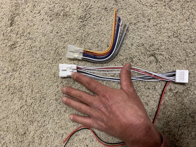

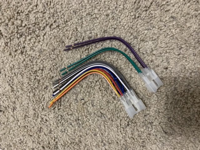

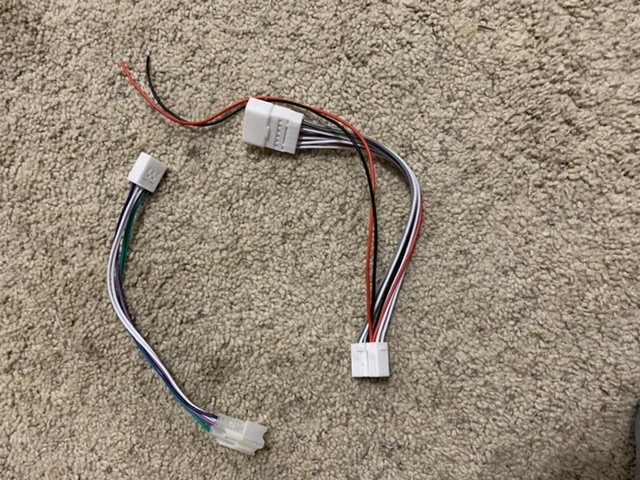

    61D0E215-E497-4503-88E3-3561F1FDBBBF.jpg D8DD5FB4-F6DC-4BAF-BCED-401D7FC90FE7.jpg So these are the harnesses that came for my setup y’all.. it is different than the ones I’m seeing pics on for this install but the connectors look identical. Just different wire colors. @destin_meeks can I make this work? The top harness is actually connected together already.. do I just cut it at the center of the wires?

    Do the top picture harnesses match up with the bottom picture?

    They will connect. They have the same number of wires but they’re colored differently than the bottom. They’re both 10pin connectors. I’ll take better pics do you can see. They’re a little different but connectors are exact same

    Ok. They’re not what is normally used, but we can make them work.
    the top set is basically just an extension. We will need to cut some of the wires, but that’s ok. We won’t need the bottom set anymore though, because the top set has the male AND female connectors on it (that’s the whole reason we buy the 2 Metra sets, to get male and female)
    You will need to use the lower set to see what standard wire colors are. The top set isn’t standard colors for some reason.

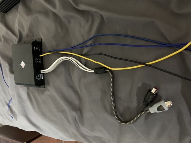

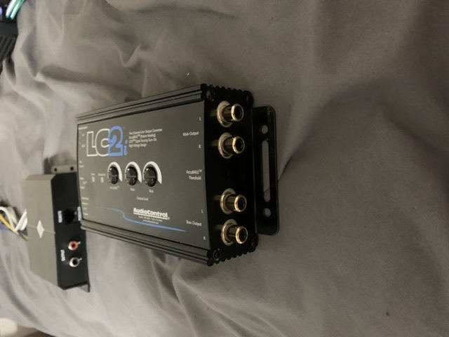

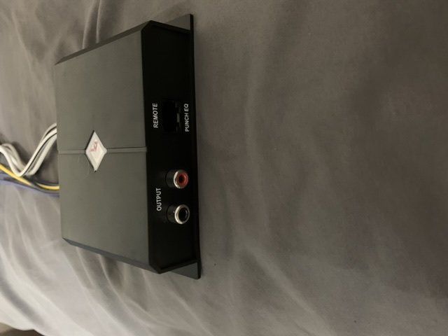

    I’m installing an lci 2 loc hopefully with my powered subwoofer and a Rockford Fosgate 2 channel loc into my two front speakers. I’m also installing the kicker key for all 4 door speakers

    Both active loc’s I also have a passive loc laying around I was considering running to my rears if not too complicated

    Why do you have 2 LOC’s? You don’t even need 1 in this setup.
    The Key is made to take high-level inputs, and the powered sub is also made to take high-level.

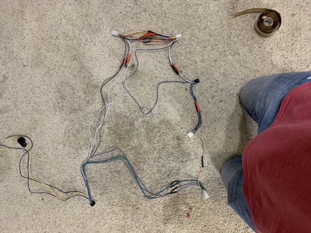

    2EC1CA75-E5AE-4E50-A2D8-388F0F1F3A5B.jpg Finally got it all figured out. soldered and heat shrink. @destin_meeks does this look right? What is the next step? I’m having trouble figuring out how to run my positive negative wires into the 8 gauge amp kit pos neg wire I bought from stinger. I matched all colors and pulled the orange black from an extra harness I had instead of cutting the blues. I tied the blues all together and soldered them. It may be hard to tell with this pic bc I used red and black heat shrink to do this and ran out of red toward the end and just finished using black. Also I took the kicker key back yesterday and exchanged it for the alpine power pack 445u. Practically identical wiring I believe
