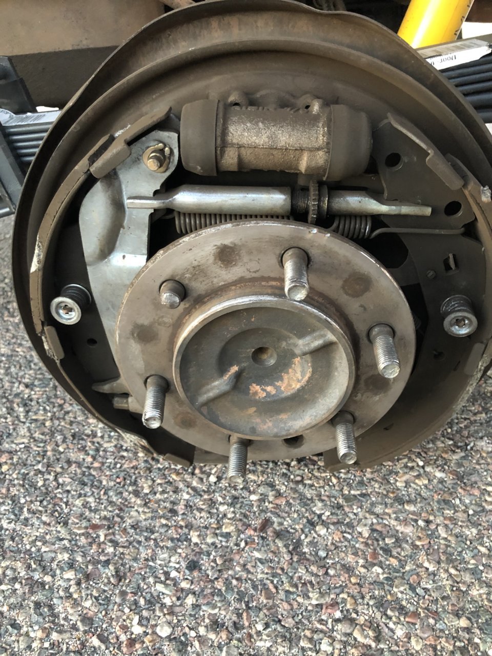

    I just didn’t expect it to literally happen while driving on the freeway!

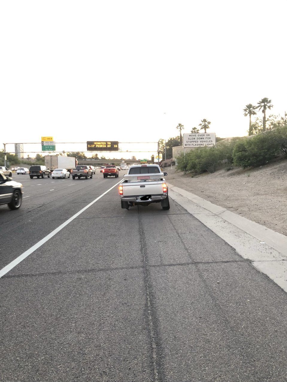

    We’re okay and safe. I made it to the side of the freeway and was able to slow down a lot before the back end hit the ground and we came grinding to a halt. Then we watched as my wheel rolled off into the sunset.
    On inspection, it looks like only one of the lug nuts was tightened down, the rest were loose. The one tightened one snapped off, and the other five went flying across the freeway.

    Amazingly I was able to recover the wheel. It was about half a mile down the highway on my side. It must have been guided by hitting a few cars.

    I had to recover the drum, it fell off shortly after the wheel. Also didn't want to mess with it and cause more damage.
