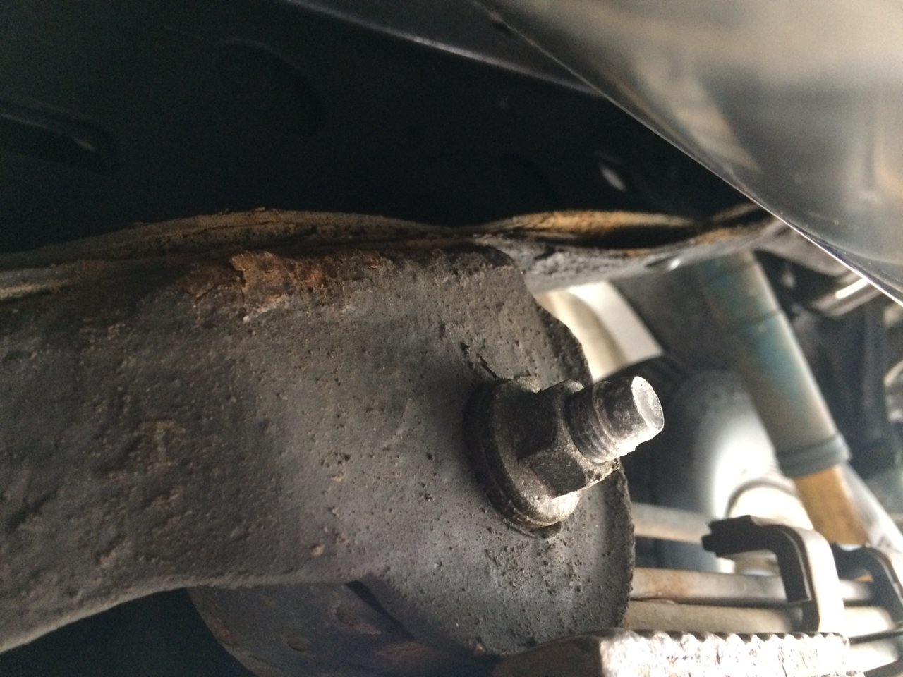

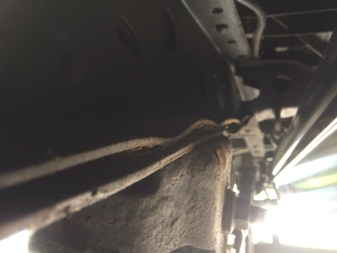

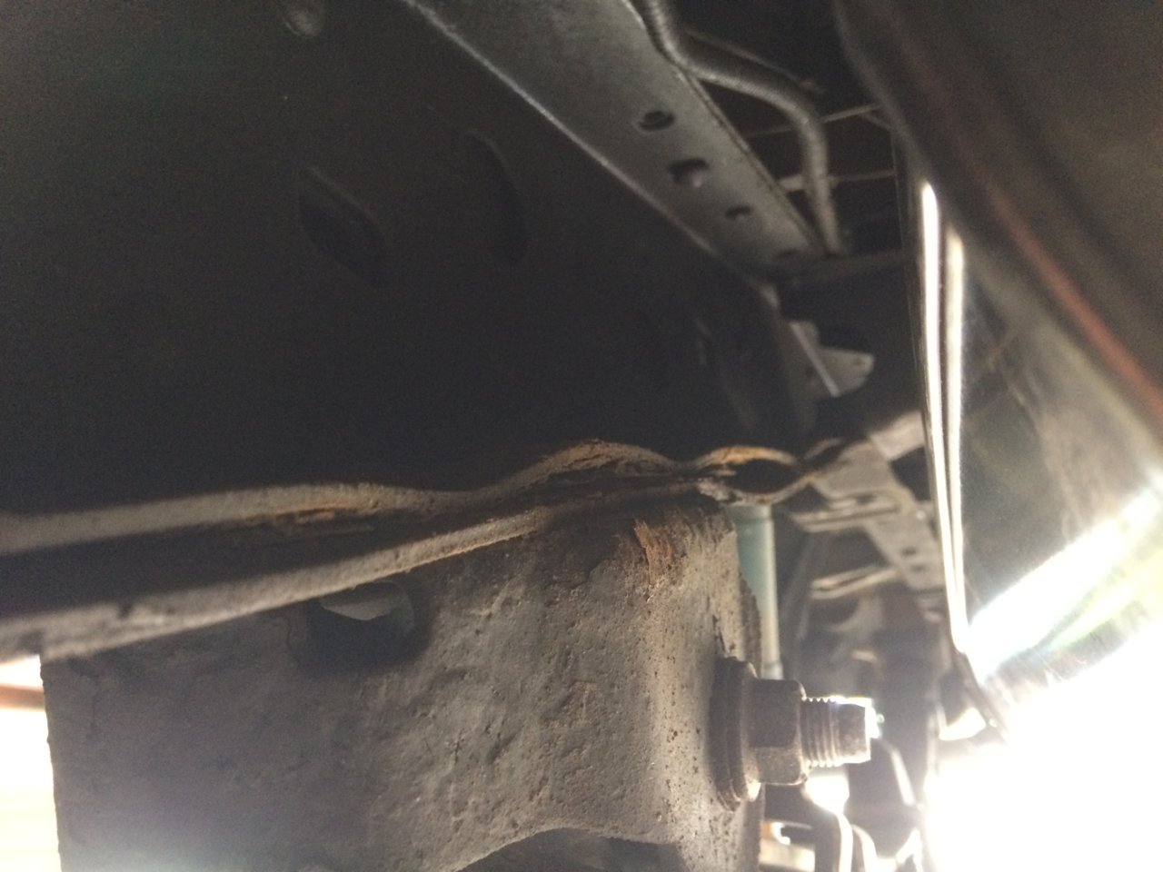

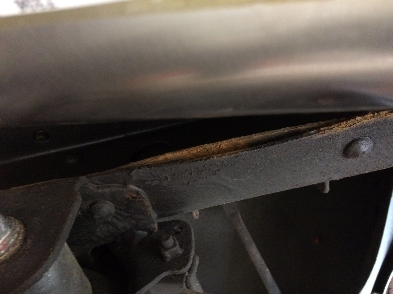

    I have a 2006 Tacoma 6 cylinder trd off road. I live in upstate NY and drive it all the time in the winter so it gets salt underneath. I noticed there is a section of my frame coming apart, I am guessing due to rust. Toyota said it is common and not to worry. I am just looking for anyone else with this problem and any advice. Will it get much worse and should I be concerned. The rest of the frame looks pretty good just a little surface rust. Thank you for any feedback!IMG_1311.jpg IMG_1308.jpg IMG_1317.jpg IMG_1318.jpg

    I’d worry and keep on it

    Look for holes to

    Common for tacomas, they all pretty much do it id wire wheel it and por 15 it then not worry much about it anymore

    Look closer, especially near the cab mount just aft of the front wheels. Check the inboard side of the frame next to the catalytic converters. That area tends to develop rust holes first.

    Isn’t your truck included in the frame rust recall?

    Start whacking the frame in various spots with a ball peen hammer and see if you make any holes. If you do, then worry. If no, carry on.

    What do you mean they said not to worry? The truck was inspected at a dealership? If so, I would keep documentation that they inspected it and found it to be OK, because once the deadline for the recall passes you’re out of luck.

    If mine looked like that it drive me nuts:eek:. I would want to try to clean it up cause it will only get worse especially where you drive:frusty:

    My frame was replaced because of this.It makes the frame weak and unsafe.

    The problem is that where the frame is separating there is debris collecting. The debris will hold moisture and accelerate the corrosion problems.
