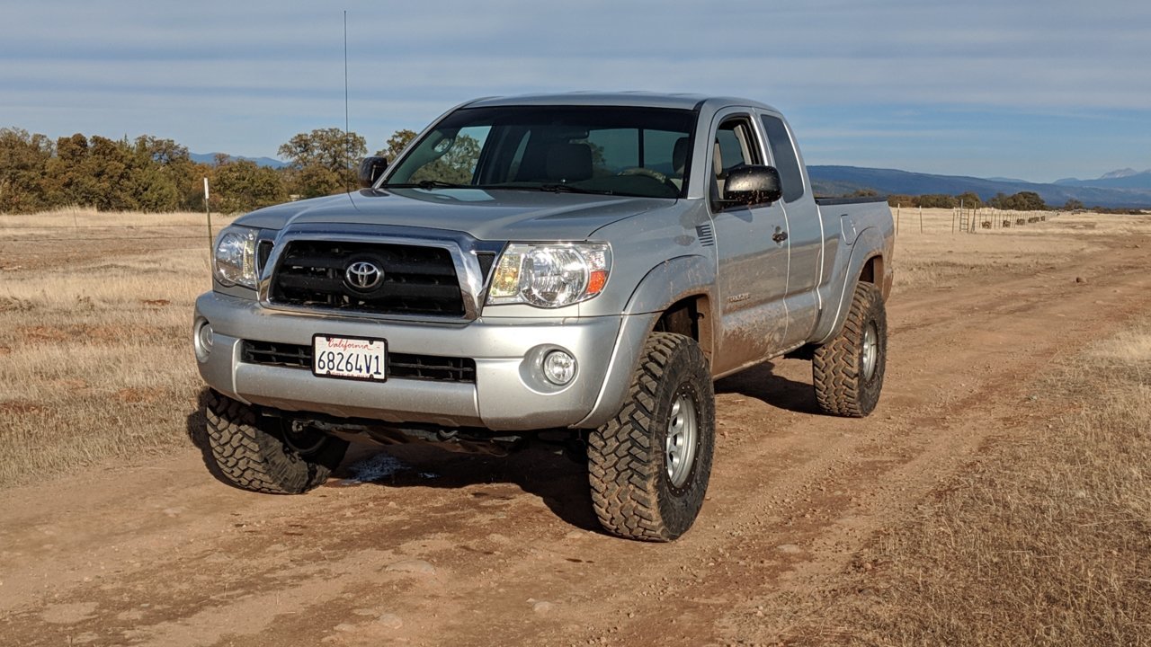

    IMG_20181125_143142.jpg Here is what mine looks like with Bilstein 5100s set at 1.75 in front (3rd setting) and zero lift in the rear. It's all stock in back. I have 285/70R16 tires (32" tall × 11.5" wide)
