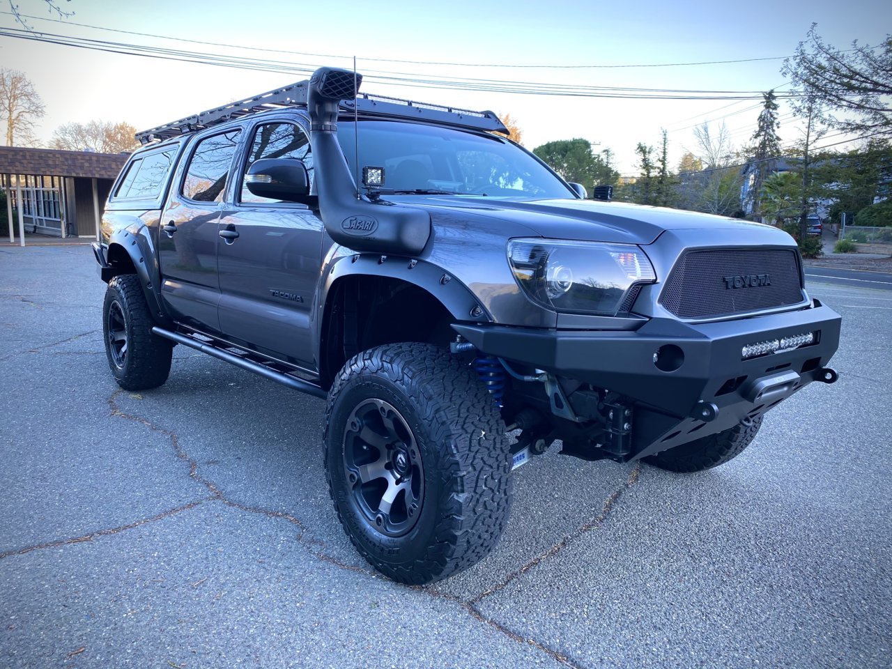

    A visual anthology of my build, Bruticus. Bruitcus will be mainly used for overland adventures with the family, hauling stuff for home improvement projects, and maybe moving a bike. Don't think I want to go rock crawling but I want the option to upgrade in the future if things change. A lot of inspiration and knowledge has come form folks here on TW. Thanks everyone for inspiring me.
    2015 Tacoma DCSB TRD Off-road 4.0 V6 MGM
    How he sits today. Unfortunately, I forgot to take a pic of it the day I brought it home. Started modding it the next day. :p
