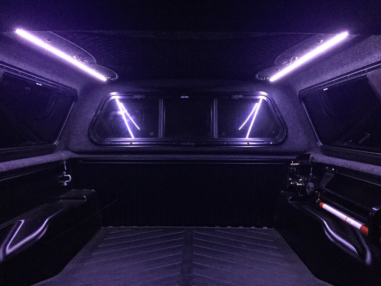

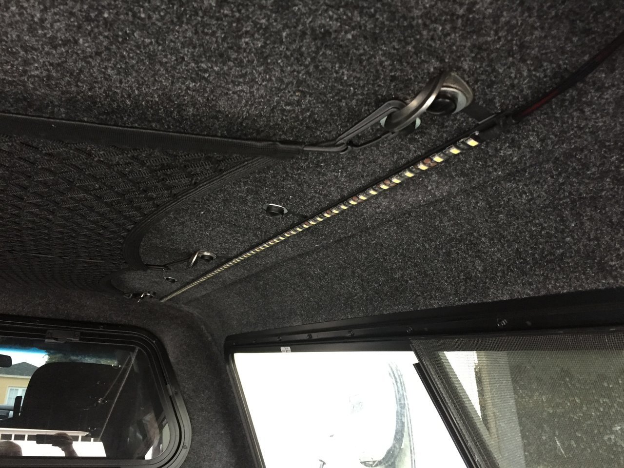

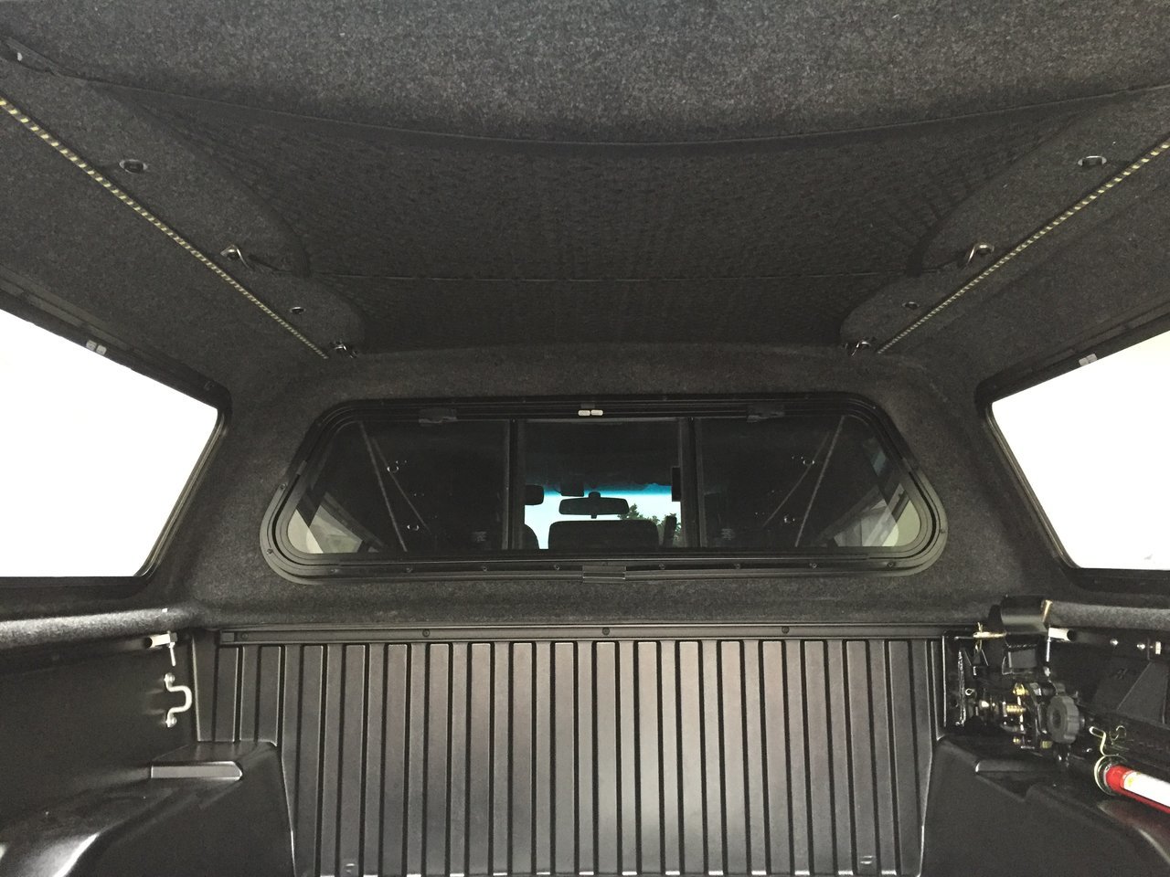

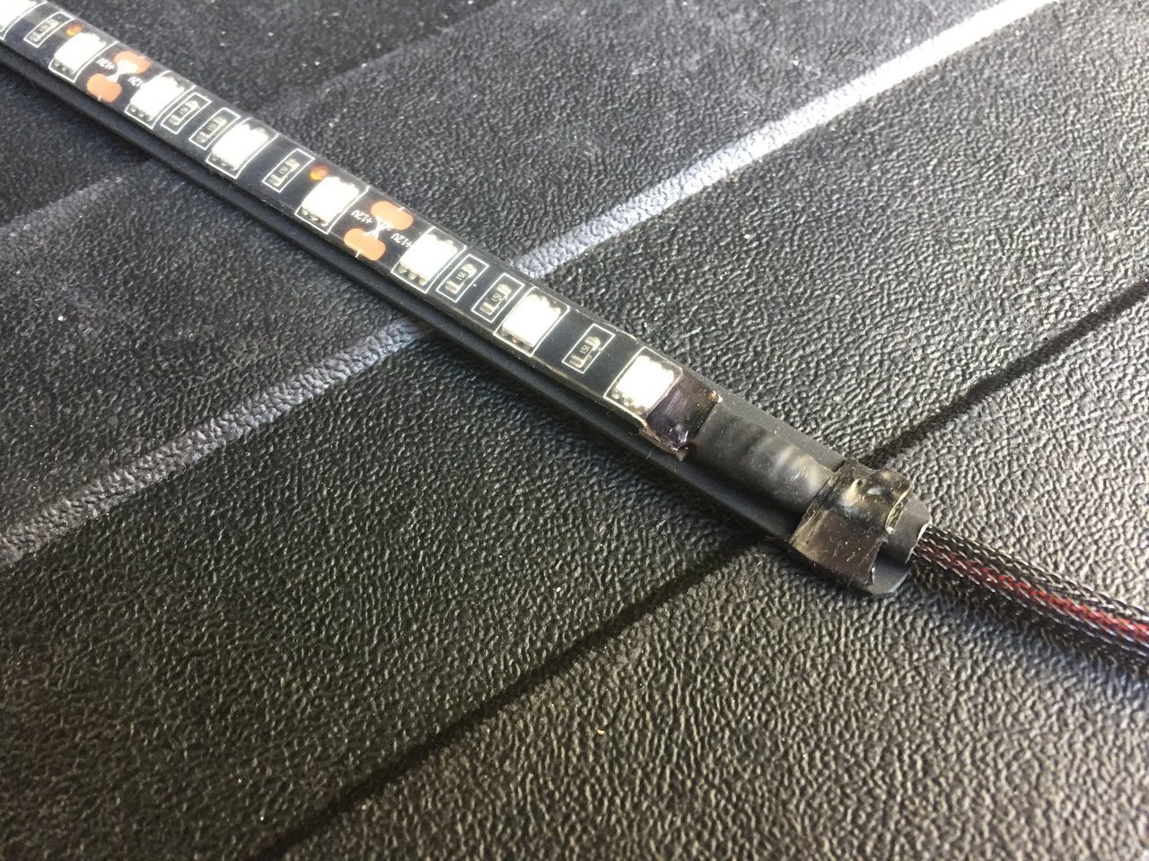

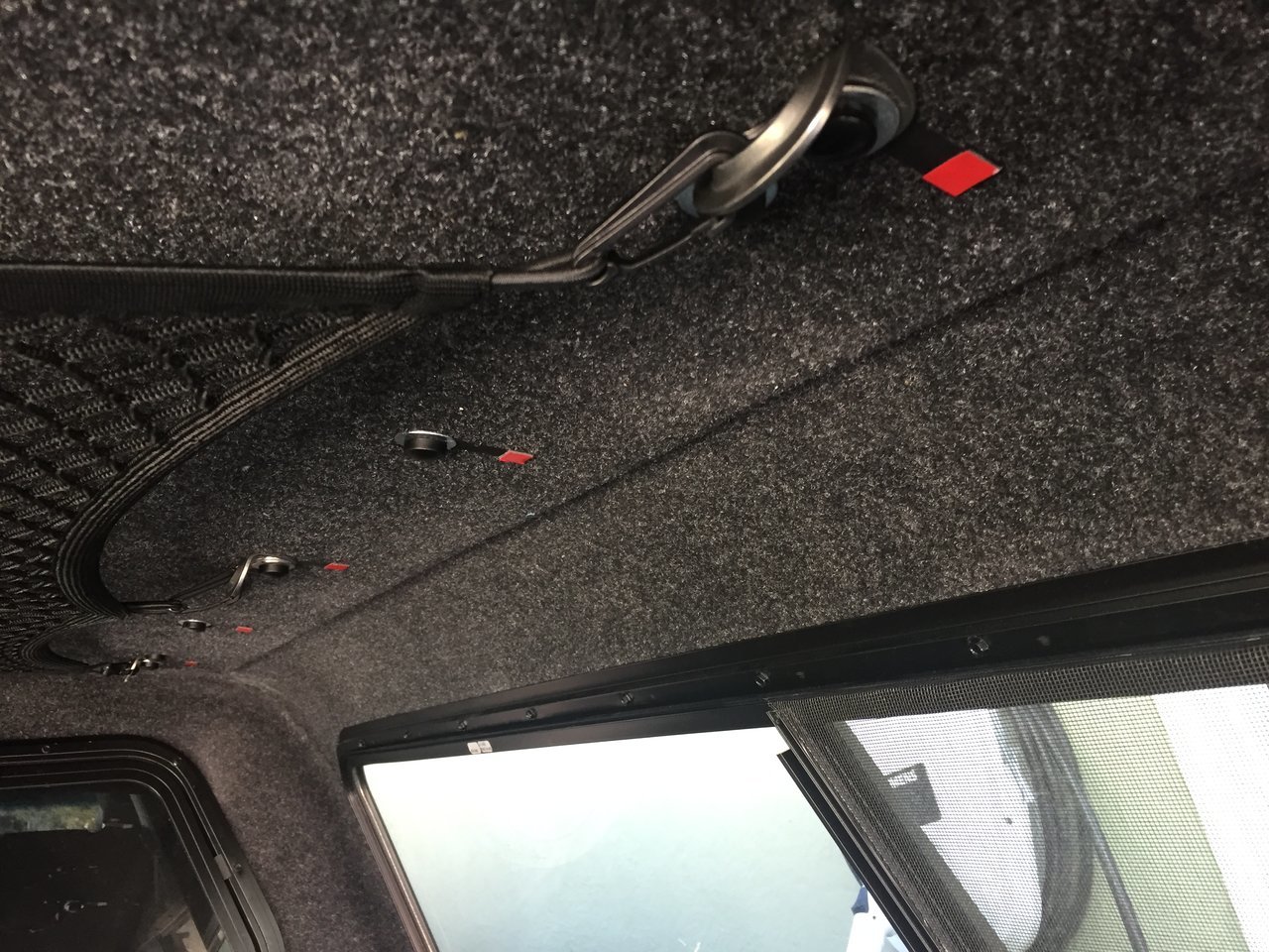

    Ok, had to redo the bed lights. The drawback in the placement under the rails and running the wire prevented me from installing the Hi-lift mount. Basically, I couldn't get anything into the rails. Also, the light output wasn't that great being that low in the bed. So here is the new version.
    Decided to mount the lights to the roof of the camper. I wanted something solid up there so velcro was not an option for me. I made some brackets out of aluminum and mounted them to the underside of the Thule rack bolts. Then use some body molding tape to mount the lights to the brackets. Light output is better but not a fan of the purplish light color from these new LED lights (maybe I will change them out later). I went with these "black" LED strips cause I wanted to blend the lights more into the surrounding carpet. They are hooked up to my Spod so they can be controlled via Bluetooth.

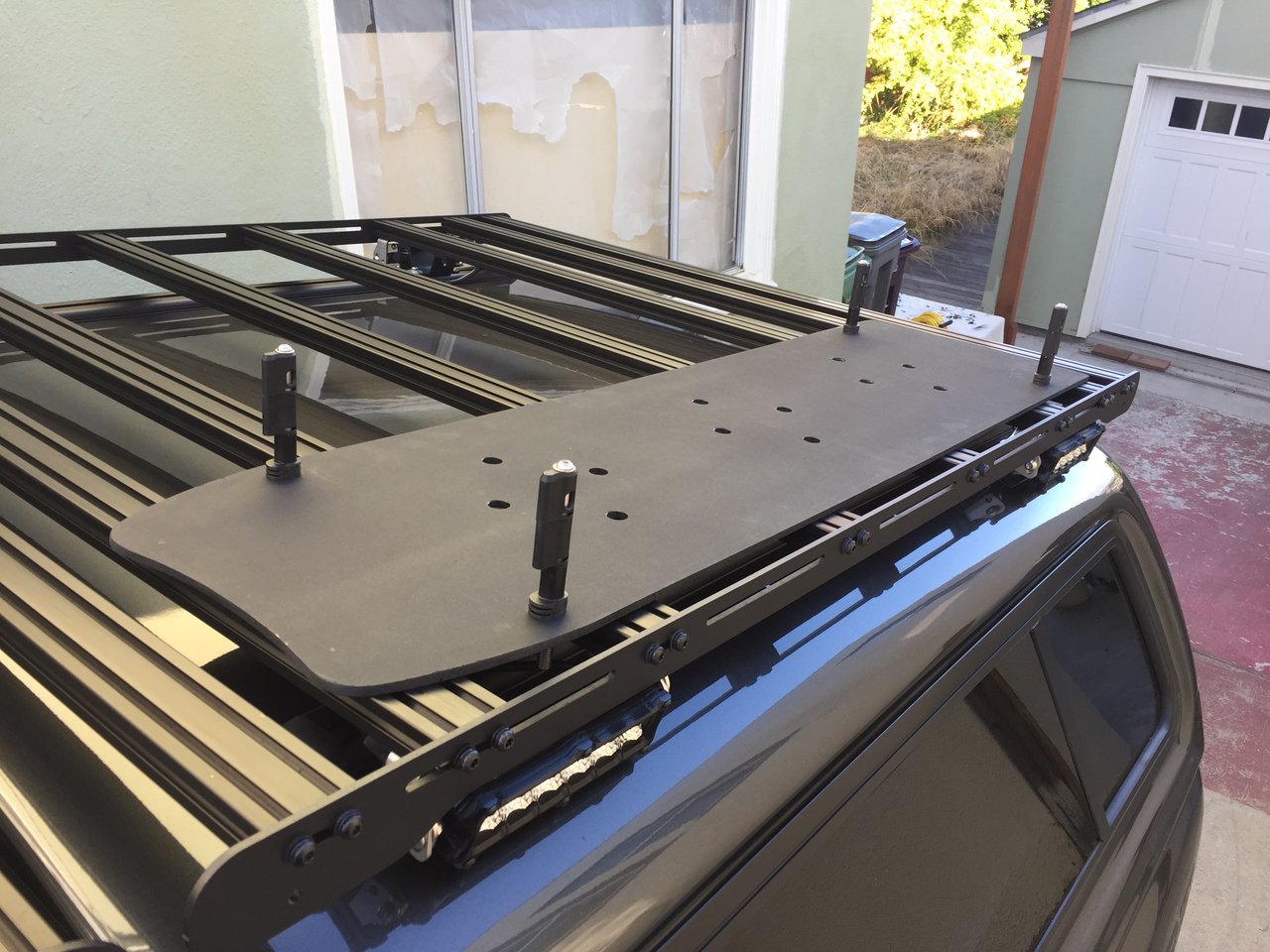

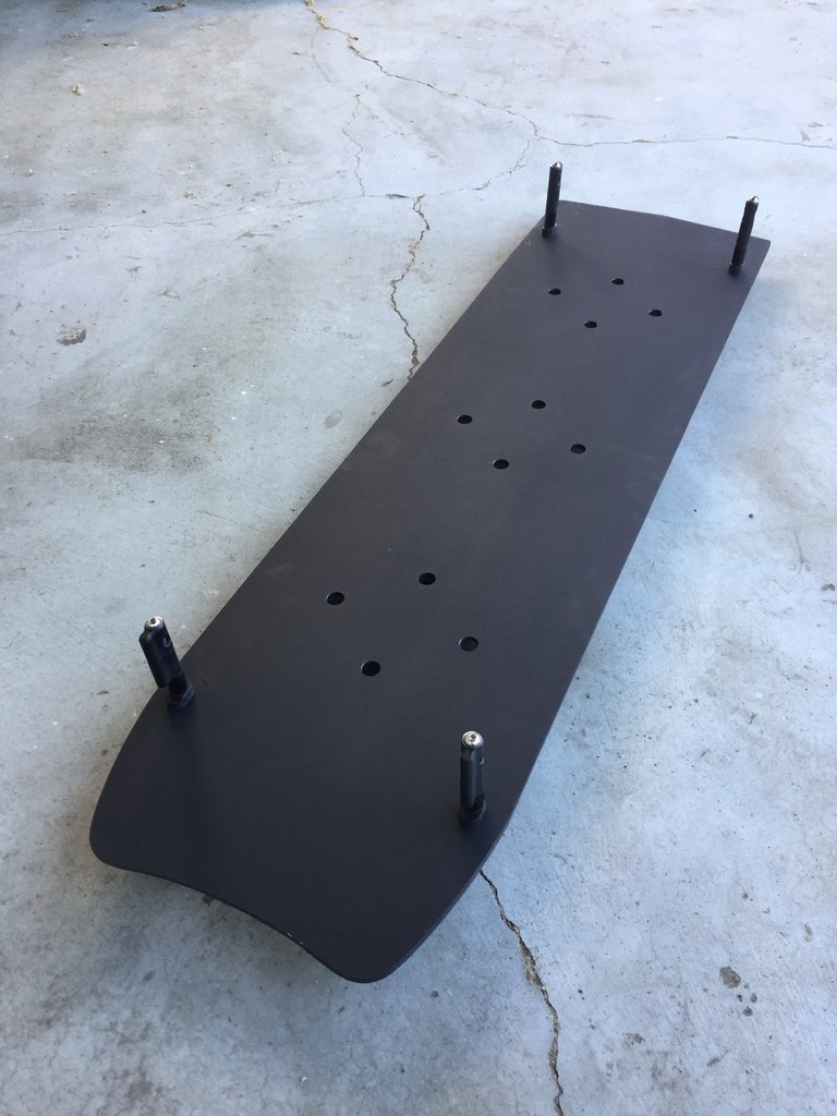

    What is that board? Starboard?
  6. Aug 12, 2017 at 7:33 PM
    #186
    alvinfromhawaii
    alvinfromhawaii [OP] Well-Known Member
    Mar 23, 2015
    #151598
    605
    Northern California
    2015 MGM Tacoma DCSB V6 TRD Offroad
    Supercharged, Magnaflow, Volant,
    I got it from TAPs Plastic. it comes in a variety of colors, thickness, and finishes. They will cut to size for you or shape it (for a fee). If you have a Jig saw and a sander it is pretty easy to cut it yourself.
    From Google:
    "King Starboard is an extremely popular marine grade polymer (plastic) material used for fabricating hatches, doors, rails, handles, cup holders, fishing rod holders, counters, chairs, tables, frames and other boat trim.Starboard does not rot, swell, splinter or delaminate when exposed to humidity or water."
    Bentrodder[QUOTED] likes this.
  7. Aug 12, 2017 at 7:35 PM
    #187
    HIghlande2
    HIghlande2 Well-Known Member
    Apr 20, 2017
    #216802
    1,628
    Wilmington, NC
    15 DCSB Sport
    Little of this and a little of that

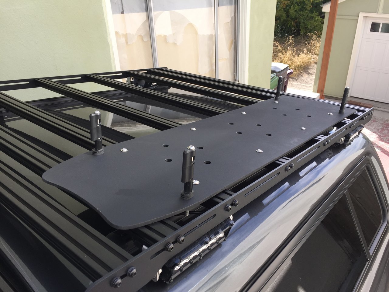

    How did mount the starboard to the rack?

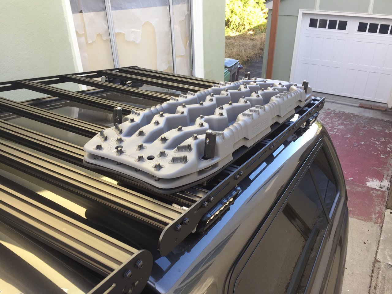

    Here it is mounted.
    sawjai526 and HIghlande2[QUOTED] like this.

    That came out awesome! Looks clean like a factory job.

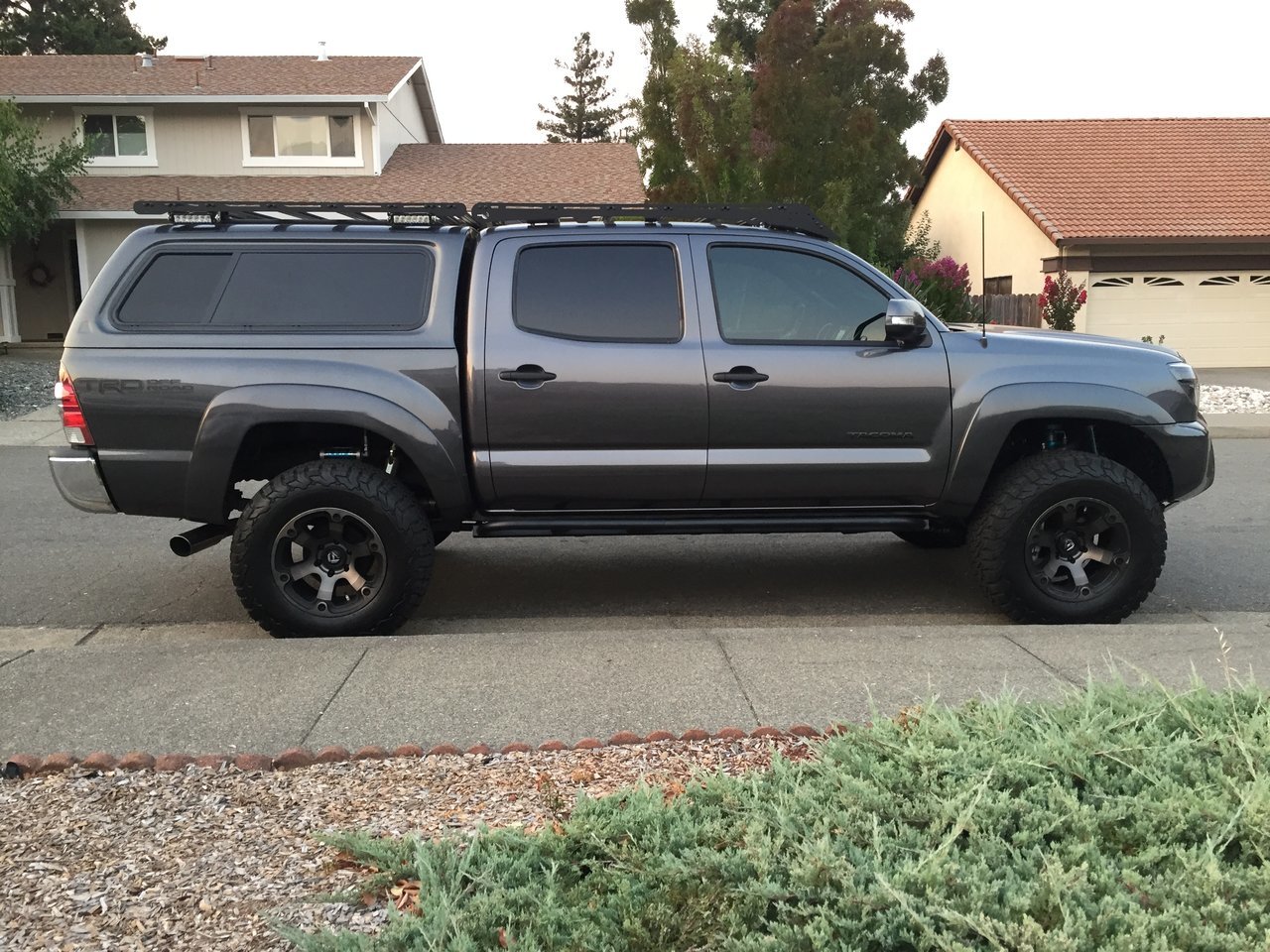

    So much better looking and would be thieves can't see what is being carried in the camper.

    Who did your tints? How much you pay

    Professional Film installations in Oakland did it. Was one of the few shops that would tint a shell. He had to make a custom template for the tint. Came out to $250, took about 4 hours.

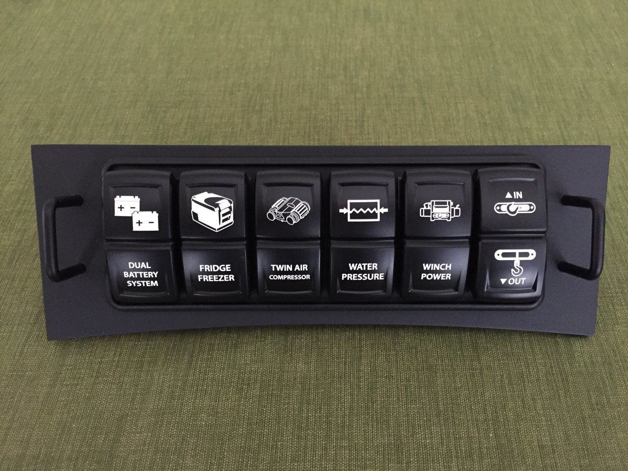

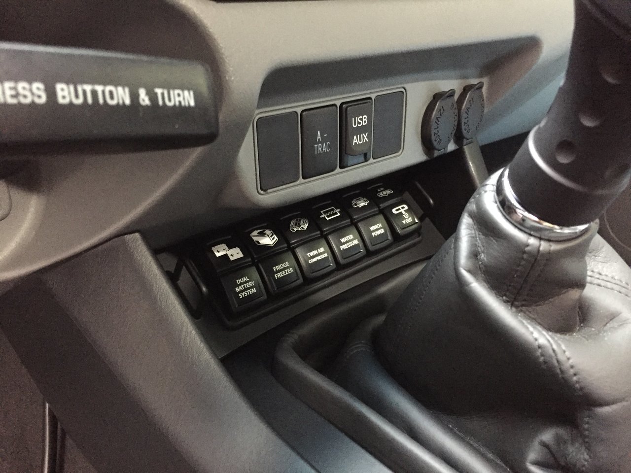

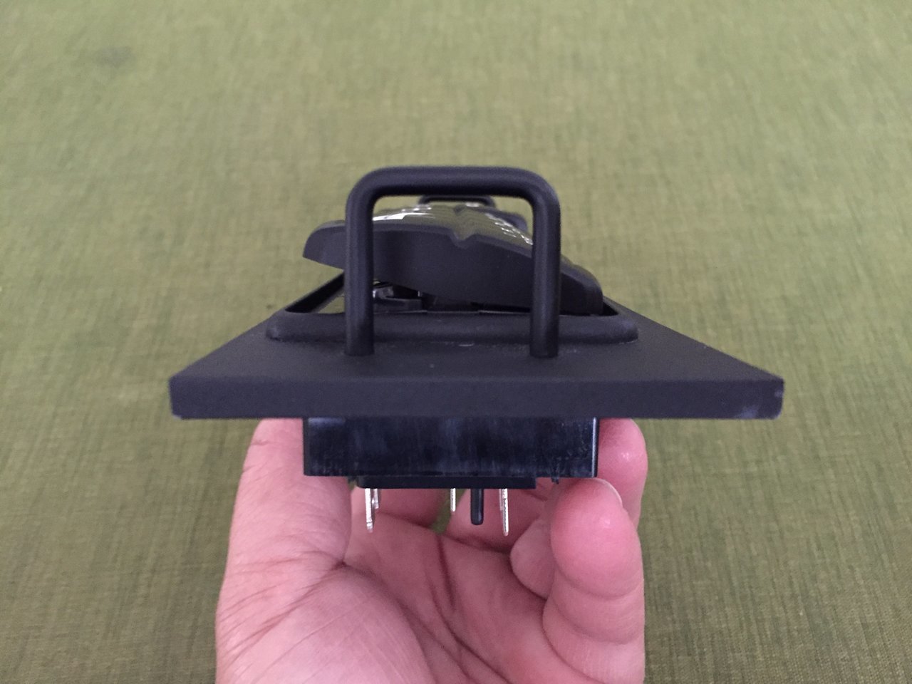

    CH4x4 switches
    Now I just need to wire them up.

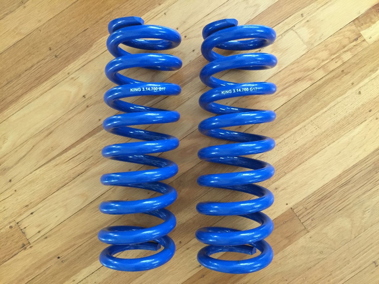

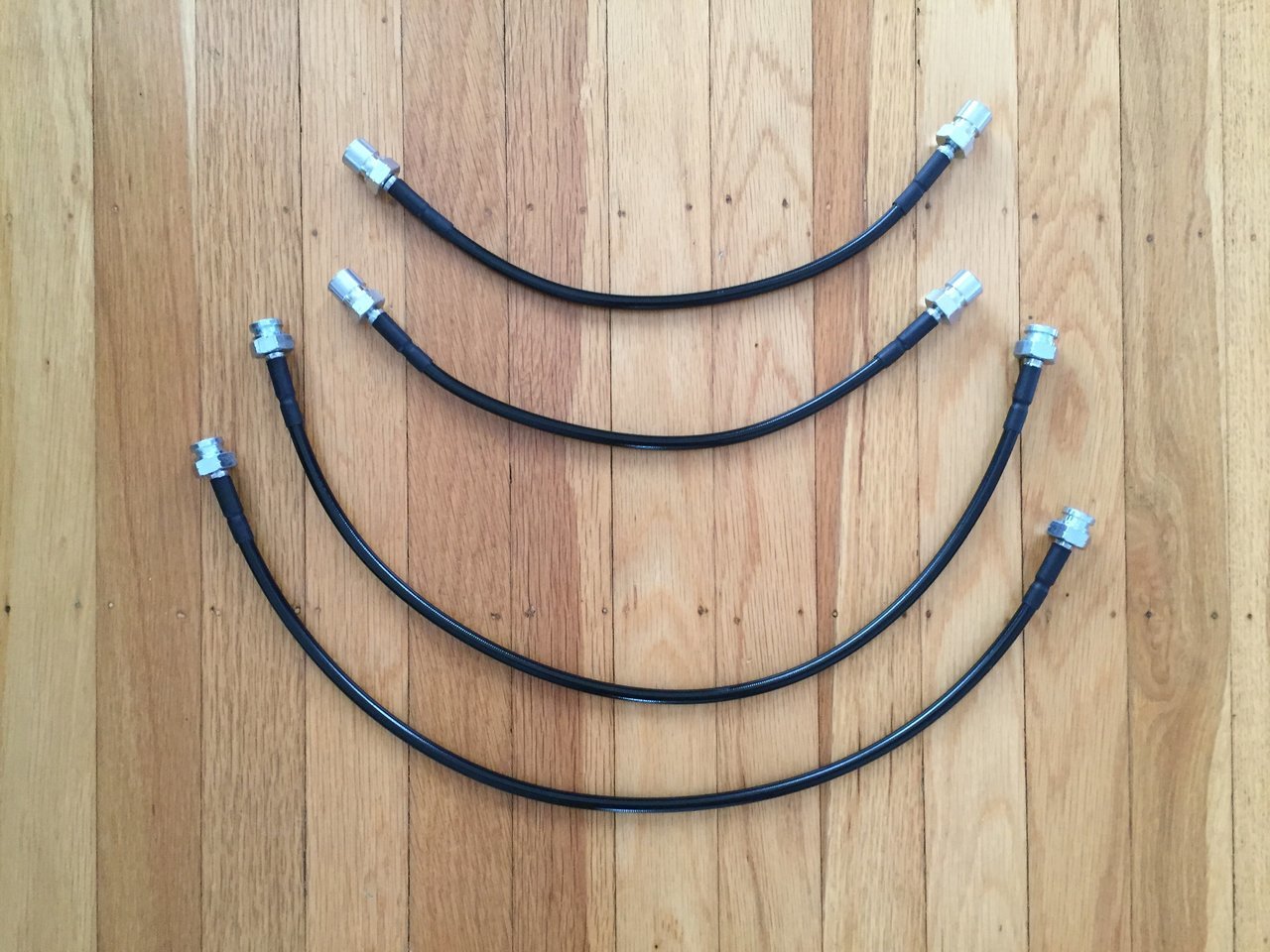

    Got some goodies today for my next stage of a suspension upgrade.
    700lb springs
    Braided brake lines extended 2 inches
    nudavinci64 and HIghlande2 like this.

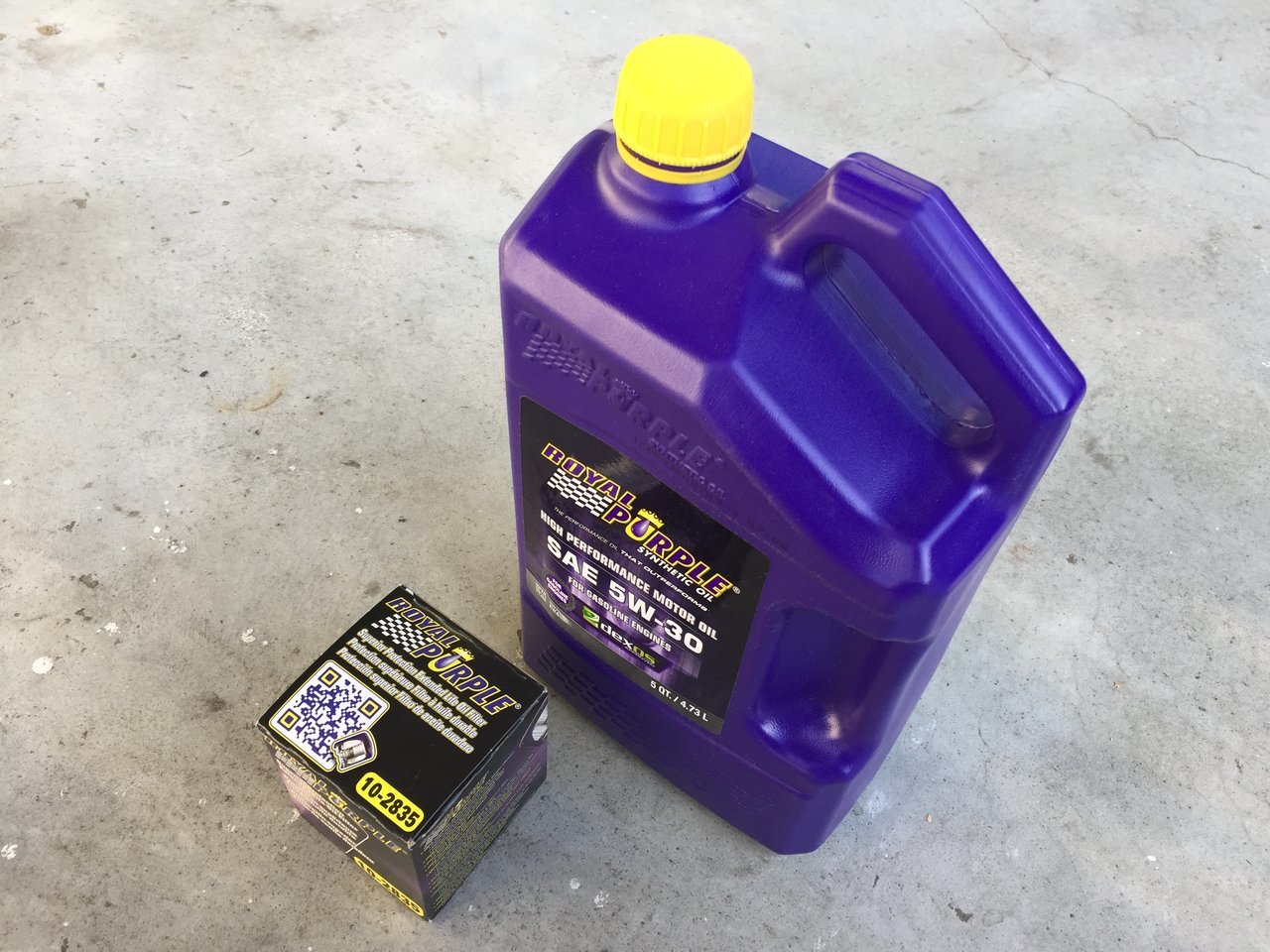

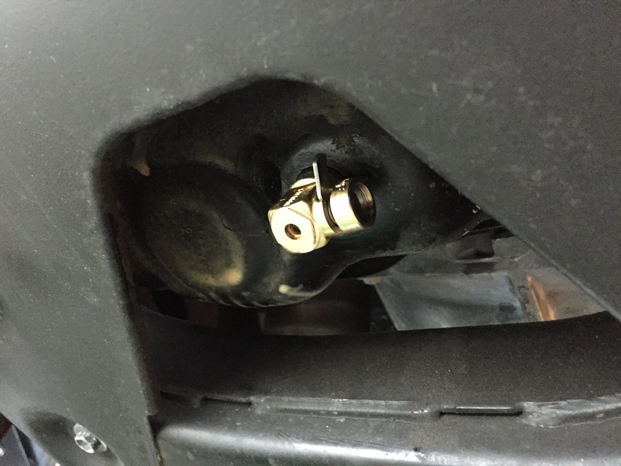

    I tried using an extractor to get the oil out but it left about 1 liter of oil in the pan still so I decided to Install the Fumoto F-103 valve. Unfortunately, I bought the non-flush version so had to alter it a bit. Cut off the extra spout and sanded it down smooth. Looks almost like the correct one I was supposed to buy. :) Changed to Royal Purple as well.
