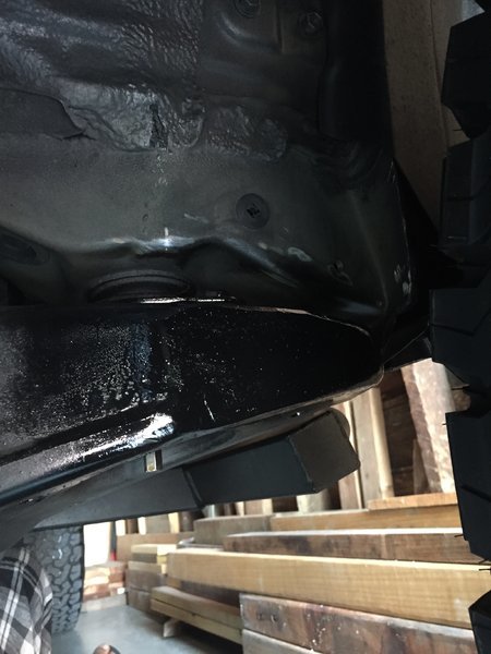

    CMC done! I'm gonna have to blast it with a bit of flat black to match better. :)

    What exactly is the CMC mod?

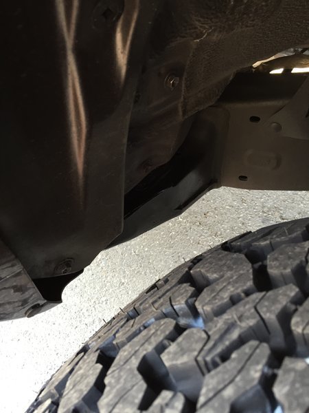

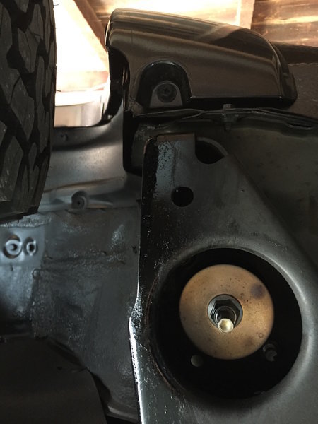

    CMC = Cab Mount Chop, also known as a body mount chop.
    When putting on larger tires (33"), most of the time they rub on the body mounts, so you need to chop off a little for clearance. This will most likely occur in full turn under shock compression.
    Unfortunately, I do not know how to weld so I took it to 4 Wheel Parts to have it done. They did a pretty good job, better than what I could do for sure, looks OEM. Cost me about $250.

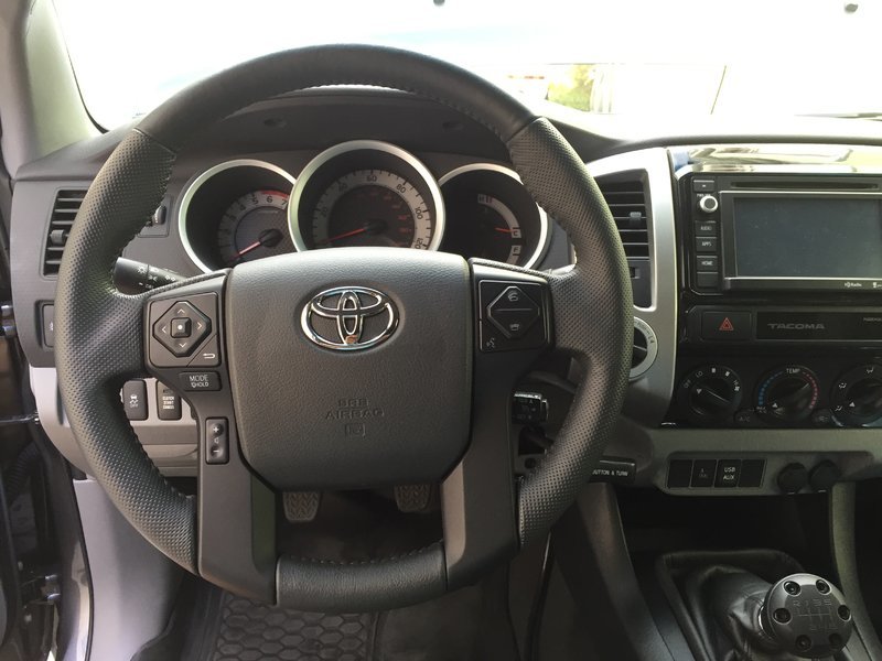

    Blacking out the interior (maybe)
    Swapped out the steering wheel control. Part no. 84250-04040-C0
    Got a great deal from @Titus_Will_Toyota on this group buy thread https://www.tacomaworld.com/threads...blackout-interior-parts.449999/#post-13184365

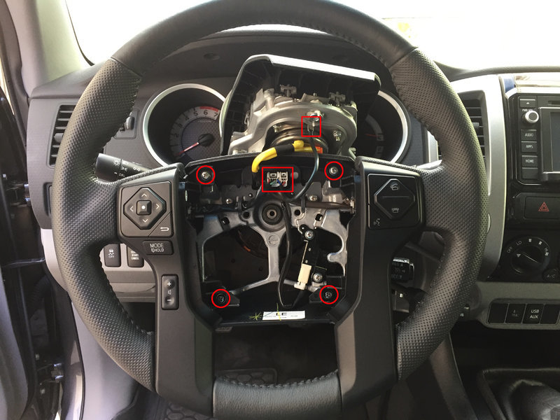

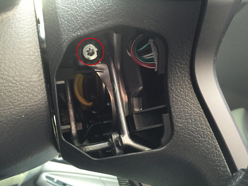

    Pretty easy install.
    1.
    Disconnect negative battery terminal in engine bay (don't want that air bag deploying) :)
    2. Pop off side panels and loosen Torx star-shaped screws on left and right side of steering wheel.
    3. Pull out Airbag, place on top of steering column, no need to disconnect.
    4. Remove screws holding controls (2 on each side), disconnect the 2 plugs and 1 wire that is plugged into steering wheel, remove controls (pull controls straight out, it is being held by pins)
    5. Install new controls in reverse order, DONE!
    Now to decide if I want to:
    • Paint all the silver trim to black
    • Paint steering wheel and gauge rings in black, center unit in MGM or Silver
    • Paint all as MGM
    • Leave remaining trim as
    At least now with the black steering controls I can paint it a different color and have the volume control black instead of silver.
    Here is what it would look like if I went all black:
