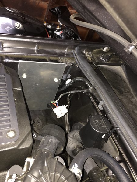

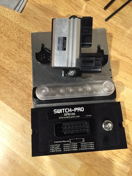

    Testing out a new mounting bracket for my Switchpro.

    Checking placement.

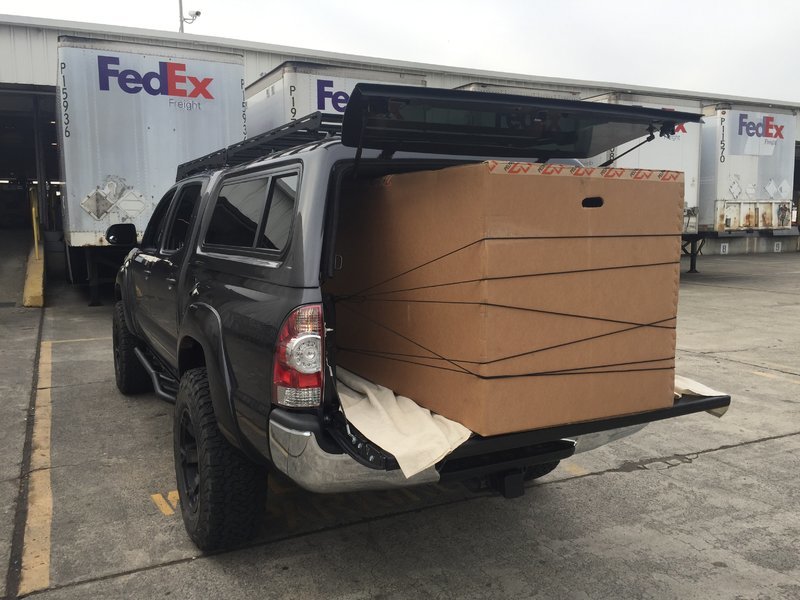

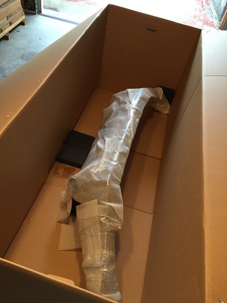

    Picked up something special for Bruticus. I pretty sure that paracord is strong enough to hold that box... I hope. @Bentrodder bed support loops came in real handy today.

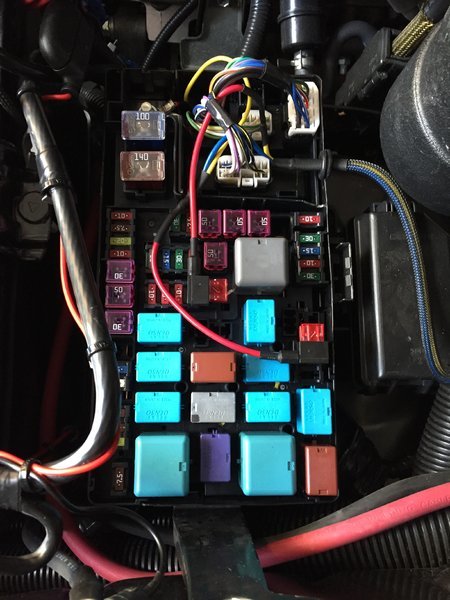

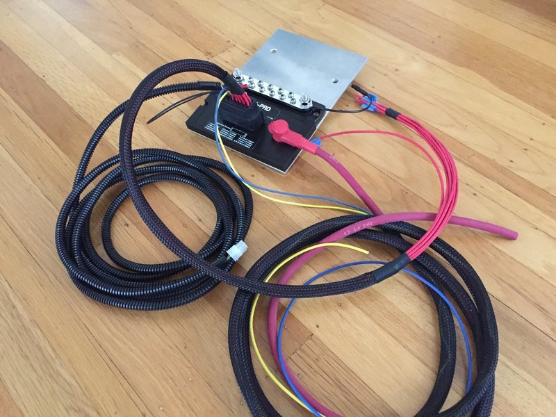

    All wired up and ready to install.

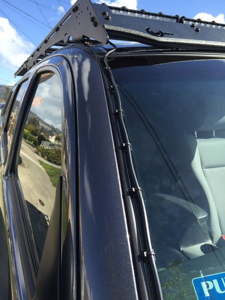

    Here is what I did for securing the roof lightbar wire to my windshield. Used these cable mounts https://smile.amazon.com/gp/product/B00FH6HYWO/ref=oh_aui_search_detailpage?ie=UTF8&psc=1, replaced the adhesive with https://smile.amazon.com/gp/product/B002JOVUO0/ref=oh_aui_search_detailpage?ie=UTF8&psc=1
    The reason being is that I didn't want to block the channel where the water drains or gunk up with silicone adhesive. Plus this method is removable

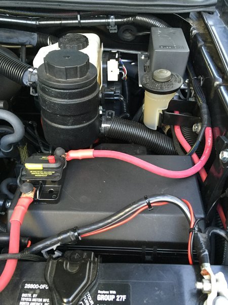

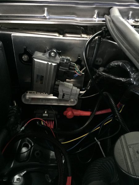

    Installation pictures of the Switchpro.
    Switchpro
    Bluesea 100amp fuse
