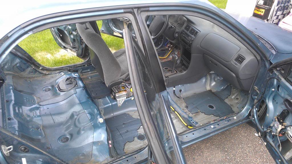

    I will be moving the ecu and fuse box wiring to the to inside of the car in a few days when the windshield comes out. I plan to kinda just flop the wire loom over the dash board and zip tie it there.

    I still have to set up the battery and boat gas tank inside the cab. I am also going to bolt on a Jeep Cherokee bumper to front (rules say bumper swaps allowed of "Like Era")

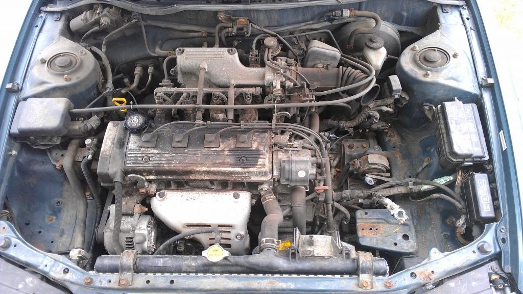

    after taking close look at the Corolla , one thing that makes me nervous is the the transmission shift fork is in the front of the trans and is only 7 or 8 inches away from contact with (anything that packs in).

    it's really only like 3 inches away from touching the front cross member of the frame. (I'm actually wondering if I should torch a U in the frame)

    I would be worried about a nose shot more than anything. You are right. It is tight in the front end. :ohsnap: . Notching in that area will severely weaken that area. The rad. has no protection so your bumper replacement will be a must. Can you reinforce the bumper ears ???? Like all the way to the firewall ???? Hehehe.
