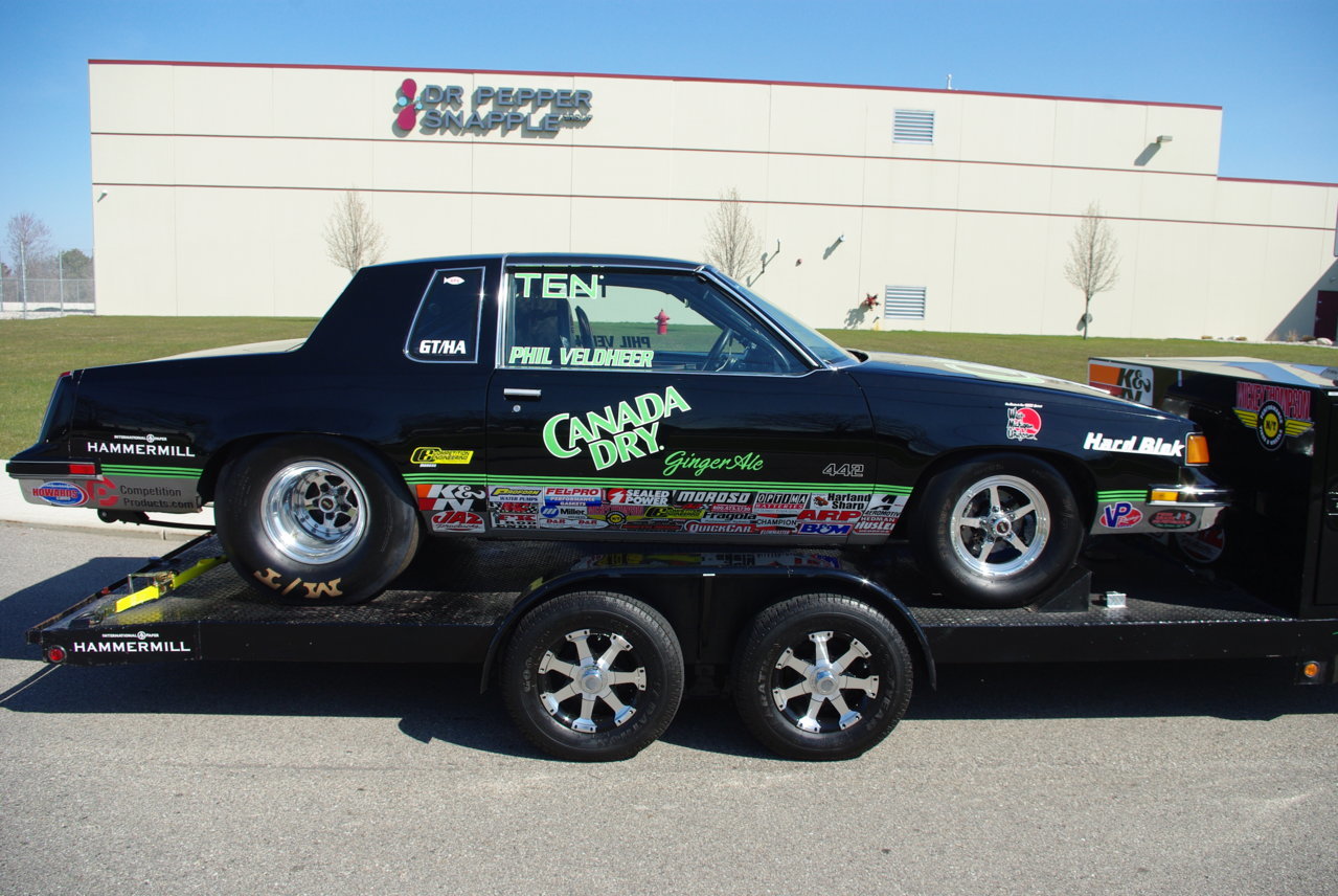

    I am on the verge of ordering a brand new 2022 Tacoma Limited with a 5 foot bed. I will be towing a Ranger bass boat OR one of my race cars on an open trailer....I know the race car weighs 3200 pounds, and I am pretty sure the trailer is under 3200, so I am under the 6400 pound weight limit.... I am sure several people have towed cars on trailers before, but before I order this I want to make sure this Toyota will do it. What does everyone think of the yyblack442-80.jpg LIMITED Toyota? ANYTHING that I should add to the order that is not stock on the LIMITED? Thanks...ordered my 2004 YUKON new and it has only 111,000 miles on it, back and forth to the drag strip...no problems, but just want to change to a new & shorter vehicle. THANKS
