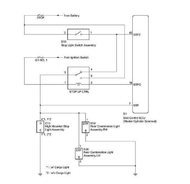

    Sorry for the lack of updates: The truck ran fine for about a day and the problems with the brake override system came back on. It seems to activate when coming to a complete stop such as stop signs and traffic lights. The major problem is the CEL has now came back on and the TRAC OFF light is on also. The light for pressing the gas and brake turns on every time the car is started and requires head lights. However, I can get power by letting off the accelerator and then pressing the gas pedal to the floor. It doesnt make sense at all and now it's snow season. Have not had a chance to get it back to the dealer or talk to the Toyota rep again due to my work schedule. Will call tomorrow.

    at this point its time to wrap it up and go buy another truck, having problems as you described every other day is a no go, ive never in my life have heard of electrical problems as you've described on a new truck or car, something is not making sense if you are taking the truck back to the dealer and nothing is getting fixed after you said a short was found, seems likes far greater problem electrically for a vehicle to have these reoccurances, time to bail on it. what really gets me is that you said turning off/on the headlights will turn off the CEL light??

    Sounds like a faulty brake switch

    Could also be the relay or ECU.
