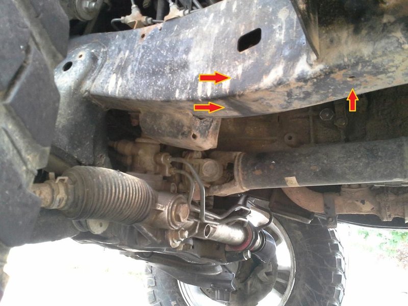

    in less than 5 minutes it fills a quart jar. the picture shows the area and the "wet" marks from gas

    If the fuel line and return line run on the frame where you have the arrows than one of those lines is leaking. If there aren't any lines on that frame rail than it is coming off the engine/fuel management.
    The fact it pisses that much and remains unobserved is impressive.

    Agreed. If its filling a quart jar that quick, then I don't see how it is possible to not find where it's coming from. There should be a damn river leading right to the hole.
    I just went outside and looked at mine. I have a v6 but the lines should be run similar. My fuel lines don't even touch the frame. The only lines attached to the frame are my brake lines. The fuel lines are about 4" away from the frame, attached to the bottom of the floor. So if yours are run similar to mine then it's probably coming off of the motor somewhere. If its not, then it would be very obvious where the leak is in the line.

    My fuel lines are the same, about 4" from frame on the cab floor" The arrows show the hole it pours from and the ring from the gas that soaked the frame. I took it to the carwash and cleaned it all up, maybe with it cleaner I may be able to see the leak :crapstorm: I will let all know what I come up with. What are the chances evap tank is bad? With it flowing like it does you would think it would be OBVIOUS, it is not. :mad:
