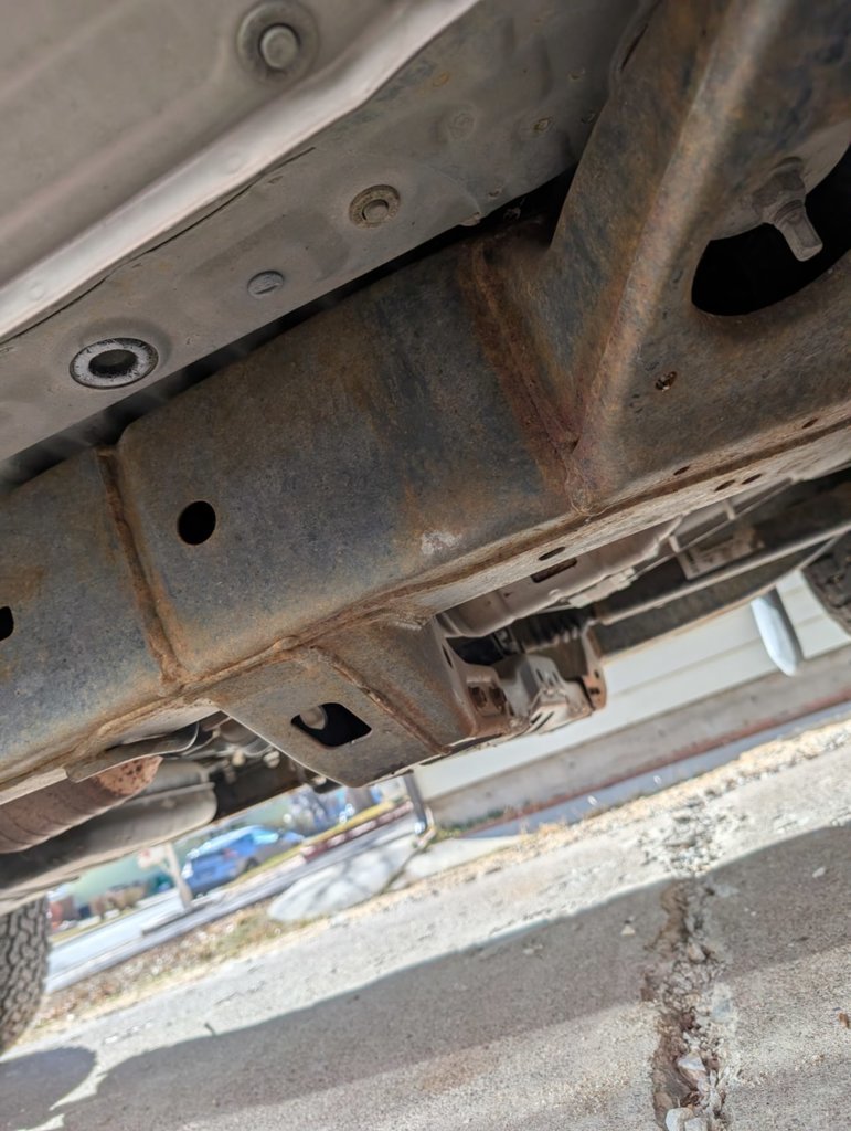

    A 2005 with 155k miles thats been sitting for 5 years? You might want to crawl under and check the frame.

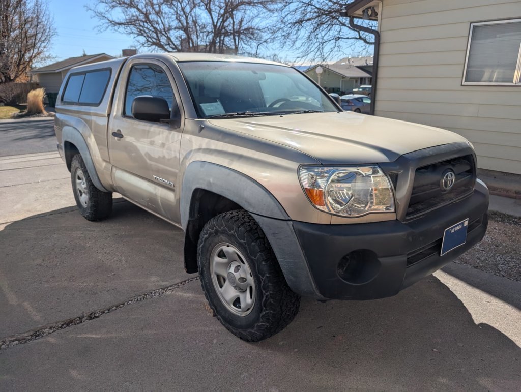

    Nevada, very dry here. Frame seems ok to me. I am friends with the owner. He bought a crew cab 3rd gen because he needed more interior space for work, he meant to turn this Tacoma into more of a dedicated off road rig but never got around to it.
    Makes sense, thanks!

    I'd wire wheel it and coat it, but that definitely looks like surface rust only to me. There are a number of threads that list the main problem areas, go ahead and double check them but I would be surprised if you find anything

    Many SW trucks tend to be like that, almost no rust if it's lived its's life out here.

    Yes, that frame looks good! I'd clean it up a bit and hit it with some semi gloss black Rust Oleum.
    After it dries for a few weeks, you could spray a little fluid film on the sandwiched areas but if it's going to stay in a dry climate, it might be a waste of time.
