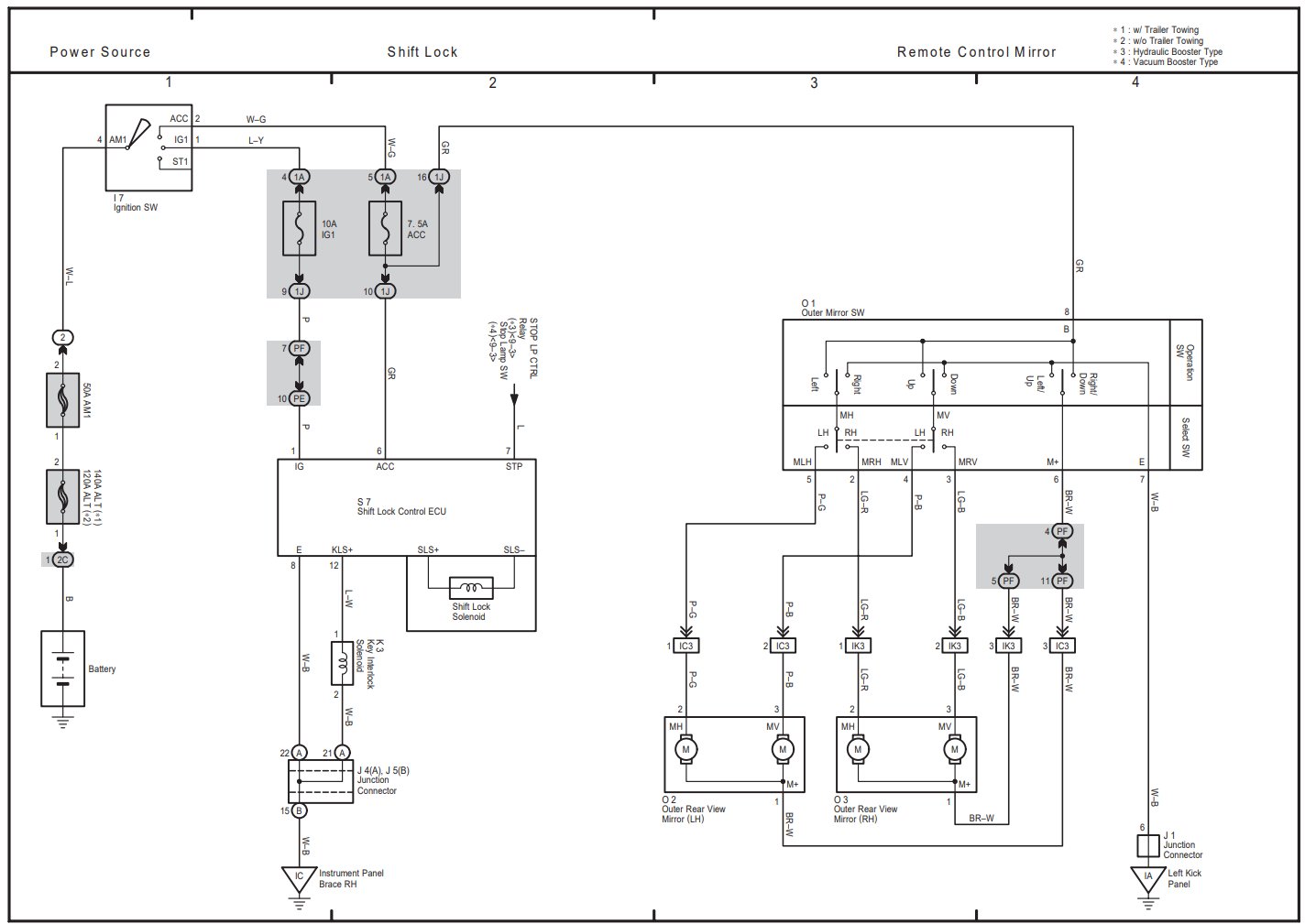

    I am in need of a door wiring diagram for my 2010 Toyota Tacoma Trd sport that shows what the OEM wiring of the mirrors provide. OEM plugs from the door. There are two sets of black white and red yellow wiring. Is there a way to wire for Thursday November and the heat to the aftermarket mirrors?

  5. Jul 11, 2024 at 7:58 PM
    Dm93
    Dm93 Test Don't Guess
    Mar 3, 2015
    #150066
    13,750
    Texas
    2014 DC OR 6spd 4x4
    Predator tube steps, Ranch Hand grill guard, Magnaflow CatBack exhaust, Toyota tool box & bed mat, 2LO Module by @Up2NoGood, Rearview Compass/Temp Mirror, Tune by @JustDSM.
    2nd Gen Tacomas don't have a provision for heated mirrors if that's what your asking, they have power mirrors and TRD Sport's have turn signals in the mirror.

  6. Jul 11, 2024 at 11:09 PM
    sergeantdewi
    sergeantdewi [OP] Member
    Jan 31, 2016
    #176735
    6
    Peter
    2003 Red DLX
    That’s exactly what I needed. Thanks so much!

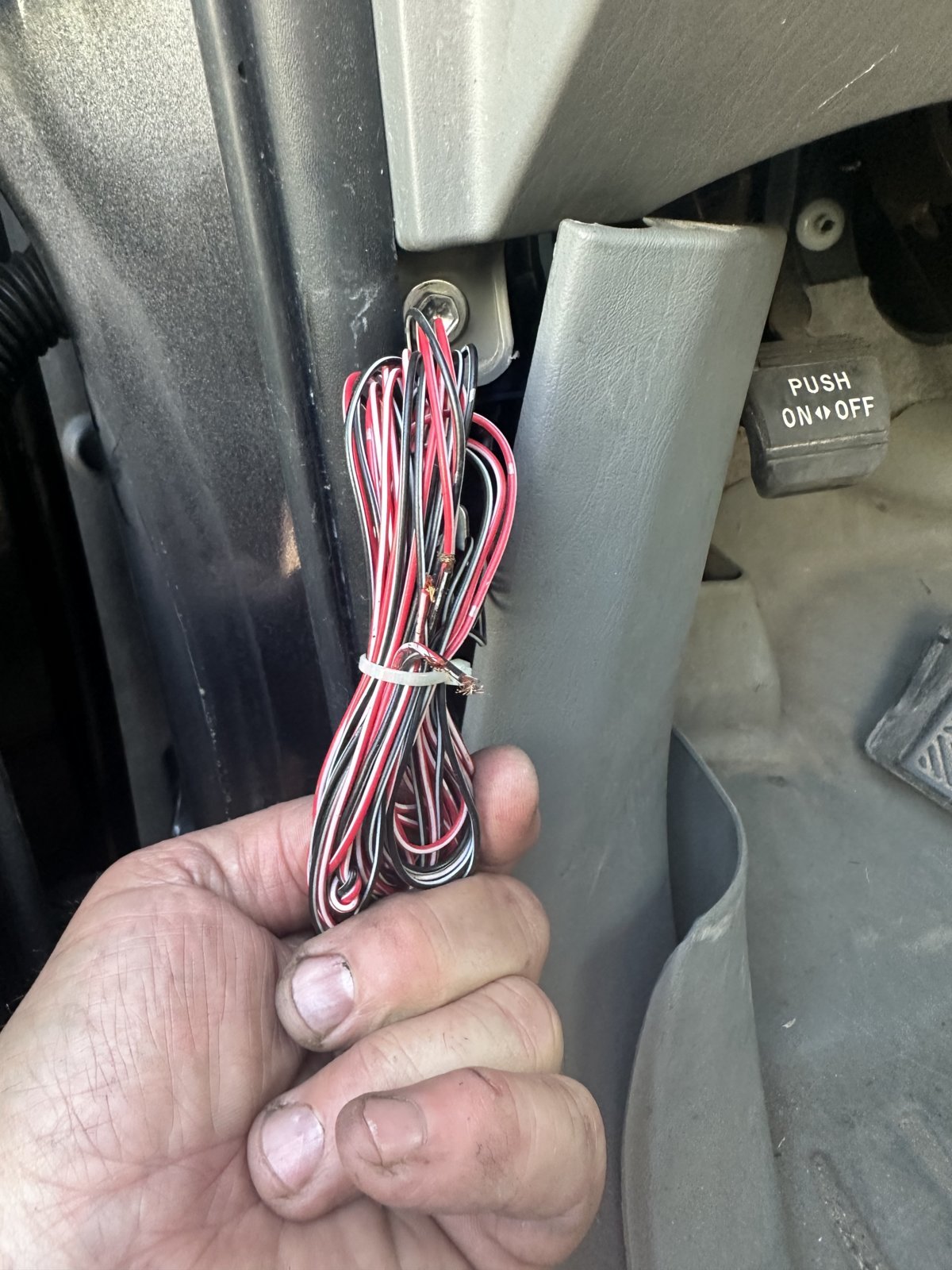

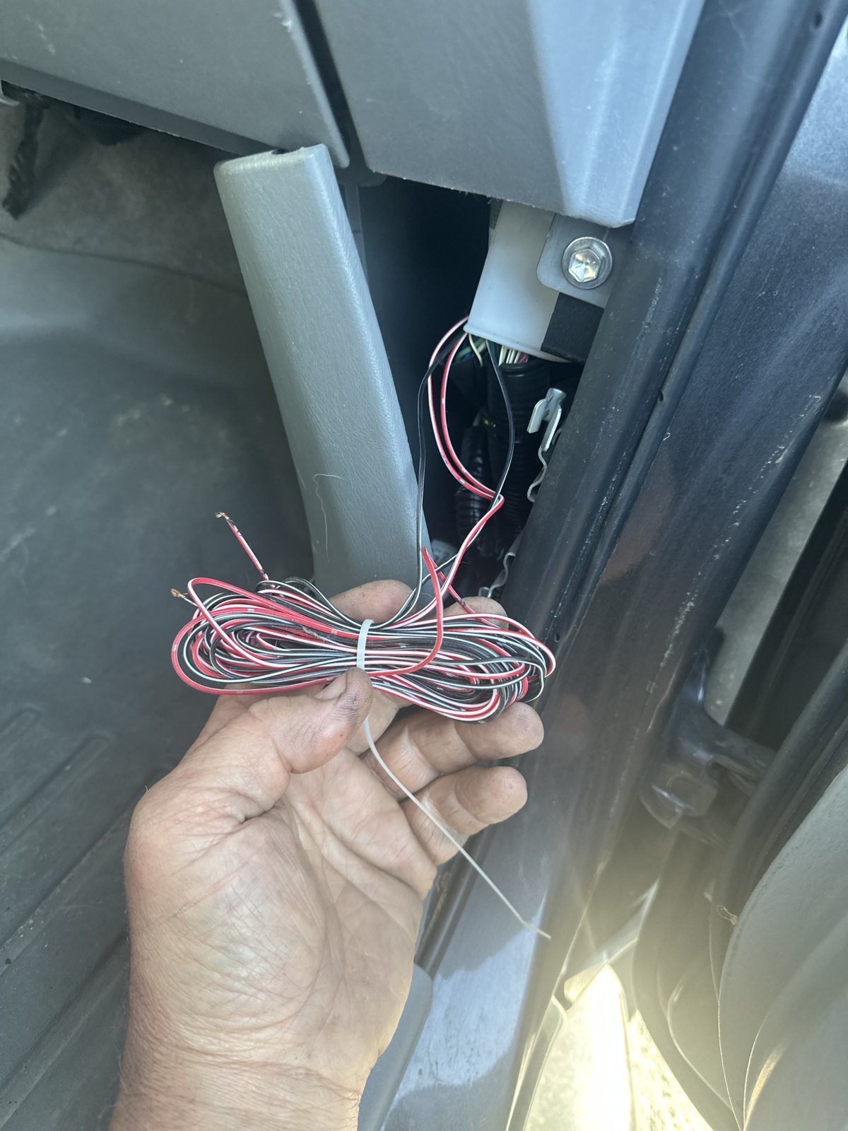

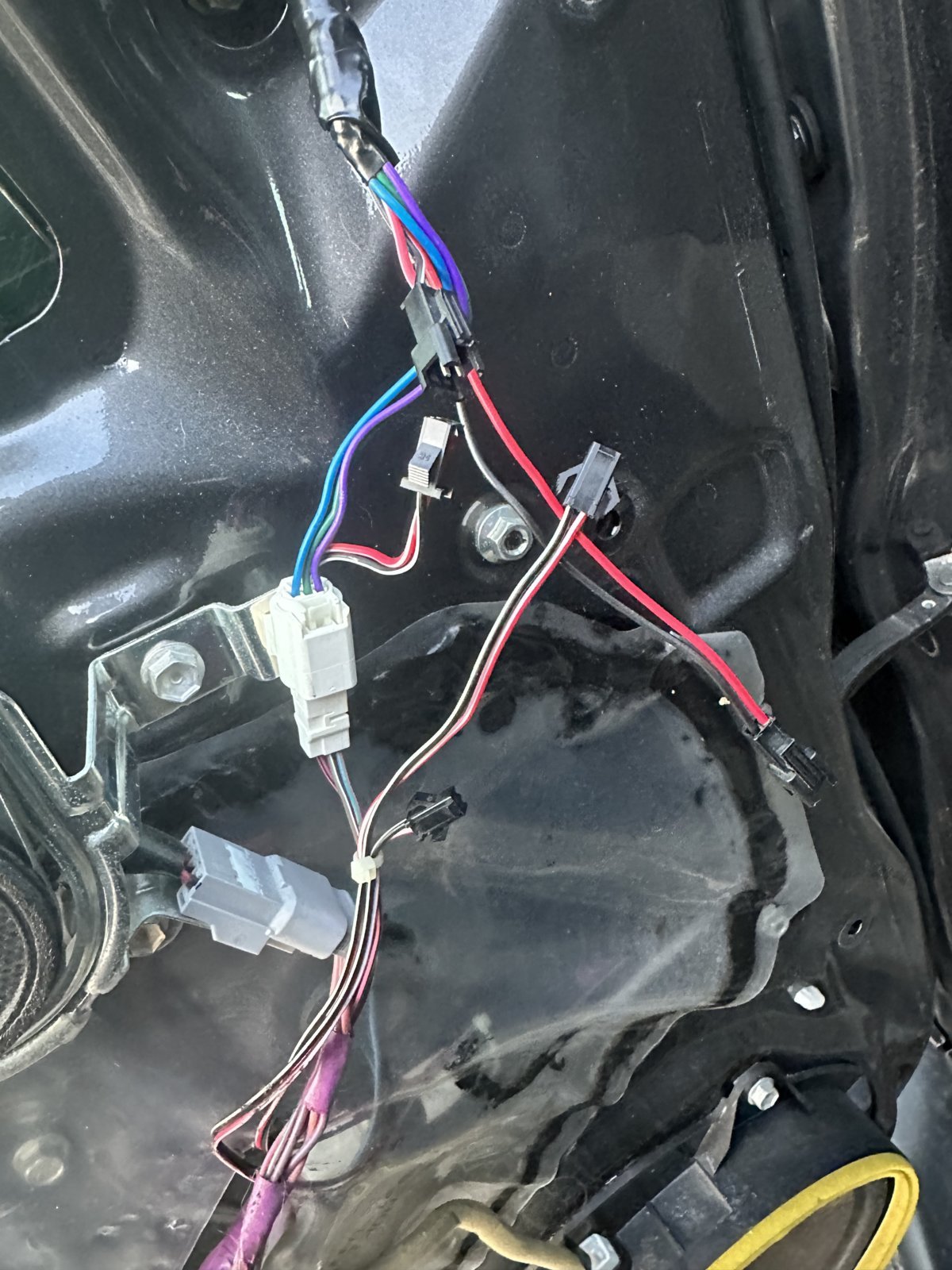

  7. Jul 13, 2024 at 4:26 AM
    sergeantdewi
    Jan 31, 2016
    #176735
    6
    Peter
    2003 Red DLX
    So I went and checked power on the connectors that I saw in the door…. no power… So I followed it through the conduit, running to the door and to my kick panels on both sides. These pictures show you the bundle of wire that gives me the option and my mirrors once I connect them!
