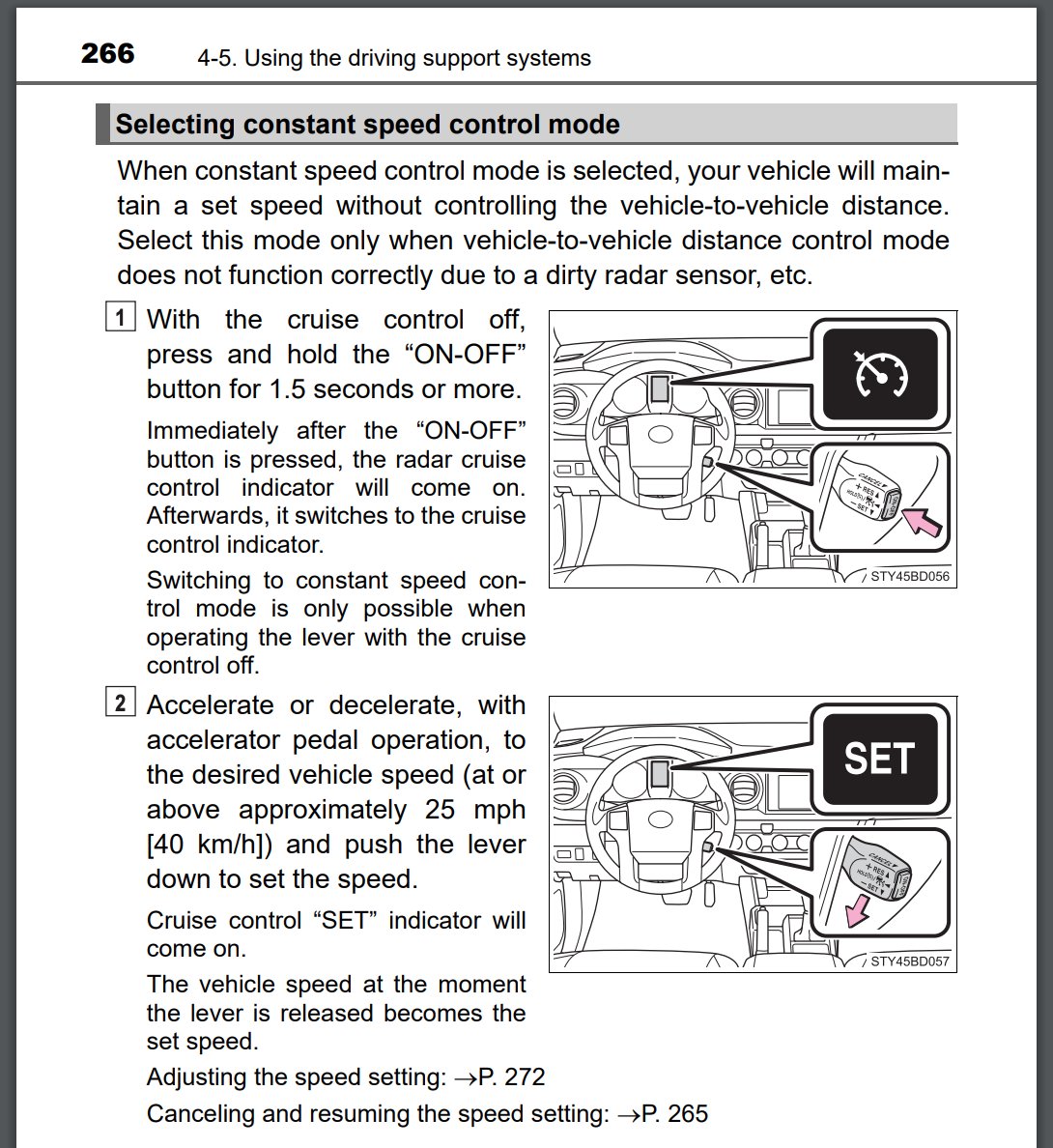

  16. Jun 24, 2019 at 7:16 PM
    #16
    uno
    uno Member
    Jun 11, 2019
    #296086
    13
    You can still use manual cruise, IIRC you just hold the button to turn it on. Manual, meaning you set a speed and it will hold that speed until you hit the brake or pull the lever to cancel it.
    https://www.toyota.com/t3Portal/document/om-s/OM04021U/pdf/OM04021U.pdf
    Page 266
    shane100700 and StayinStock like this.
