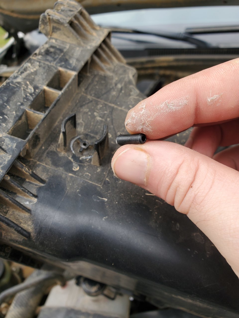

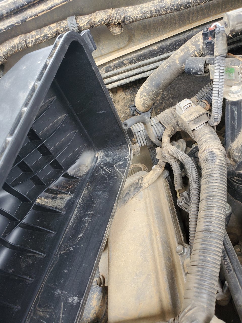

    So I decided to clean my throttle body, and as I was pulling stuff apart to get to it, I forgot about the little hose in the back. Seems i broke the lconnection completely. Not sure what it is. Dumb mistake I completely forgot about it. Can anyone tell me what it is and how I might fix it? 20200926_135123.jpg 20200926_135126.jpg

    Its the vacuum line for the fuel pressure regulator if I recall, it does matter.
    I usually fix these by drill it out and sticking a new vacuum fitting in and epoxying it.
    You can also check and post ads looking for a stock intake, there are plenty out there.

    Take a red straw from a brake clean can... stick it in both ends. Cut to fit and epoxy it... done

    I figured it was something important. Completely forgot about it. Good thing its so fragile, right?

    Yo ill be damned. It looks like its gonna work. Now I just gotta work on not taking my truck apart like a gorilla. Thank you!

    Wam bam. Just epoxy. Literally 5 mins

    I usually find a drill bit of the correct diameter and place it in the hole until the epoxy hardens. Helps to keep the hole clear.

    That’s what the red straw does... keeps everything open ;-)
