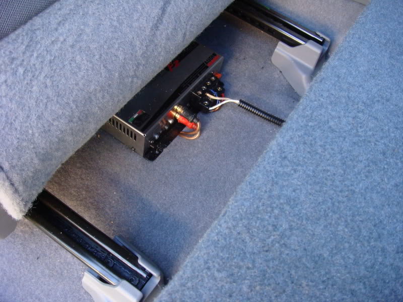

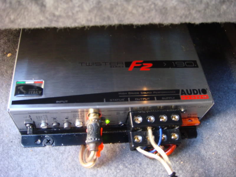

    I put my old highs amp as my sub amp. Its a Twister F2 190 520W amp thats tiny as f*%...but it really pushes 500W. Its perfect for under the seat, with room to spare.

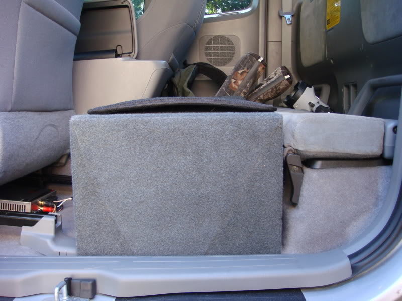

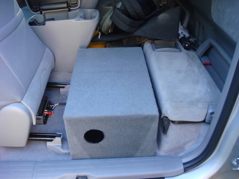

    I built a 1.0 cu ft box with a 3" X 7.15" port...if you want the dimensions let me know. It fits perfectly behind the seat, in between the center hump and door sill, and level with the back seat. Unfortunately, the carpet I wrapped it with (which you can get at Autozone or wherever) did not allow me to hide the seams as well as salt and pepper carpet but it looks decent.

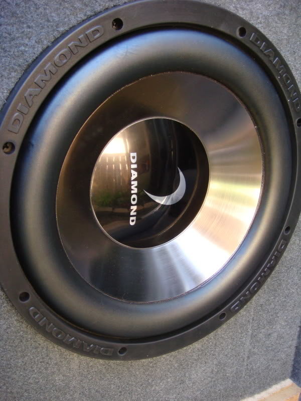

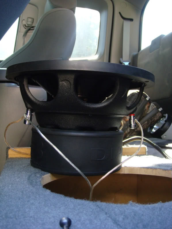

    The Sub I used is a Diamond D3 10" Dual 2Ohm ran series. Its not quite the same as my Diamond D6 I had in my car, but it beats pretty damn well.

    NICE WORK :thumbsup: I have been looking for some AC sub ideas, how is the seat travel/tilt? It's not making it so you have to be under 5' to drive is it?

    No, I'm 5'8" and I have plenty of leg room, you should be good if you're six feet and the top of the box sits even with the axis point of the seat back so you can recline...and you can still open your rear storage..thanks for the compliment
