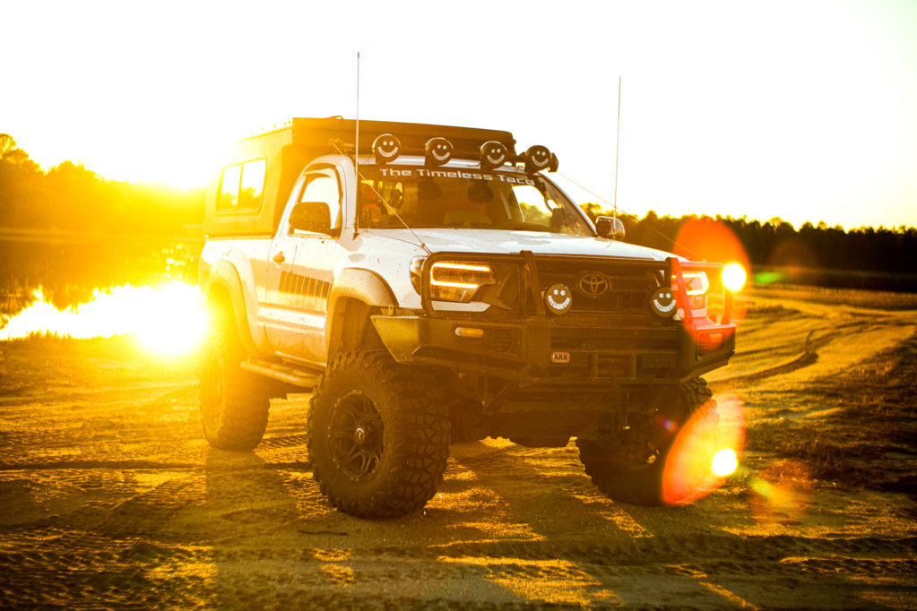

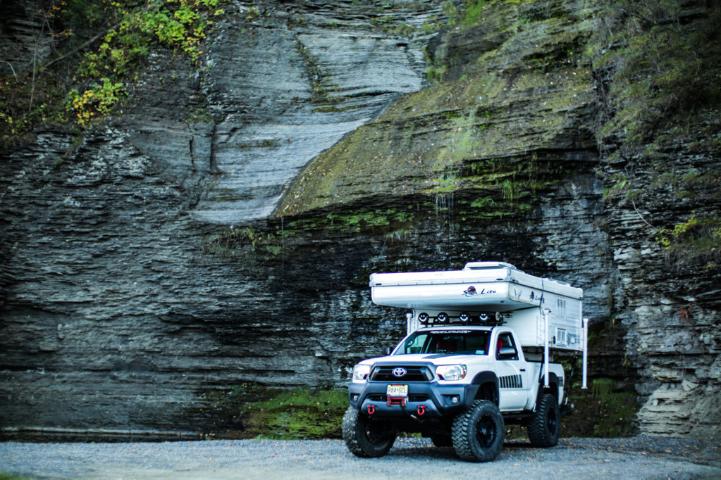

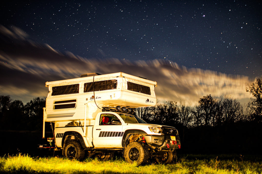

    2013 toyota tacoma. Regular cab manual. 1985 toyota 4runner s45
    3" toytec big boss suspension lift. toytec 1" bodylift. 33" nitto trail grapplers. 16 inch raceline raptors. sterling equipment double single roll bar.
    Build breakdown
    2013 Toyota Tacoma
    5 speed manual
    5.29 gears
    Powerbastards high output alternator (220 amps rather than the stock 80 amps) https://www.powerbastards.com/proddet...
    Rear locker
    Flippac camper with my custom fabrication added
    Custom made bed drawers
    Bluetti AC200p
    Bluetti charger1 alternator charger
    400w of flexible solar panels on the roof
    Smittybilt synthetic winch 9,500lb
    ARB front bumper
    Smittybilt defender roof rack
    KC daylighters
    Morimoto XB amber headlights
    Timbren SES bump stop replacements
    Wet okole seat covers
    RAS Road active suspension https://activesuspension.com/products...
    35 x 17 Yokohama Geolandar XMT JBA HD High Caster Upper Control Arms Raceline raptor wheels 1985 Toyota factory stripe kit from James deans creations https://jamesdeancreations.com/1984-8...

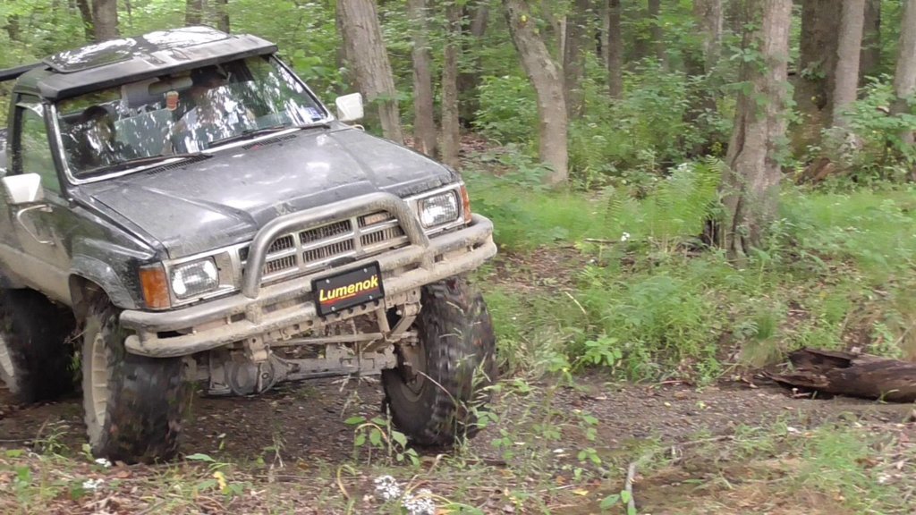

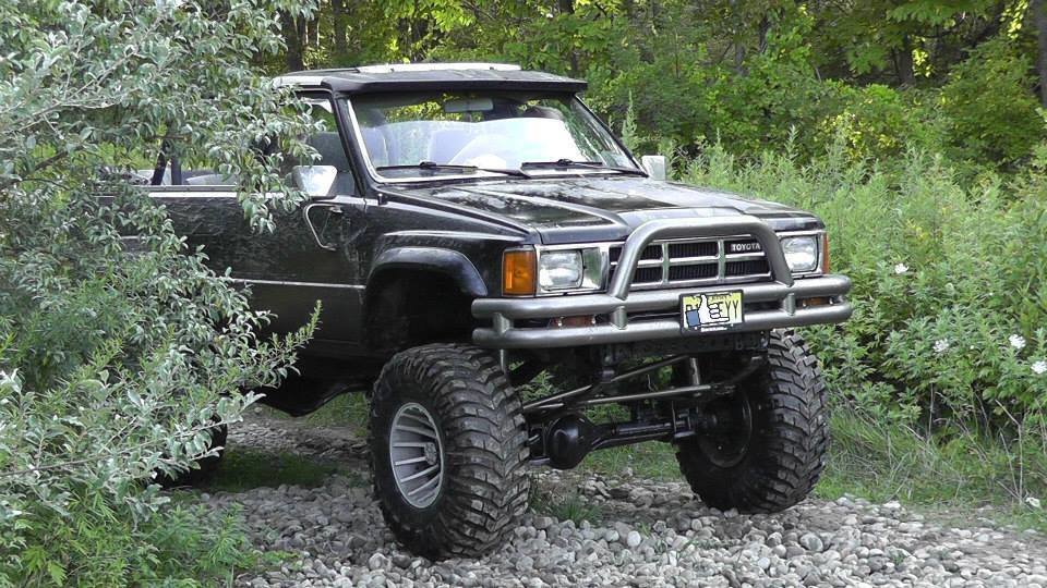

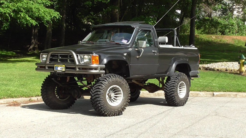

    Thanks so much! and hell yeah! closest thing to my old 1st gen 4runner that I could build hahah

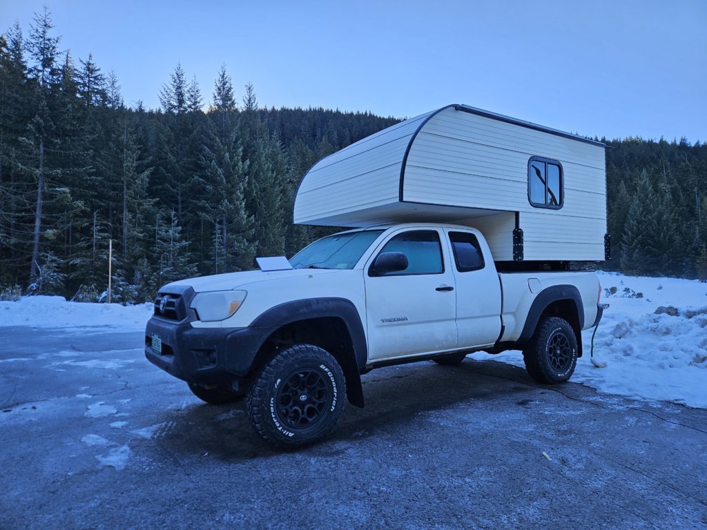

    Very rad, man! With the slide in on my access cab (also a 4 banger with the manual transmission) I got between 12.5 and 15.5mpg - usually got the best traveling around 55mph. The set up was comfortable as hell and rode great on Deaver Stage IIIs. Decided it was probably a little too big for my regular cab so parted ways with it a little while back. The regular cab came with the Go Fast so running that until I decide what will go on there next. Trying to keep it lighter weight so I can stay as capable as possible. Been thinking about re-gearing, though, so cool to see your build with the 5.29s!
    When did you re-gear? Before the campers or after?

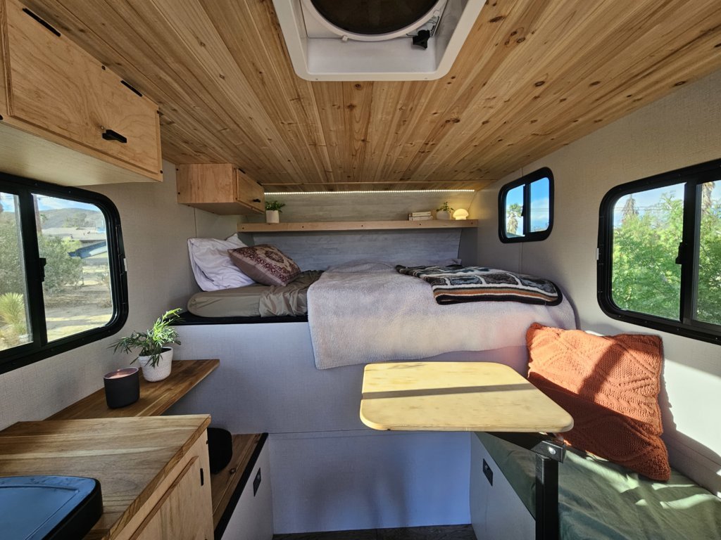

    watkins timeless interior5.jpg watkins timeless interior.jpg watkins timeless interior4.jpg watkins timeless interior2.jpg watkins timeless interior6.jpg
