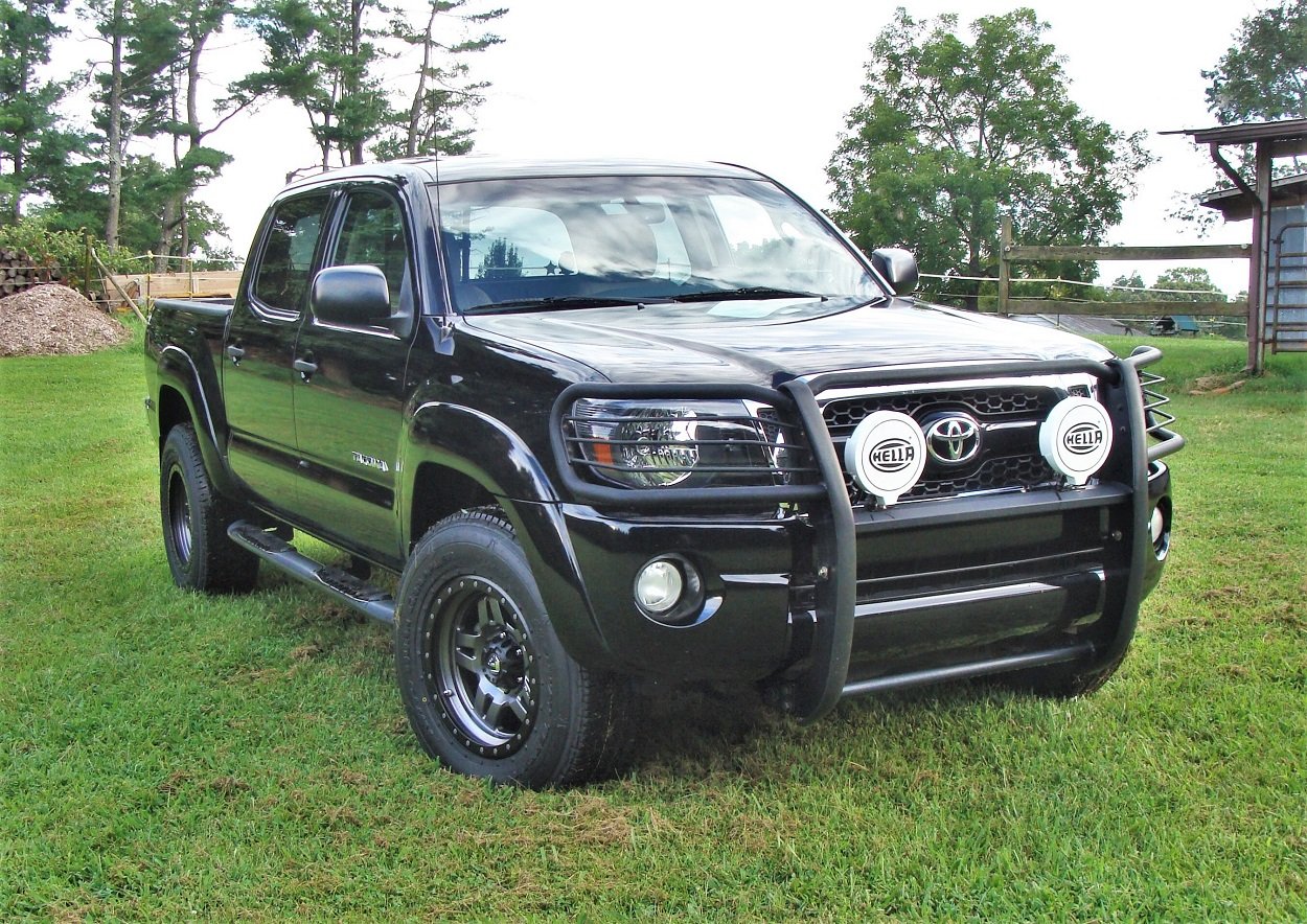

  7. May 2, 2023 at 2:45 PM
    #47
    Groan Old
    Groan Old Well-Known Member
    Feb 22, 2018
    #245289
    559
    Ken
    Newton NC
    Black 2011 SR5 4X4,Double Cab, V6/auto
    These are 17x8.5 and zero offset, and the tires are 265/70-17. (truck is a 2011 SR5) I was looking to get 16's and stay with the stock wheel size, but the salesman said going up one inch made the spokes look less "squashed", or some such. I like the look and the silver-gray coloring wouldn't be bad on your truck, IMO.DSC01760 (2).jpg DSC01762.jpg

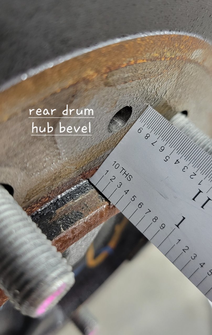

    My truck is a 2023 and I had to bevel the rear axle hubs to clear the OEM 2021+ 4runner wheels.... it took a good bit to get mine to fit(see pic below). I bought my wheels in December of 2022. Wheels have a Dec 6, 2022 date on the boxes.

    That's awesome to hear. Glad you didn't have the fitment issue, but that doesn't seem to be the norm. Who installed them? I wonder if your tire store simply handled the mod.

    I saw ur mod post…. They def did not do that. But mine def button up tight to the hub/drum

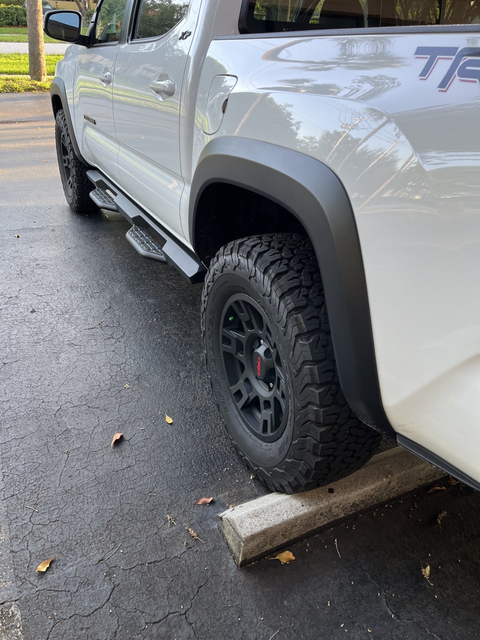

  18. May 3, 2023 at 4:41 AM
    #58
    Neanderthaler
    Neanderthaler Member
    Apr 7, 2023
    #422085
    9
    Dan
    Offroad 4x4 XP
    I just had the dealer put 17” 4 Runner Pro wheels and tires on my 23 Offroad 4x4. They look like they are tight against the drum. Hard to see in the pic616F5419-3E5F-427C-B77C-4A44F2E1FDDB.jpg
