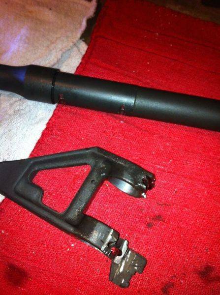

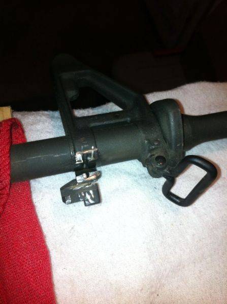

    I put my dremmel to work
    I took my time, braced my barrel down, and everything came out great so far. I will finish on thursday and I'll put up the finished pics then

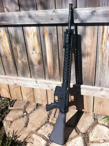

    the 16" upper was way easier. the pins just taped out nice and easy

    very nice; what are going to do for optics?
    Any pics of the carbine?

    the carbine is in pieces in my safe :eek: I have a barrel nut wrench/armorers tool on order and then I will finish that.

    Kinda late but why did you cut off your front sight instead of just cutting it down. You can trim enough off for the ff handguard to fit over easily. Plus its still factory fit.
    You can see how skinny the Spikes SAR rail is and I have no clearence issues ay all. Like I said It's a little late but just a reference for ur next build.
