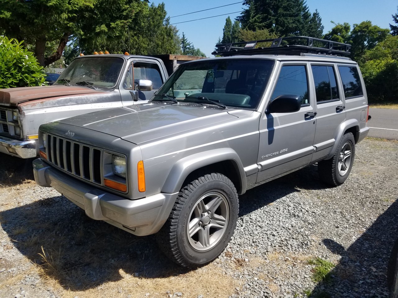

    I sold my 2000 XJ Classic to buy my Tacoma... you're making me regret that decision.
    I ultimately got rid of it when I realized I was spending all my time fixing minor things and buying too many parts. Final straw was when the radiator blew, right before a 3 day weekend, when my wife and I had planned a hiking/backpacking trip.
    Miss the ol girl. She was a blast to drive.
