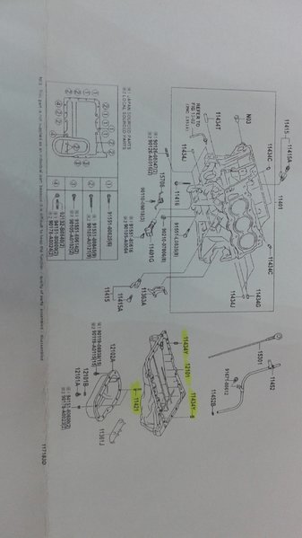

    Okay well I'm at work now and had our parts guy bring up the motor pic with the oil pan in it. What cracked is the upper oil pan, good news it is doesn't have the main bearing support in it like the Camry motors like I originally told the op. The bad news is the transmission still bolts to this pan so that will have to be unbolted and possibly removed from the truck. Also because there is a cross member that is under the front part of this pan that isn't removable the motor will still most likely have to come out to replace it.
    The toyota seal packing (FIPG) is $20 a tube, might need 2, there are 2 dowels in the pan $1 each needs 2, 2 studs for the lower black pan $1 each if they don't come out, and the upper oil pan itself is $267. So $300 for parts not including oil and whatever labor. Talked with another tech here and there is a possibility the trans could be unbolted and moved back and unbolt the motor mounts and lines/ harness and lift motor up enough to just clear the cross member, my not be possible though.
    I'll try and attach the pic from our parts department.
    blenderdriver, PzTank, Crom and 2 others like this.
