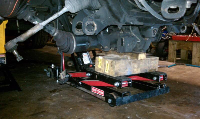

    Drop front diff, then drop oil pan. Replace O-ring while in there. Two 10mm head bolts, at the rear, hold the rear main seal to the oil pan.
    No need to remove the transmission. The studs will have to be removed for clearance.
    If you chose to do it yourself.

    How hard is it to remove the front diff?
    In time this is a repair I would like to do myself, as this sort of thing bothers me knowing that it can potentially be an issue again at the most unwanted moment.

    With a jack, pretty easy.

    Like Mark said - with proper tools it's not too bad.
    Personally, I'd rather pull the front diff than have to wrestle with the steering rack again :oops:
