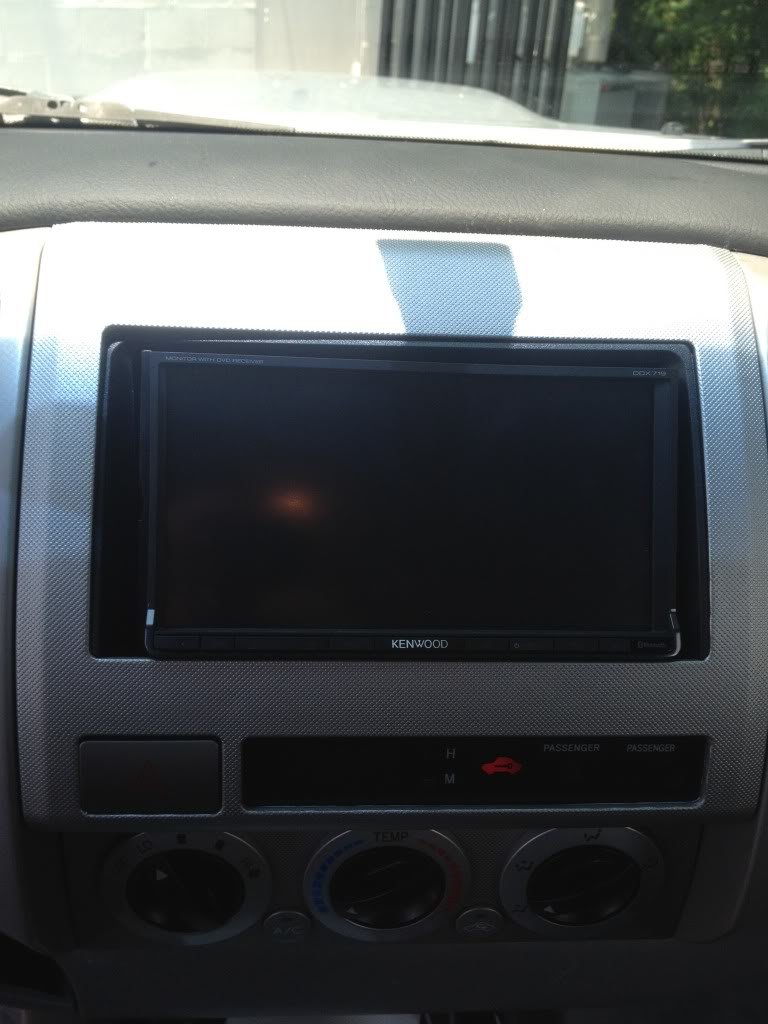

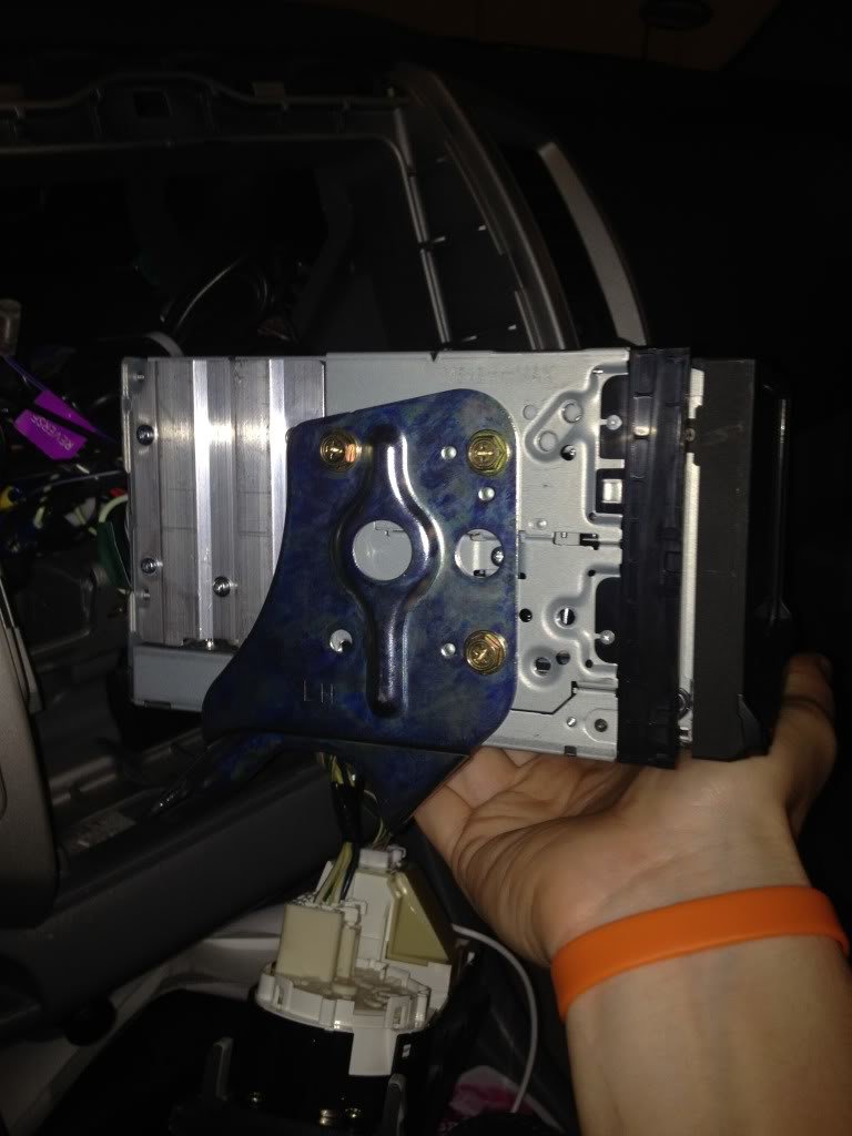

    Still can't get this fixed...
    I don't understand gentleman... Darren was nice enough to reach out to me, and we are doing what we can to get this fixed, but this is turning into a nightmare.
    The first picture shows how low the headunit sits. You can see that it like sits with the 2nd grate on the air conditioner and everyone else's I have looked at sits much higher.
    2nd picture shows the position of the bracket right now. Darren told me to file down the points so I can move the bracket, in which I did have a little bit of luck doing. But this still doesn't fix my problem that the headunit doesn't sit high enough to fit the dash kit around. I understand everyone is saying you have to push up on it, but I can't even get enough pressure to push it up and get the dash kit around it. And as you can see from the pictures, there are no other holes that is going to reposition the bracket to lift the headunit up any further...

  16. May 20, 2012 at 8:03 PM
    #16
    CrutchfieldDarren
    CrutchfieldDarren Well-Known Member Vendor
    Apr 27, 2012
    #77733
    62
    Darren
    Hey Taylor,
    The brackets look right from what I can tell. I don't think you could mount them any other way like you mention. It seems to me that the left side of the radio is not sitting as far back as the right. This seems to be because of the PAC TATO interface, or other wiring from the Kenwood getting in the way. This is also not allowing the back of the unit to sit down enough which is why the front of the face is rubbing the kit like that.
    At this point, I would suggest to dry fit the radio into the dash with nothing connected or in the way of the radio. I know, this may seem pointless, but at least we will know for sure if this is a bracket issue, or simply wiring getting in the way of the unit fitting properly.
    So get the wiring disconnected and the PAC TATO box out of the way, then mount the radio into the dash, make sure to leave the bolts holding the brackets to the sub dash a little loose. This will allow you to slightly adjust the radio when you are putting it in.
    Also, make sure you have the Double Din Trim ring attached to the back of the Metra kit correctly. Two of the screw points at the bottom of the DD trim are supposed to attach to two of the top screws that hold the Clock/Hazard bracket on. Make sure you have that correct also. There should be a diagram in the Metra instructions on that.
    If it mounts correctly like this, then we need to figure out how to best position the wiring to allow the unit to fit properly.
    Let me know how this works out for sure. I want to be sure we make this right!!!

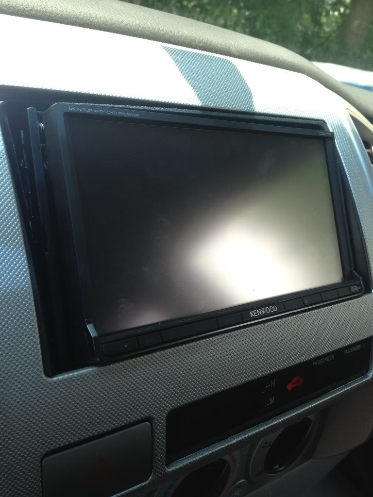

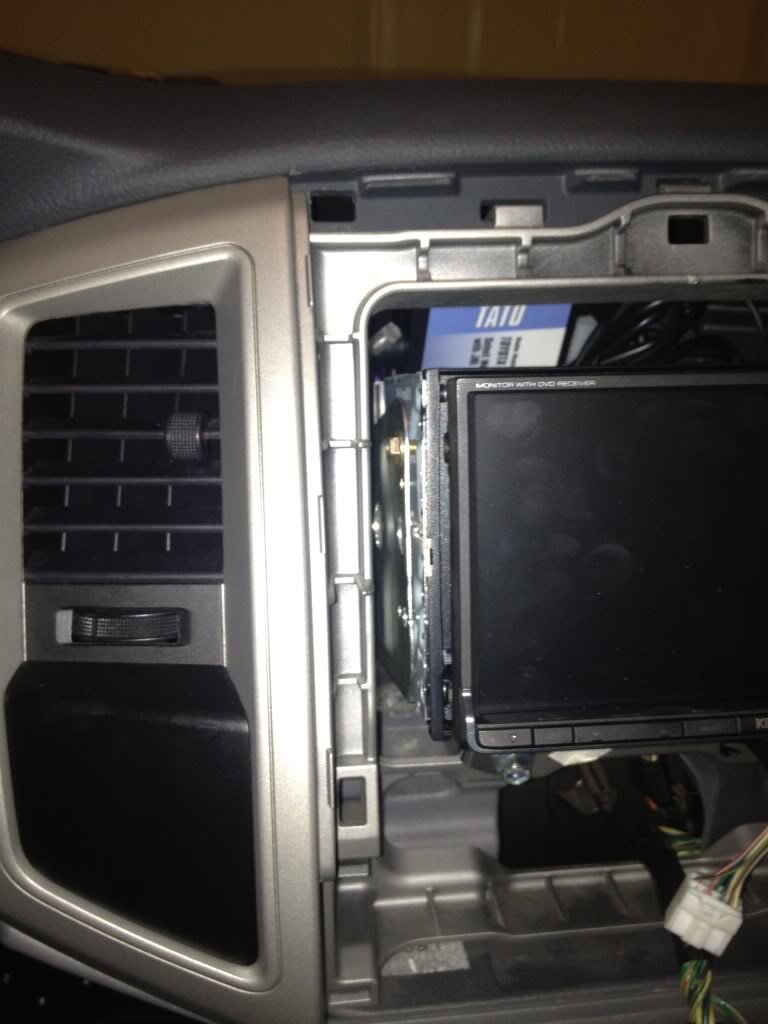

    Thanks for the advice Darren, here's how mine ended up on the dash of a 2012. It's a 99-8214TG Kit. Thankfully I used the old yellow clips off my stock stereo.....They work pretty good. If anybody knows where to buy these let me know, could use some more. Isn't a great fit, but works for now.

    the4cecop,
    Glad that helped!! That actually came out quite well IMO, not bad at all. As soon as I hear anything on the 2012 kit, I will let everyone know.
    And i'm pretty sure you will have to get those from the dealer, likely in packs of 5 or 10 from what I've seen in the past.
