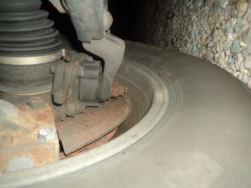

    Here are some pic of disc brake dust shields after I pushed them back in some.

    So are they going to fix it?
    I dont know what you are showing me with the brake dust shields.?

    Nope
    shields were pulled out on the bottom to fix rubbing noise
