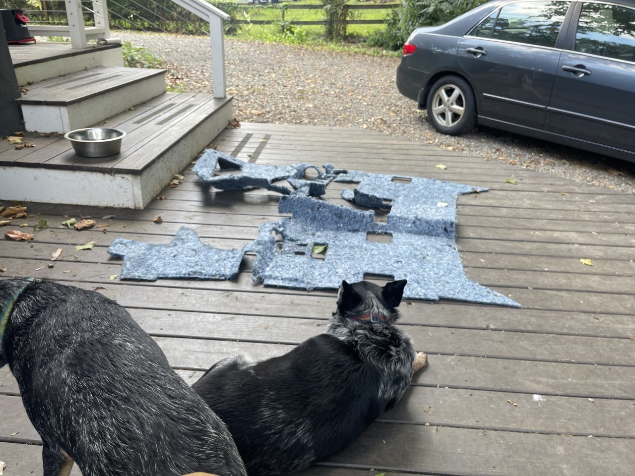

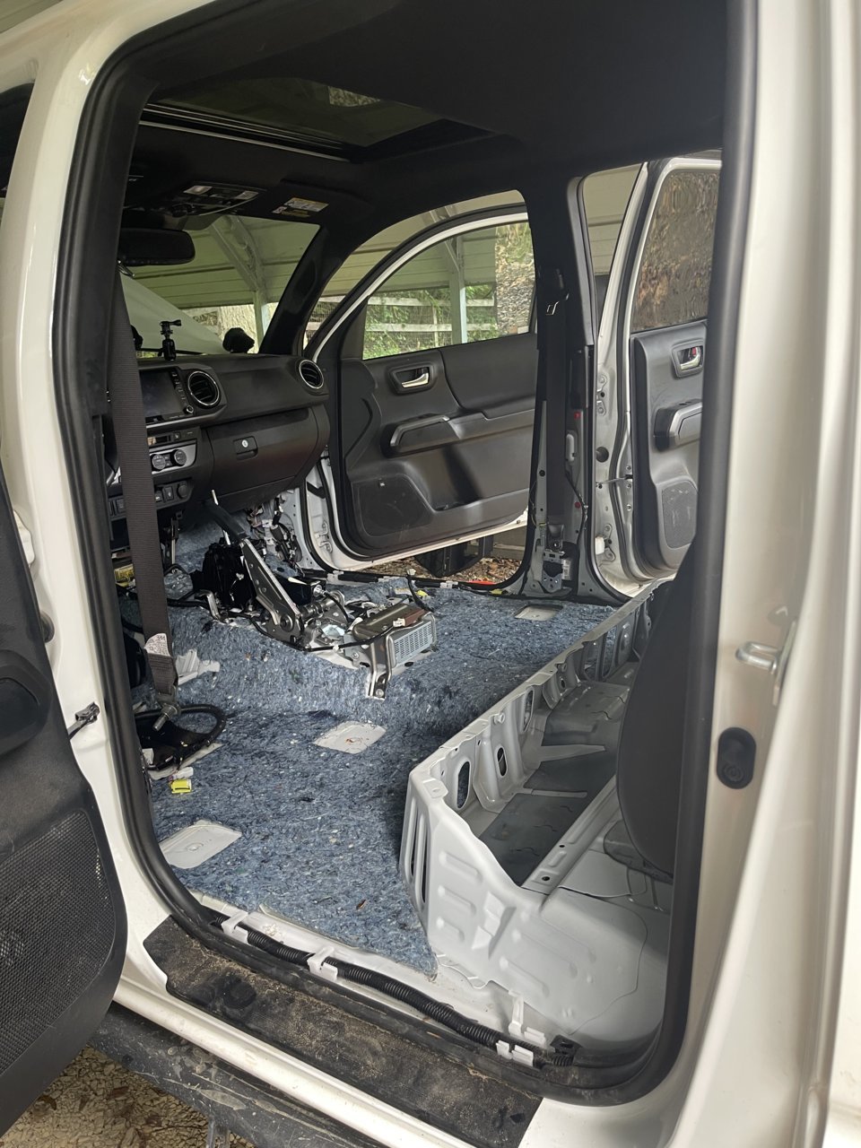

    Well, day three. The entire interior is out and drying. This is the point where I wish had some money stashed to accomplish a few tasks that would be easily done with the seats and interior out like comms, running power to the back of the center console as well as running some Dynamat throughout. That’s for another day I suppose. D1187286-1905-4745-9E77-9798CBDC35EC.jpg53F70EC1-B838-4C7E-9B65-9462F3D368A3.jpg

    While things are drying you probably should check your rear diff fluid to make sure it didn't get any water in it. The , supposed to be, one way check valve doesn't always work just one way. I've seen a few times where they didn't. :thumbsup:
