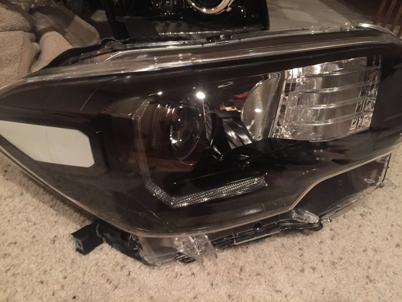

  17. Dec 10, 2015 at 10:19 AM
    #37
    ottoperformance
    ottoperformance [OP] Well-Known Member
    Nov 15, 2015
    #169680
    195
    Colorado
    2016 White TRD Sport DCSB
    TACOTUNES, BAMF GRILLE
    Unfamiliar with BHLM but I assume you mean the headlights.
    Take out all the screws on the outside of the housing.
    Bake 255* for about 7min. Start prying apart. With other cars it's come apart much easier. With these I had to pull apart and put back in the oven multiple times. Partly because the sealant was much harder than others I've worked with and also it cooled off very quickly.
    After it was all taken apart clean off sealant as quick as possible to avoid having to use other means of getting it all cleaned off. Or making the mistake I did originally.
    Disassemble headlight inner housing.
    Sand, prime, paint.
    Reassemble
    Reseal with black silicone.
    Zenzai, JDB02, Doggman and 1 other person like this.
