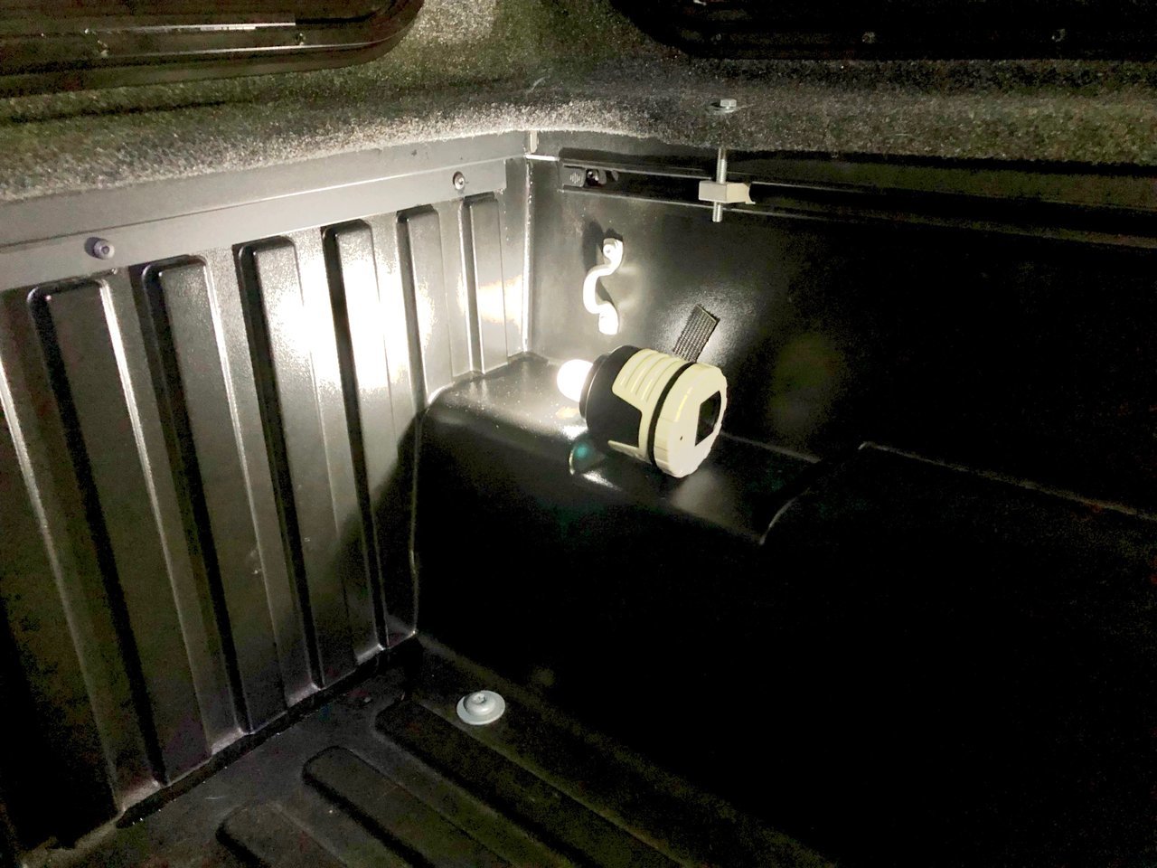

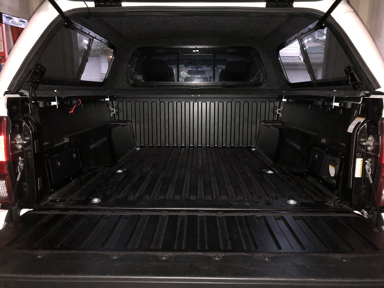

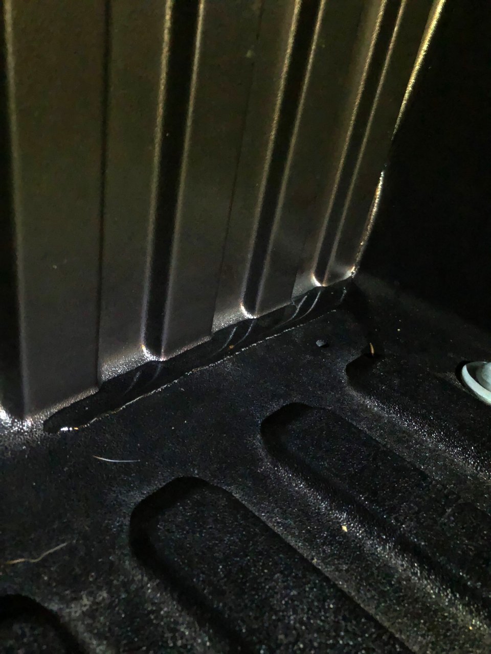

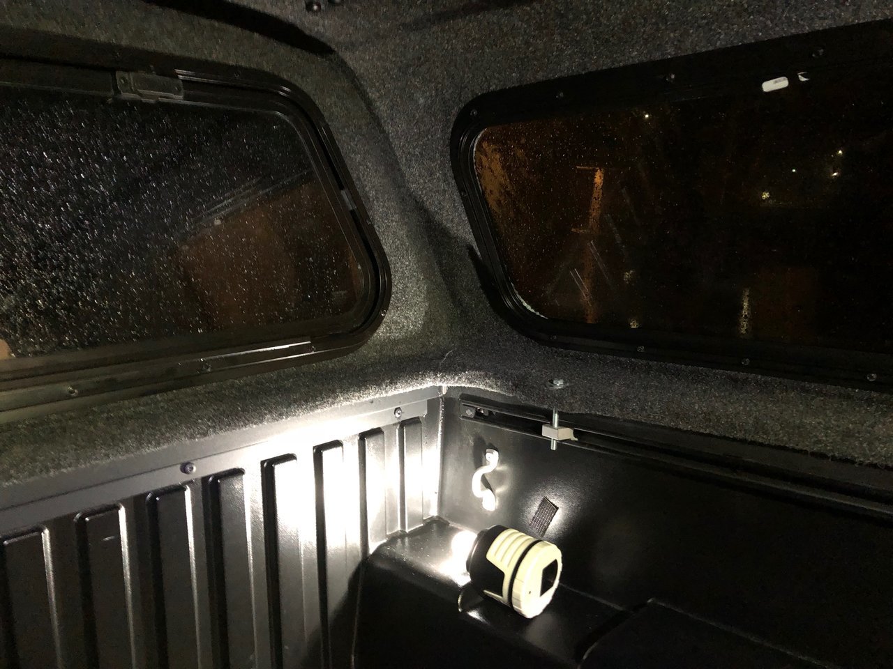

    After last nights rain storm I went out to check on the Dehumidifier. Windows Look better than they have in months. Humidity issue solved! but I start feeling around and can feel tons of moisture under the Front window and passenger window. Water is getting in somehow.
    Luckily Im off and the Mrs is at work the next 6 nights! GAME ON!
    I ripped out the bedrug like @cascadetaco suggested.
    Bed rug feels damp to touch nothing crazy. As soon as i start unzipping it I can tell there is a ton of water under it.IMG_4861.jpgIMG_4862.jpgIMG_4865.jpgIMG_4860.jpg
    I think we have a leak!
    I dried everything completely with a towel. looks like the break in the rain is over. time to play the waiting game

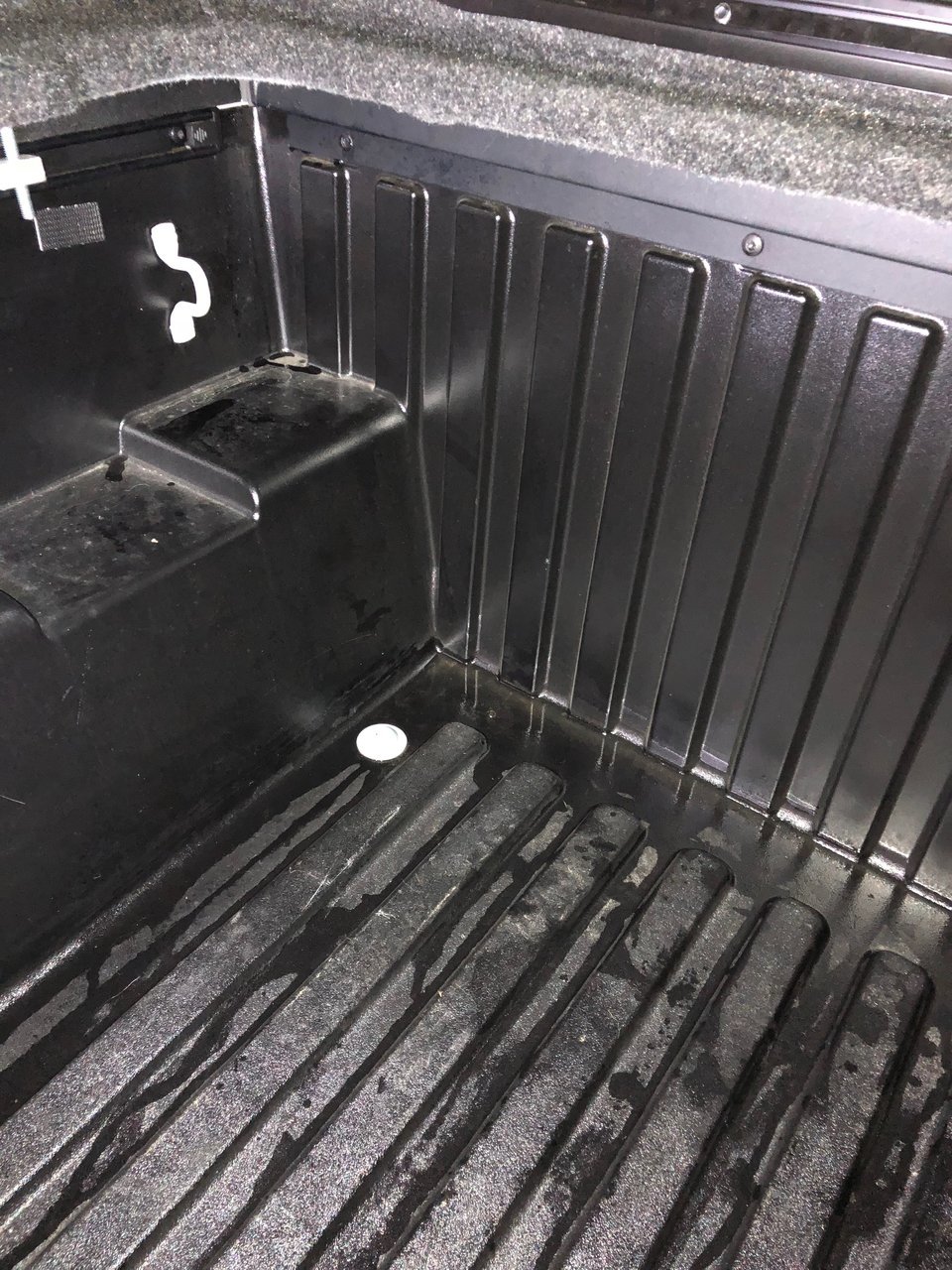

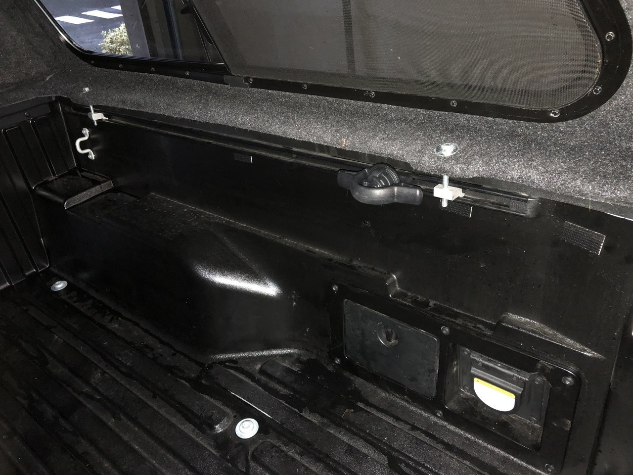

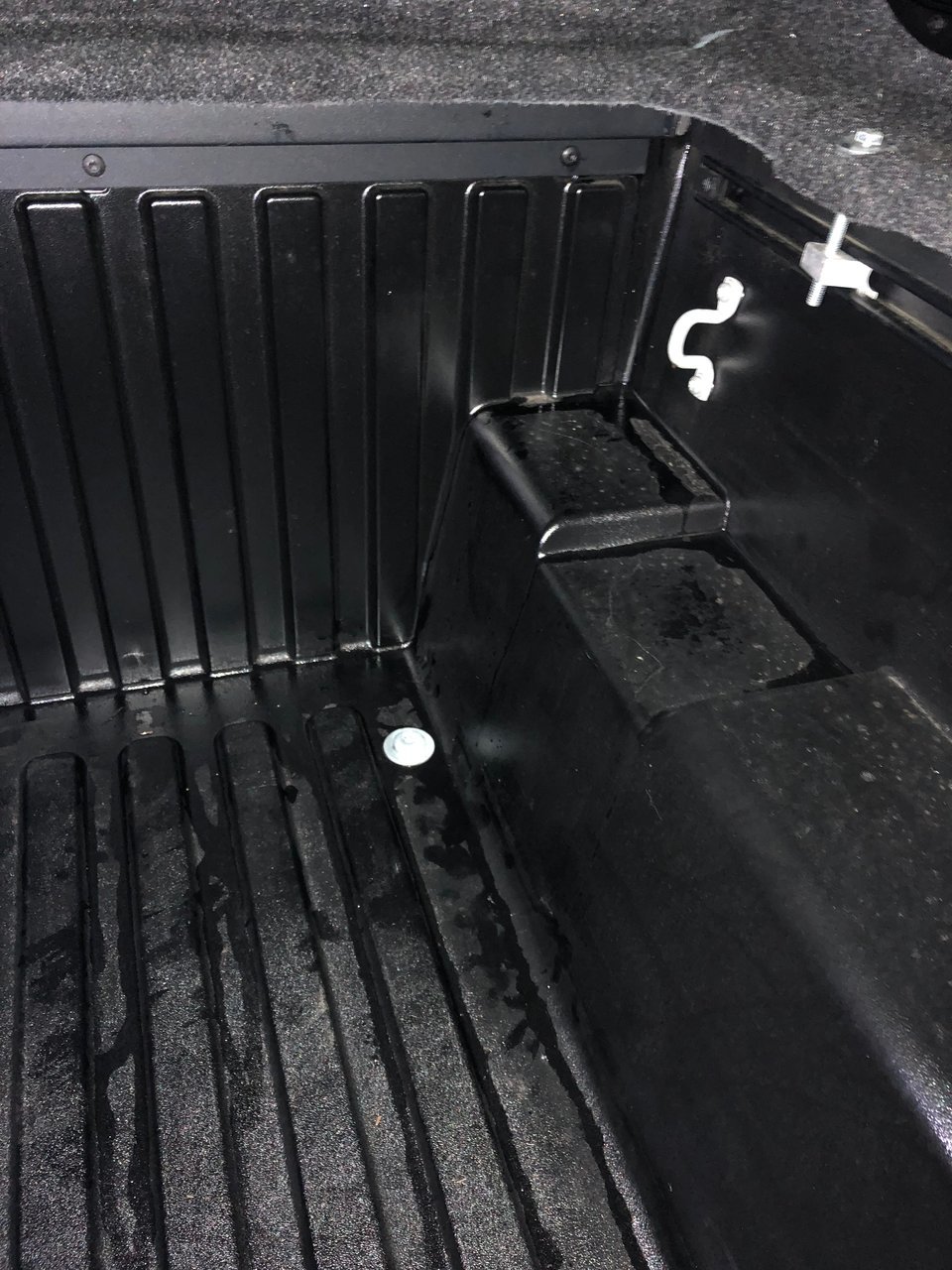

    I left the truck parked like this .IMG_4854.jpgI checked on it a few hours later only to find this puddle. now clearly I understand that thats the direction gravity would take it since its on a slope. IMG_4877.jpg IMG_4871.jpgThis while corner was soakedIMG_4874.jpg I dried everything off and turned it around so the water should now be collecting in the tail. IMG_4878.jpg

    Good luck, the way it looks it looks like your getting water from the corner. If you look at our third gens there is a massive gap there. Check how that is sealed. They might not have done it correctly.

    Ive had that thought. I just want to know, why is the headliner soaked if its a gap between the canopy and bed?

    You shouldn't have a ton of water by the tailgate; water will run out and drain underneath. You'll be able to still tell though if water had been running down. Who was it that recommended that idea? ;)
  19. Jan 12, 2018 at 10:37 PM
