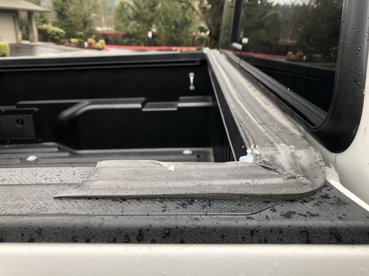

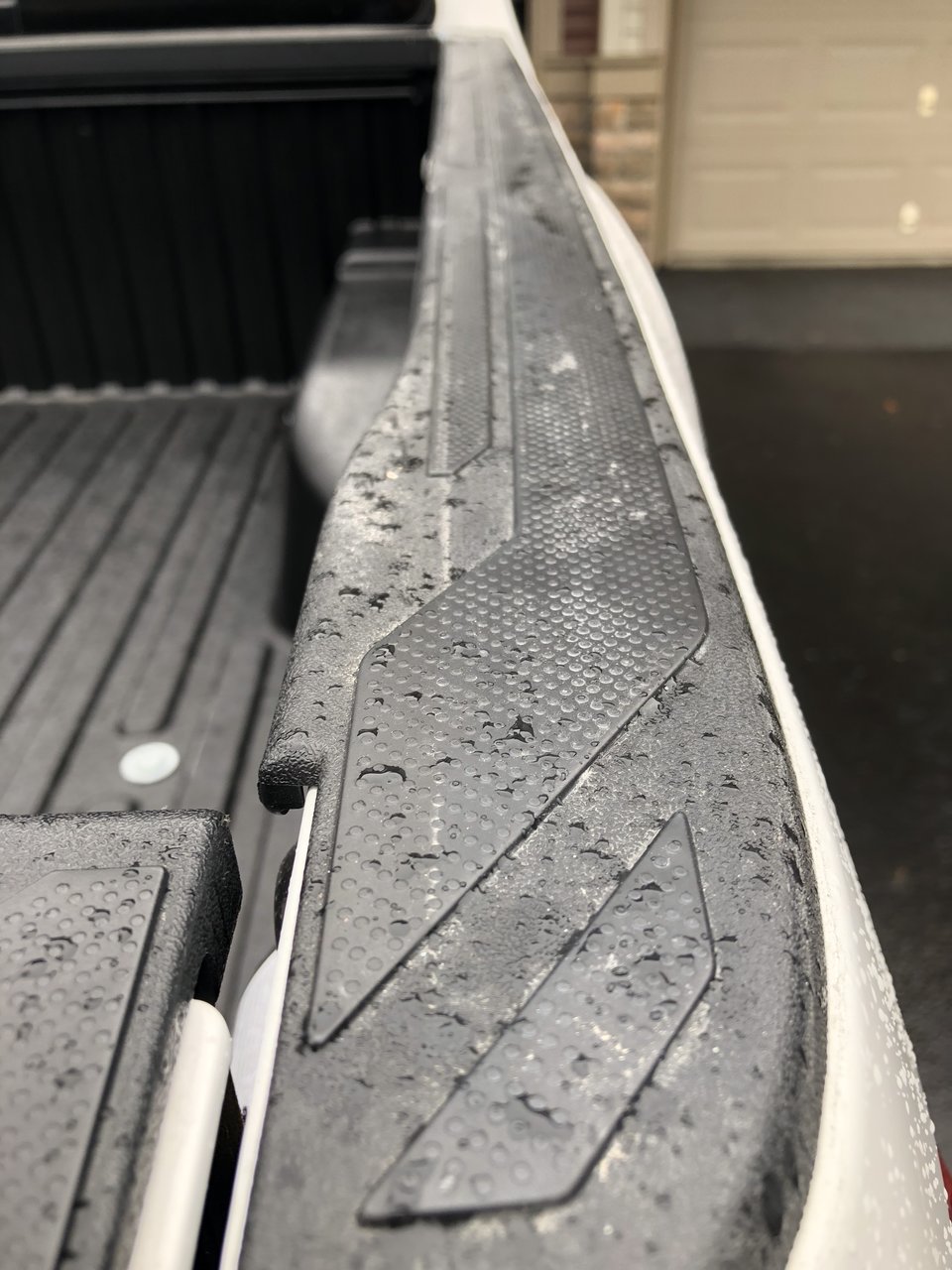

    While your cap is off, I would recommend taking off the plastic caps on the side bed rails and putting sealant under them. There are a lot of holes under those caps that can let water (splashed up from below) and dust in.
    NateWest[OP] likes this.

    good idea, canopy dealer suggested not to do this because the small plastic tabs are fragile

    UPDATE: Canopy is gone, shipping to LEER next week, will be gone 4-6 weeks.
    Should this go the full distance of the bed? I guess I didn't realize it only went a little way down the side rail

    I've never had water come in at the sides unless I pressure washed directly at that are. Always at the tailgate and the front

    The rest of the seal might be on the shell, i would definately want the seal all around the perimeter.

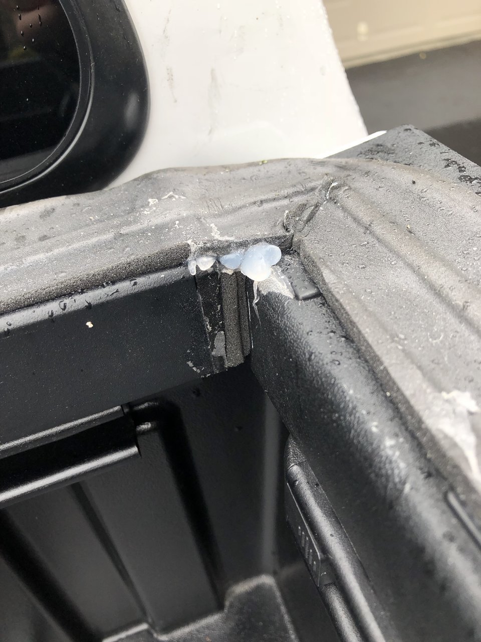

    Some Bolt ones here and there
    The rest of that is stuck to the shell, it runs around the whole perimeter.
    If I was you while the shell is gone, I would redo that seal in the corners because that doesn't look like it will keep anything out.
