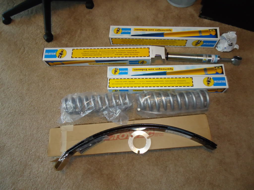

    After reading for days and days in the suspension section, I finally dove in head first
    My set up will be:
    5100s all around, fronts set at 1.75
    Eibach springs, will give 1.5" lift plus the 5100s w sag = 3" total
    2" Toytec AAL
    Front Spacer for Toyota lean

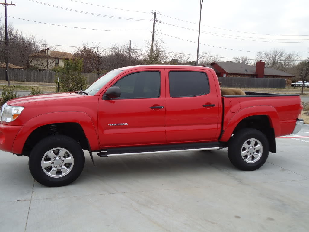

    Here is my 2007 Prerunner before the lift
    I will start Friday morning and have pics up by friday night. I just moved into my house and newly married, so I do not have all tools.
    The tools I will borrow or have are:
    2 Jack stands
    4ton rolling floor jack
    2 6" C Clamps
    120 piece craftsman socket set(includes metric and standard)
    torque wrench
    Rent a spring compress from local auto parts store(or do I even need it?)
    hack saw to cut AAL bolt
    beer and tacos
    Am I missing anything? I will take my time and do it right, make sure everything is torqued and fitted properly

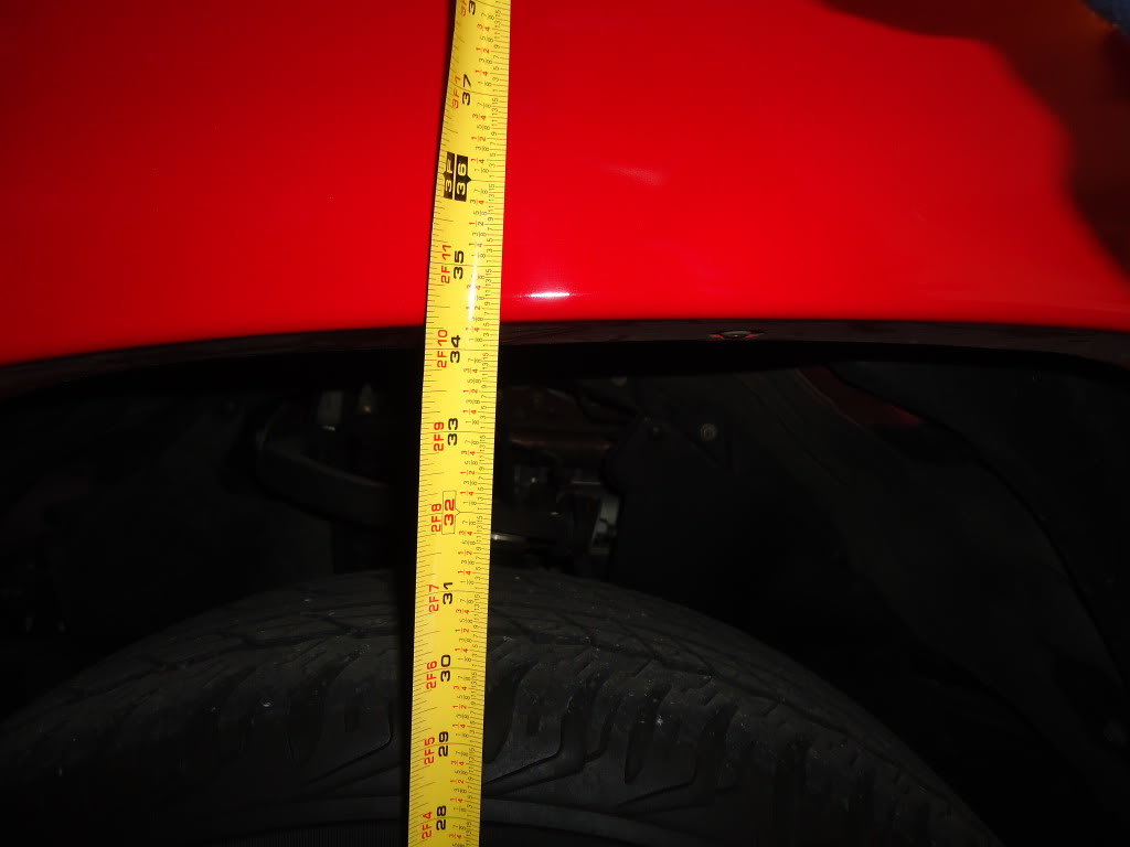

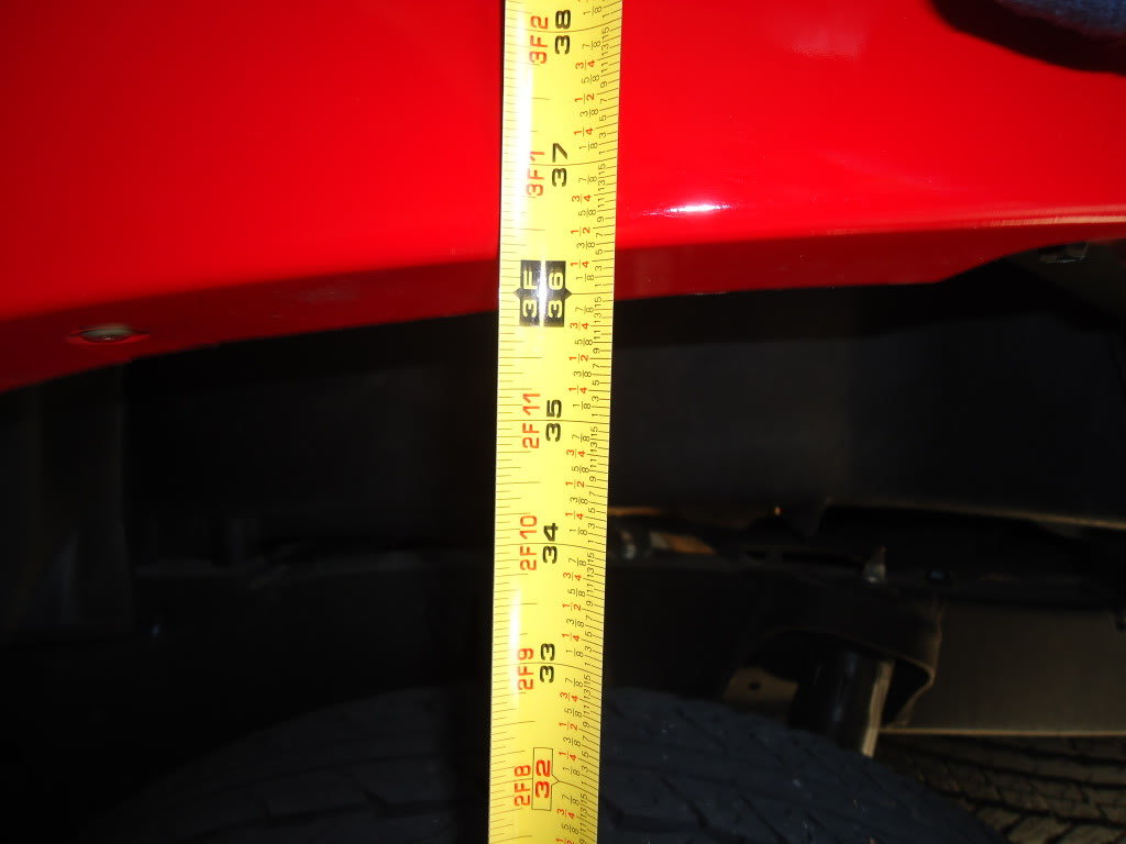

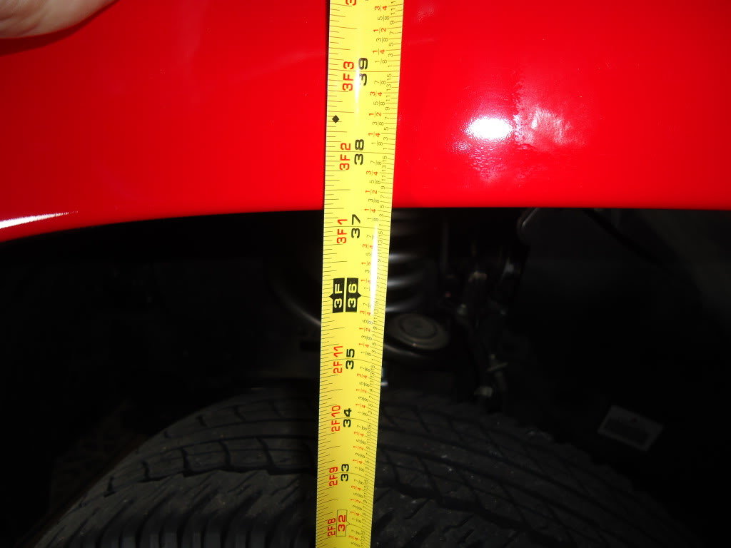

    Here are my stock suspension heights:
    Front
    Rear
    Here is the front measurement after 5100s set at .85 and toytec Eibach shock
    I got a solid 3 inches in the front w that setup
    It was a mother f!@&ker getting them in. I probably did it wrong. I disconnected the sway bar and lower arm and pulled the shocks out that way while pushing the lower arm down. This is my first time to attempt this ever, so cut me some slack. :D

    Southern Cali
    King 2.5" extended travel coilovers with compression adjusters, Camburg UCA's, King 2.5" rear shocks, TRD 1st gen CAI.
    nice! you'll end up with about 2.5" of lift once everything settles

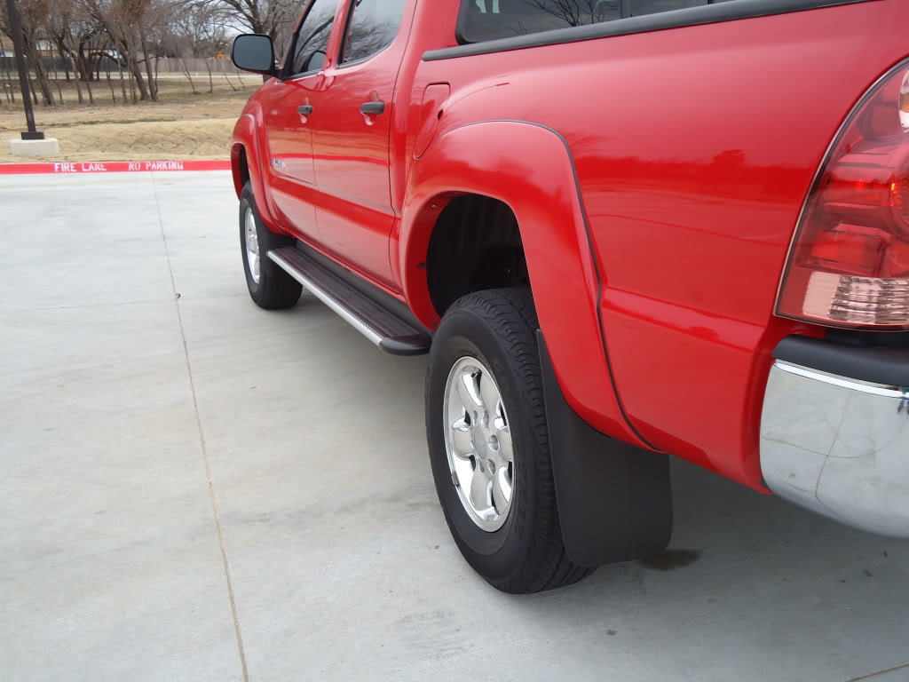

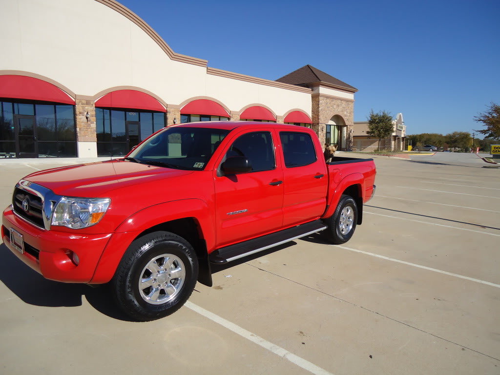

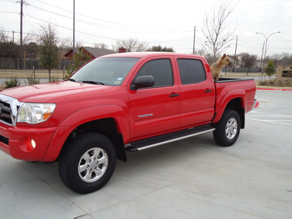

    All finished up
    Stock
    Lifted= 5100's all around. Fronts set at .85. Eibach springs, and 2" Toytec AALs
    Look at those iddy biddy tires. :)
    Next step is FJ Wheels and Falken Mountaineer ATs.

    Did you install top plate spacer to account for lean?
  18. Jan 23, 2011 at 2:31 PM
    #18
    toyo freak
    toyo freak Another Toyota Enthusiast
    Mar 7, 2010
    #32745
    1,507
    David
    Mobile, Alabama
    2010 V6 D-Cab 4x4
    5100s at 2.5, Wheeler 3 leaf progressive AAL, Weathertech liners, yellow wire mod, toyota OEM bed mat, cup holder mod, afe pro dry s air filter, UWS low pro toolbox, Escort radar detector
    Nevernind just saw it any spacer on pass side

    Bilsten 5100s, Eibach Coils, 2" toytec AAL, LR UCAs, SC5 Matt Bronze
    I did a series of "vibe tests" to see what I would get. Heavy acceleration, constant speed at 30, 40, 50, 60mph, and heavy braking. I got no vibes at all.
    The lift w billies stiffened up the ride. I personally think it made the truck feel a lot better. It does not feel like it is "swimming" down the road. It stays planted to the road.
    I did use a spacer for "toyota lean" but no spacer on right driver side.
