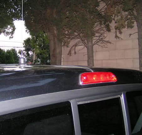

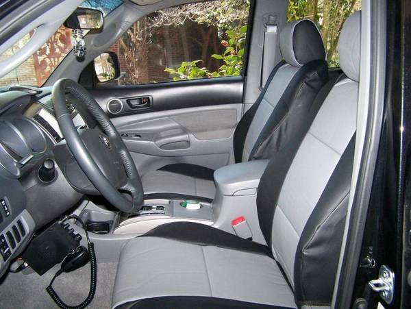

    i kno the pics aint a 2nd gen but u could do what i did and make a box te same size as a radio and put it under a after market radio

    thats the same awsome CB that i have...
    i mounted my CB in the rear passenger cup holder area using a dremel and fine file to cut the area out.
    ran the cable under the brake light assembly rather than going through the sliding glass

    that could work, how did ya wire it thru the dash?
    how do you like the cb radio? i like how ya ran the wire thru the brake light
