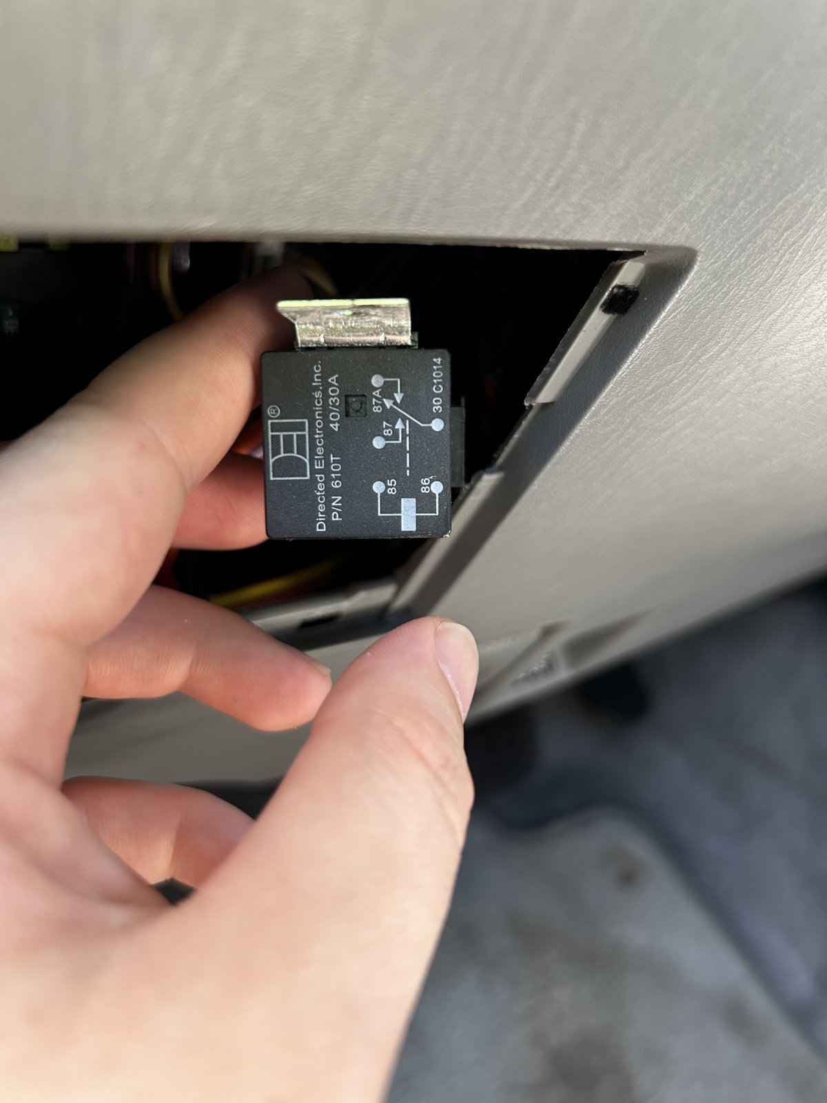

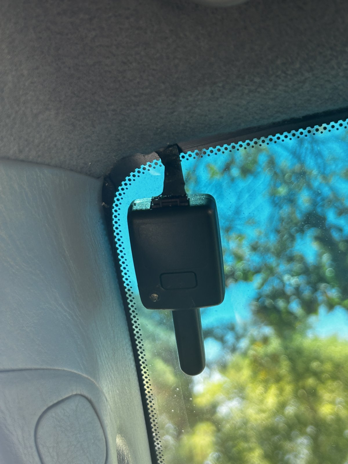

    I have no clue as to what that is on the window?!?

    The piece on the window is the antenna to an alarm system. The button on there activate valet mode. The relay is the kill switch relay part of the alarm system.. my advice is to get a remote and code it to the truck. DEI is the company who make the alarm system… Viper and other name. You can follow the antenna and it will lead you to the module number then you can order the remote. Usually about $20 each

    Also very easy to program the remote, using the valet button. GL
