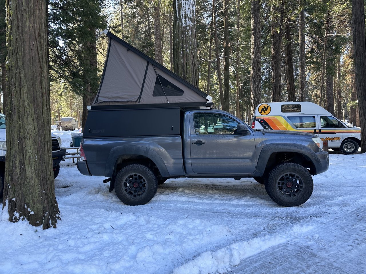

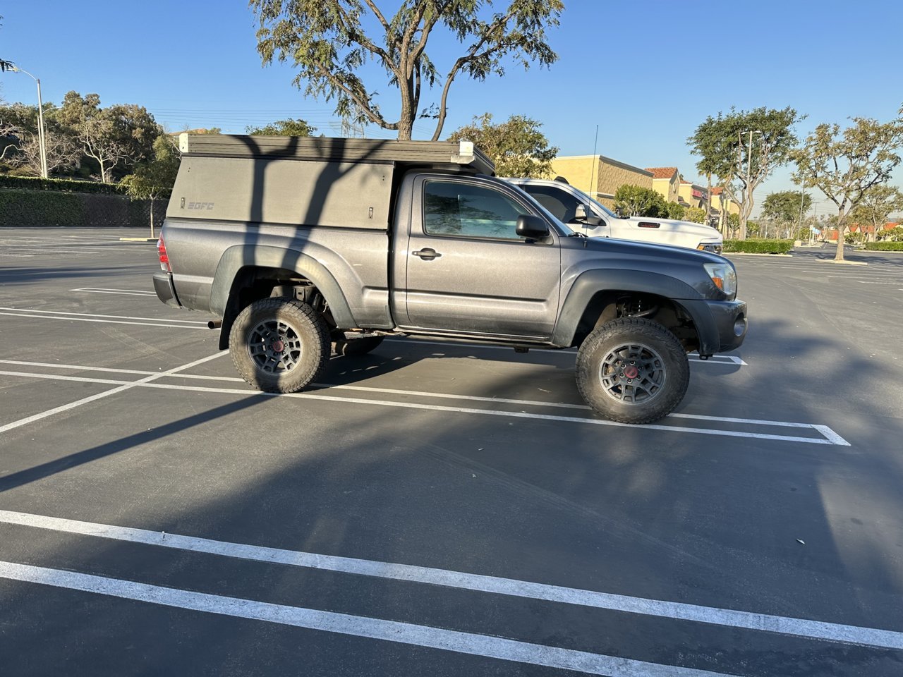

    Our single cabs are obviously a lot lighter including the front end than a double cab v6 so I felt my bilstein 6112s raised the front a lot higher than a v6 dc (compared it to my buddies 3rd gen double cab v6 and he has the exact same suspension setup I do and mine was a lot higher in the front)
    anyway with my go fast camper in the back it leveled it out and looked like it was squatting so I went with deaver stage 3 since I wanted more of a rake look I wrote more of an in depth comparison in the suspension section but here’s a before and after

    @IEsurfer nice looking truck! Did you gain more than 2" going with the Deaver Stage 3? I have an AT Habitat and looking to go Deaver stage 3 as well but concerned about getting too much lift since I am under the 700lbs.

    thank you I kinda screwed up and should have taken before and after measurements but idiot me got too excited. I’m still waiting for it to settle but I’d say it’s a smidge over 2 inches (that’s what she said)

    Ok cool and glad to hear that it wasn't closer to 3-4". Thanks!

    I want to say they’re at the top clips (driver side adjusted for the lean) if I recall bilstein says that’s about a 2.5 inch lift but I feel like it’s a little bit higher (on stock 650 pound bilstein springs)
