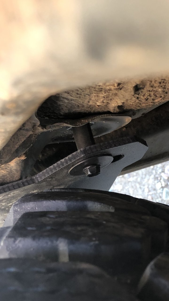

    Dude my rekgens suck i should have returned them. They have a spacer behind one of the bolts up front and the bolt head sticks out so much

    No i never measured them. I’d say i’ll measure them and let you know but I know i’ll forget. I ended up taking the fronts off because my tire was rubbing on the bolt head and am only running the rekgens in the rear

    I just installed my Rekgens today and ran into the same problematic inside-bolt rubbing on the fronts at full lock, and I did shorten the spacer (well, to be precise I used spare spacers from a TV mounting kit since they were already the perfect length, but same concept). I was actually surprised at how well it came out. I'll follow up with a pic tomorrow, but that area of the flap around the inside bolt got pulled down into the recessed area more neatly than I expected it to, and without meaningful distortion of the overall flap's shape. I'm satisfied with it and now it doesn't rub with my 265/75/r16's on zero offset 16x8 wheels.

    I ended up cutting 1/4th of the spacer on front and bolted in. No rub at stock height on 265/70/17s. Cut it down and it’ll work
