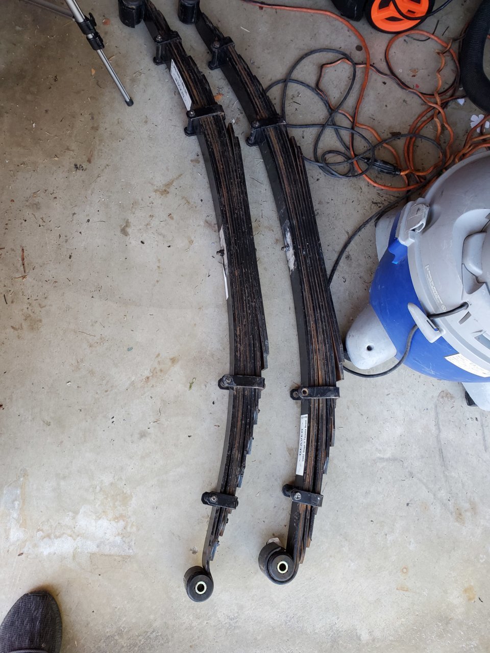

    Used deavers expedition stage 2 arrived
    Soon....soon

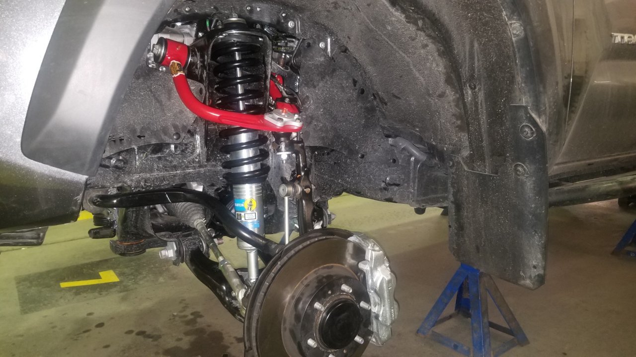

    Just did my 6112/5160s with the OME medium duty leafs. Things are super heavy. Also put the JBA UCAs. Those long bolts for the UCAs are a pain. Watched your video. I can see why u skipped that portion lol.

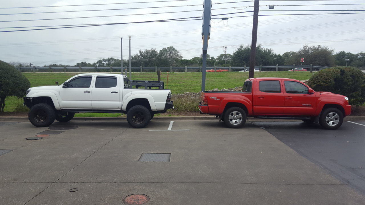

    I had the lean too after upgrading to 700# springs on my ICON shocks. Not too bad but I couldn't take the look.
    I ended up swapping out the ICON 1.5 extra leafs I had for a set of HD Dakars. The ride is a little bit worse but barely noticeable and she sits way more like I want now. Selling the factory leafs with the ICON 1.5 extra leafs for cheap in Houston if anyone want to give them a shot over just the factory leafs. They added dead on 1.5" to my back end.

    Ya. it was a lot of staring and cursing involved so i decided to omit it. lol.
    yours looks great!
    glad you like the outcome

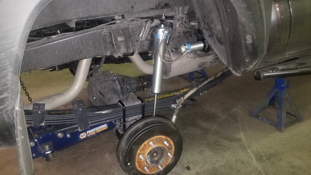

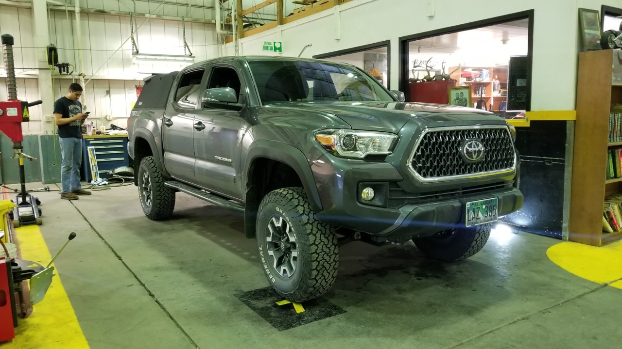

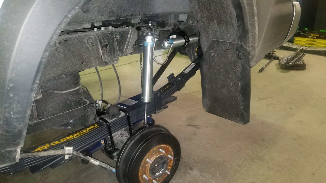

    ok guys!!!
    The bro lean is no more!!!
    Deavers expedition stage 2 and Bilstein RCD extended 5100s installed! Shout out to @Bot_Chu I wasn't feeling good enough to tackle this on my own and he handled it! Awesome dude.
