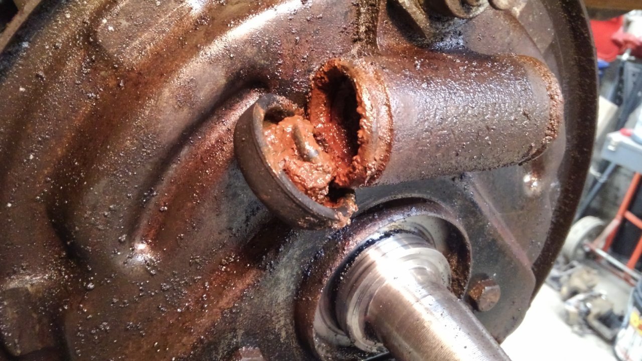

    Area51Runner Well-Known Member

    Brake fluid absorbs moisture over time and should be replaced occasionally to prevent rust/corrosion inside the hydraulic brake parts.
    Part of a brake inspection/service is to carefully pull the boots back on the wheel cylinders to check for any leakage or rusting underneath, below please find a good example of what you don't want to find.
