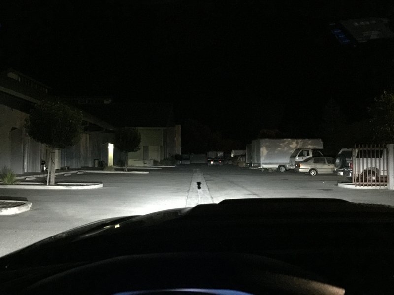

    Mall landscaping pin stripes.
    BMW used to have some of the best lighting, wow. Well, I would place the 2 Stroke setup on par with my Wife's CX5 and about as bright a 35w HID in a MH1 projector. For a 120 dollar drop in solution, that is a value. Would I love to have the 50w MD2S setup I had in my JK Wrangler? Yes! Do I want to tear down the housings to cram some RX350 BiX projectors to get closer to that? No!
    BTW, using 85W halogen bulbs in a confined housing like the halogen projector could do damage to the housing itself from excess heat and no head spacing for dissipation, it's not the same ball game as the 2015/G2 reflector housing where the bulb glass and reflector are wide open and more forgiving of stacked heat transfer like the confined inside of the factory housing.

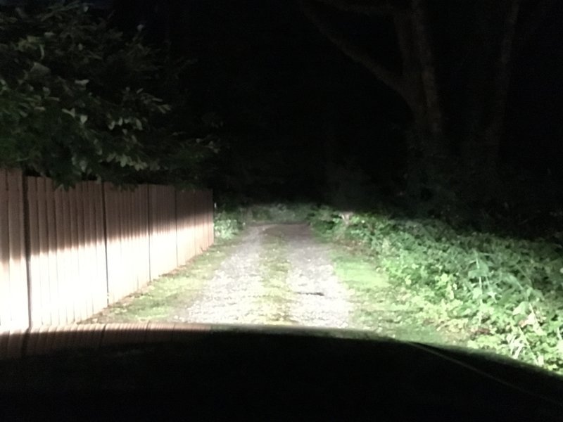

    As a BMW fan it is pretty embarrassing.
    Heat is an understandable concern, I've done the same mod to my fogs which are a much smaller housing that have managed well so far. The fog thread has complete info with temp readings.
