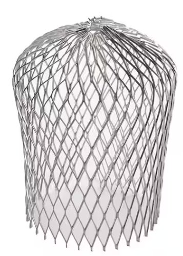

    Also get a leaf strainer (used for gutters) stretch it out, and use it to keep the f*&kers out of the intake for the cabin air. There is at least one thread here about how to do this.
