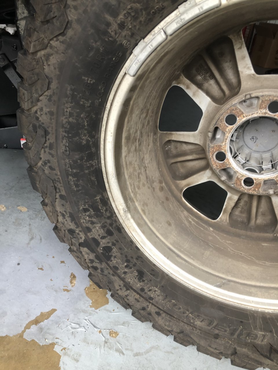

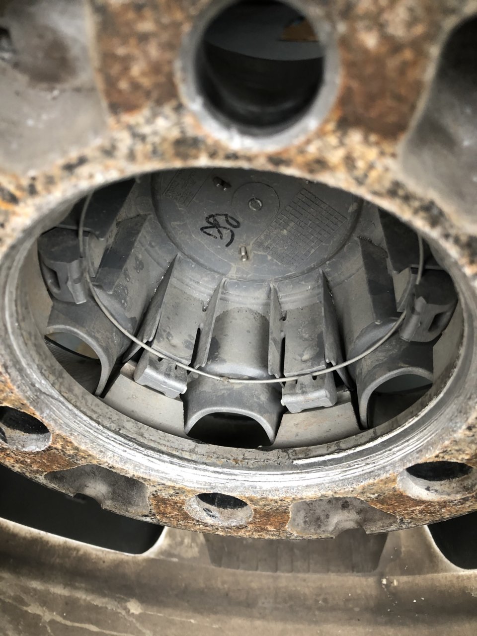

    Are there any good mechanics any more? Took my Tacoma in for PA state inspection and they sent me down the road with a wobbly wheel that wasn’t seated right. I noticed it within a quarter mile and turned around to take it back in. They reseated it and said it was fine. I don’t trust them so I removed the wheel when I got home and noticed it must have been rubbing against the upper control arm (slight tire rub marks) and there were metal shavings on the wheel hub. Am I looking at any long term issues from this? 736A69D6-F637-417F-B970-CE089DDFF4BF.jpg 066ECCD7-8B45-4A54-90C1-8E88989B032B.jpg

    At least 2 wheels, LF/RR or RF/LR... op that sucks. Nobody got hurt but the trust you have in that shop. Glad you were able to make it back and advise them of there mistake.... it is hard to trust anyone with our vehicles.... as a tech myself I had bought a Jeep for the mrs. and was taken back for the same oil leak 4 times to the dealer..... so from that point on I now understand the customers end of it when “shit” happens..... I tell all the youngsters the same shit... put yourself in our customers shoes and see if you like it when you’re on the short end of the stick.

    I would go back and tell them you want a new wheel. Tell them since there is obvious damage to the wheel, you are concerned that the wheel could fall off. Remind them that for the life of the truck, they will be liable for property damage and loss of life if the wheel falls off.

    Ask them to inspect the wheel, tire, hub and UCA. Then put it in writing that all components are 100% within factory working condition.

    Hard to tell the damage on the wheel.... sometimes it’s corrosion that’s built up between the hub and the wheel and sometimes makes the wheel a bitch to get off.... mallet helps in those times.... just as long as the lug holes aren’t oblong, the wheel probably be fine

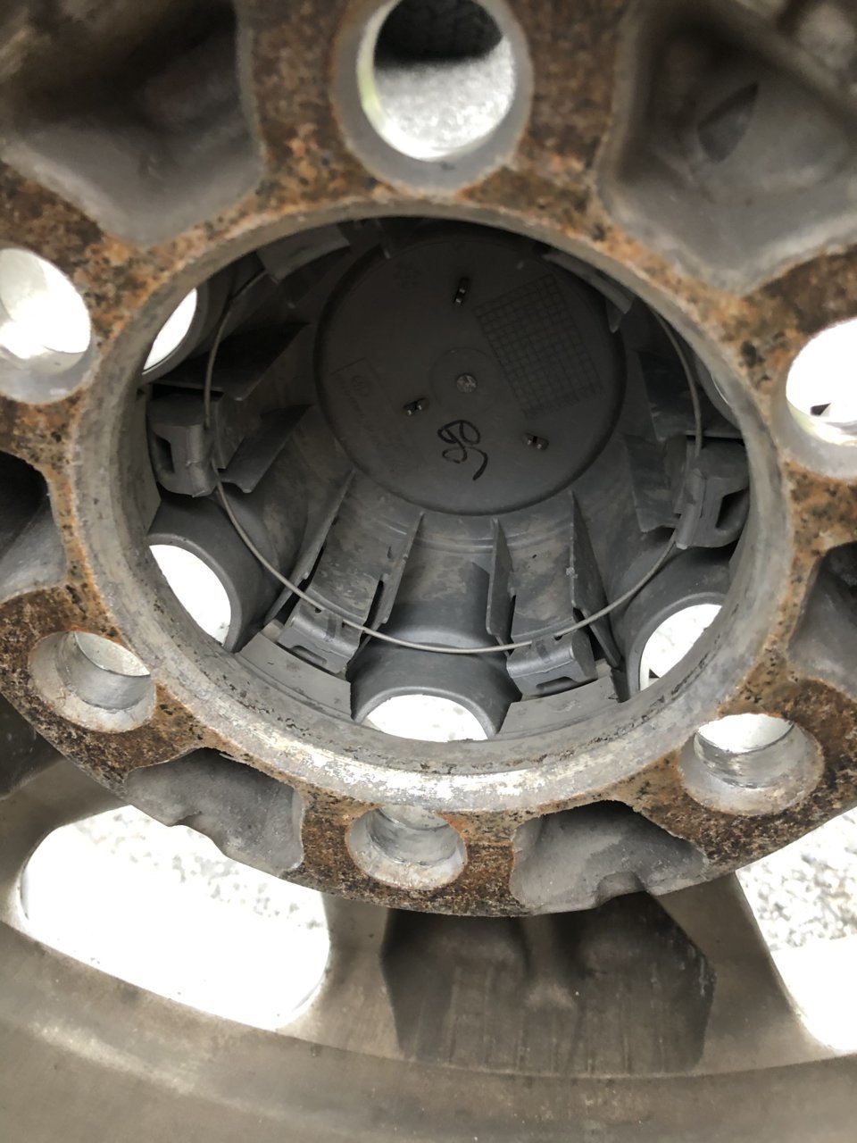

    Here is a undamaged wheel that I removed as well. Should help to point out the fresh shaved metal on the damaged wheel. 96B4AB47-5A6C-4AEF-B09C-B8D7069671A7.jpg

    Did you take the OTHER side off to compare? This will help you determine what they did vs what's always been there...

    Good pic of the the good wheel... if the angle could be like that on the damaged wheel...? Only way to make this right for you would be to take it back to the shop and have you and the manager look at the damage together and come up with a solution to help this situation ....

    Yep, and also the corrosion can prevent the wheel from torquing down properly when it goes back on. I always clean and lube the hub lip and wheel center if the wheel doesn't slip on and off freely
