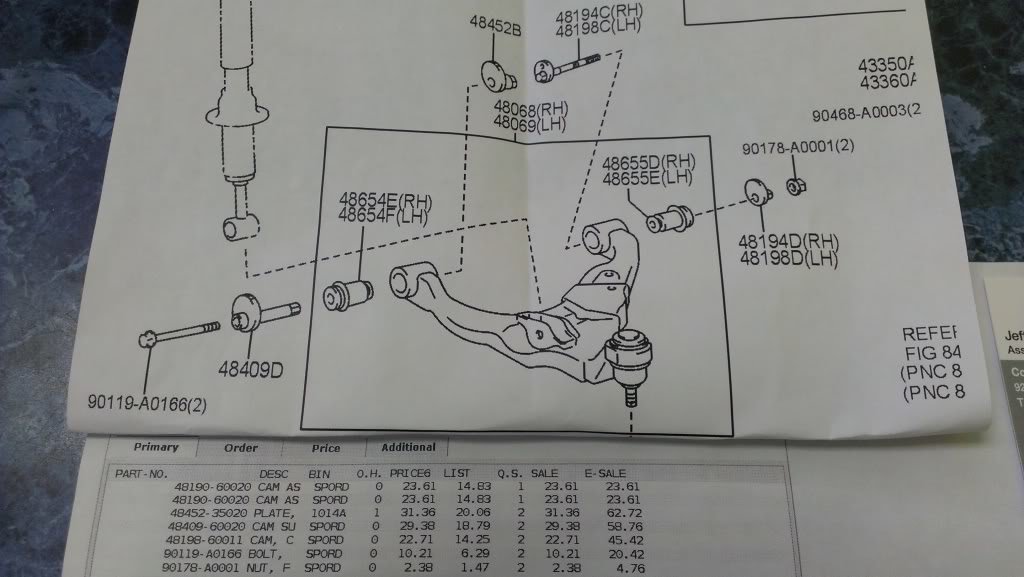

    So I take my truck in Saturday afternoon for a tranny flush and an alignment I had called head of time and they quoted me $90 for the alignment and $160 for the tranny flush when I get there I explain everything to the service advisor he writes up the paper work and let's me know it will be $190 on the tranny flush because they gotta use "world standard fluid" if I'm remembering correctly I said fine they take it in for service and I keep talking to the service advisor about the tranny flush and how I'm a bit apprehensive about doing it he tells me everything is pretty straight forward and that everything will be fine and that there's even a coverage given by toyota to every tranny flush done he hands me the brochure that explains it but as I go to look at it on the front it says valvoline profressional services which I find odd he flips to the section that says my truck based on the miles 123k is covered up to $1000 at which point a more "experienced" service advisor walks in and the one that was helping me starts to explain my concern to the one that just walked in, he goes on to tell him about the "world standard fluid" and how he's charging me $190 at which point the more "experienced" one tells him that he's supposed to charge $300 he looks at me and says that he apologizes and if I still want to do the tranny flush to which I chuckled and say no he runs to tell the service tech I sit and wait for about an for the alignment to get done the advisor tells me there's a situation and takes me to my truck which is on the lift with the aligning apparatus on all four wheels so the service tech can explain to me what's wrong the service tech tells me the bolts on the lower control arms are seized and that all the bushing and bolt assembly will have to be replaced to perform the alignment if not the LCAs will suffer damage and those too will need replacing if the job is not performed in time I tell them to give me a total and that I'd have to be back at a later time they quote me $350 in parts excluding labor plus $90 for the alignment I get in my truck and start driving out of the dealer everything seems fine once I get on the road and get up to 40-50 mph my fuckin steering wheel is crooked about 45 degrees to the right when centered at this point I'm thinking about driving it straight through the dealership's wall, I quickly turn back when I get there I don't see the service advisor who I dealt with so I go in through the waiting area to get to the service tech as I open the door he's in there getting coffee I go up to him and tell him how the steering wheel is crooked and he needs to fix it because that's not how I brought in he tells me he'll take care of it I wait half an hour they come hand me my keys I drive off get up to speed as stated before and now it's tilted about 15 degrees to the left I decide to just call it a day as I didn't feel like spending the night in jail now it's Monday morning I'm sitting at work wondering what should I do should I go back to the dealer or go to an independent shop so they can give me a second opinion on those LCAs really need your opinion on this one sorry for the newspaper I wrote up, thank you
    Parts I need according to them

    Here's my experience with seized LCAs. Toyota, in all their infinite wisdom, did not lube up the LCA bushings or bolts in the factory so they eventually seize up. I just went through this myself. A word of caution, they quoted you $300 for parts only but the labor to do this can be pretty major. The bolts seize to the bushings which means the LCA needs to be cut out and the bolts need to be replaced. This could end up being an ambiguous task and the costs could climb in a hurry.
    http://www.tacomaworld.com/forum/2nd-gen-tacomas/217265-lca-question.html
    FWIW, you can buy the whole LCA with new bushings and ball joints already in place through Camelback Toyota for around $160-170/side. If all the bolts need to be cut, you're looking at another $100 in bolts, washers, nuts, etc plus an alignment but the labor to just swap the LCA could end up being a lot lower. Check out the thread I posted, I put together a parts list of what I needed to be replace and how I did it.

    I soaked mine for a week with penetrating fluid and they wouldn't budge. Once everything rusts together, no amount of PB Blaster is going to free it up. If you wrench on them too hard, you break the bolt head off then you're really up shit's creek. When my truck was brought in for an alignment, the tech put it up on the lift, called me into the shop, showed me the problem and wouldn't even start on it until I knew the risks involved. I opted out and replaced everything myself with some help from local TW members.

    Thanks for the intel so do you think if the bolts are indeed seized should I bother cutting the bushings out or just get new LCAs

    I think that's a decision you need to make depending on who's doing the work and the amount of money you want to spend. If you think your ball joints are going out also, then it might be worth just replacing the LCA entirely. The labor is definitely easier but you'll spend a lot more in parts. This could be something to discuss with your dealership. A LCA swap could be easier and the money you'll save in labor could pay for the parts. If you're doing it yourself, it's a comfort thing. I feel like I'm pretty handy and so were the 2 guys working with me and it took us damn near all day to do the bushing replacement. I don't have a shop press but the rented press from Autozone wouldn't budge the bushings and we ended up resorting to more drastic measures.
    I will say that pressing those old bushings out can be a bitch. Mine wouldn't budge and we ended up burning and cutting them out. A shop press might be able to press them out but again, a risk you take with reusing an old part.
    Another thing to consider, you could probably sell off your old LCA, even with the seized bushing. Someone might be looking for a core to press in new bushings to avoid down time on their rig.

    Sounds to me the $190 they quoted you first was for a drain and fill... not a complete flush. Also, with the rust issues on these trucks those lca bolts could very well be seized up on an 05.

    Good to know seems Boyd had a hell of a job with his three frozen bolts I sure hope mine just need some tough loving and doesn't have to come down to cutting you mentioned $160 per LCA that don't sound bad at all

    I followed Boyd's write-up, that's what got me through mine. $160ish per side but then you need to buy all the bolts/washers/nuts to the tune of about $100 (someone is selling a complete used set of bolts right now for $60 shipped BTW). Some of your hardware might be salvagable like the nuts and cam washers. The bolts will likely need to be cut out though.
