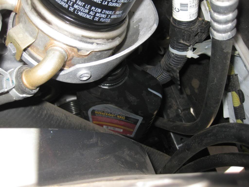

    I hate the dealers too.. Took mine in or an oil change.. They forgot to hook up some vacuum lines AND left a oil bottle under my hood, which got wedged into the alternator pulley and started to smoke/catch fire while I was driving to take family xmas photos.
