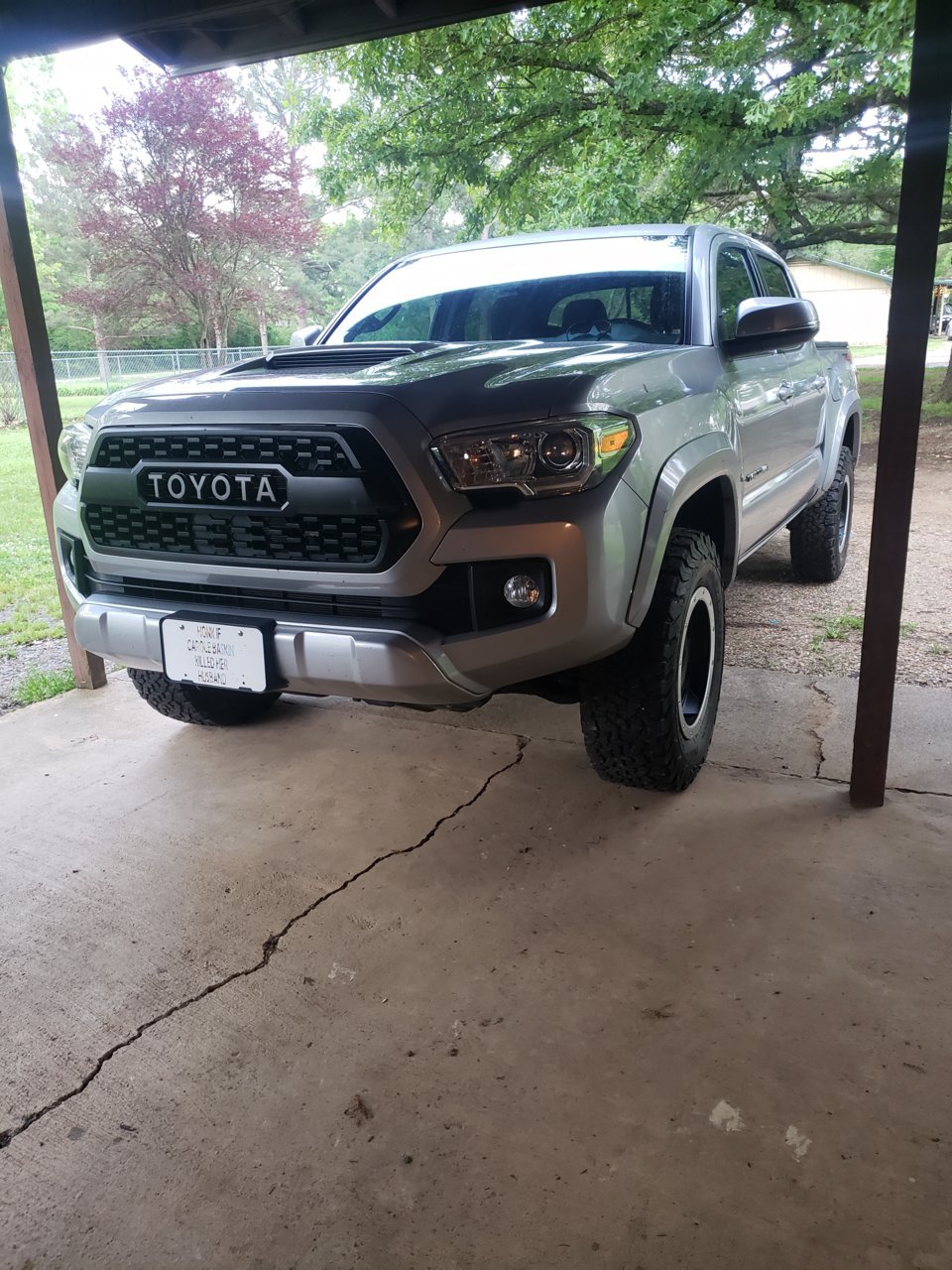

    I'm sure there is another post out there I just cant find it. But I just picked up my trd sport! I'm freaking excited!! But, I have done coilovers on all my other trucks. So are coilovers better then just spacers?? Wanting to go 2 inch to maybe 2.5. Any suggestions? Thank yall for yalls time!

    Coilovers offer a lot more in terms of performance, adjustability, cool factor... they have it all. Spacers are just.... spacers. Congrats on the truck and welcome.
    if you have 4x4, stick to 2” of lift or less, better in the long run.

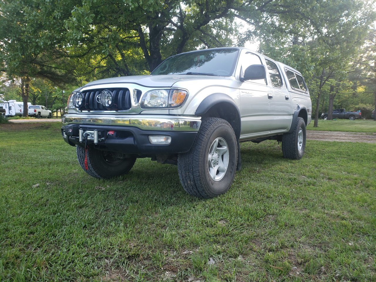

    Both my little tacos

    I'm running 5100s on factory coilovers on my 04, ran me like 300 I think. But I didnt know if there was a product out there I was missing. Like a set up that is the bee's knees for the 3rd gen.
