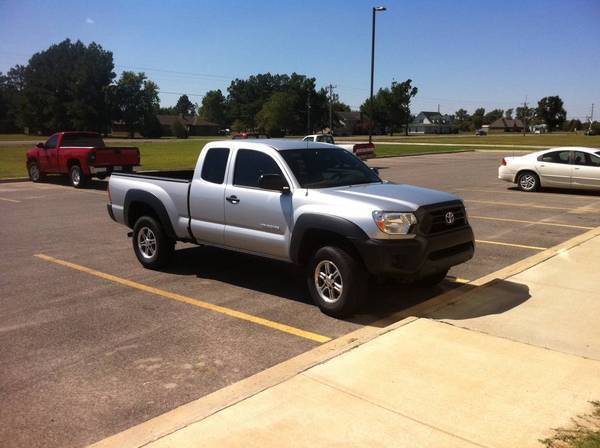

    The boss lady approved a budget! I have $2500 to spend and I have NO CLUE where to start. I've been doing a lot of reading and studying and I think I need the 5100's for the front? And maybe the AAL's for the rear?
    I guess I'm going for a 2-3" overall lift/level and some wheels and tires. I have stock 245/75/616's and the stock rims. I'm counting 3 springs in the back. I'd like some black/blackandchrome rims that are a little wider for a more aggressive stance. I think that's a negative offset correct?
    I just don't want to ruin my new truck with cheap crap, nor over do it. I'm not a SERIOUS off roader, just your typical Arkansas Hunter.:D
    Any suggestions!?!?
