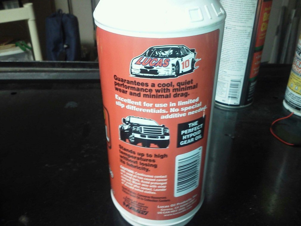

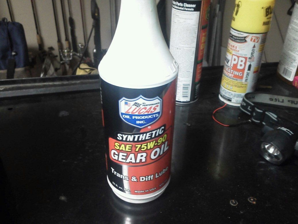

    Used Lucas 75-90, it says no additives needed that it is perfect for LSD.
    This stuff:
    First time using their products in a 4wheeler, been using their stuff in my bikes for awhile now.

    Lucas products usually raise operating temps in diffs or trannies significantly, despite what the propaganda on the bottle says. I speak from personal experience on this, and will never recommend lucas. I'd drain it and put real lubricant in, with LSD additive.

    Lucas is not my first pick either for transmission or diffferential. I run a temperature probe in my rear differential so I'm not guessing either. Keeping the heat build under control during towing has been a major concern of mine with this truck.
