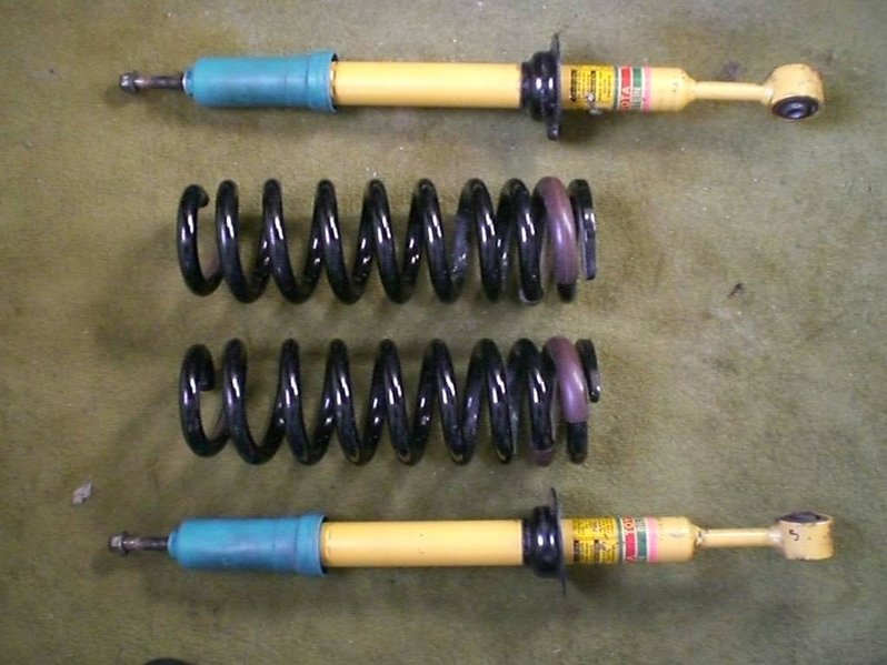

    sr5/sport has a linear spring rate, ex:you need 500(guesstamate) lb of force for each inch you want to compress the coil (1000 lb for 2 inches, etc). OR has progressive, so you need 500 lb to compress 1 inch, but 600 more pound to compress the next inch, 700 lbs of force to compress another inch on top of that. Progressive springs get progressively stiffer the more you compress them.

    Juggernaut's correct. The more down force, the more it takes to compress it even further. You can tell the progressives from the linear springs because the progressives have the coils at one end spaced closer together. You can see it in the attached pic. Notice the decreased space between the last 3 coils on the right side versus the left end.
