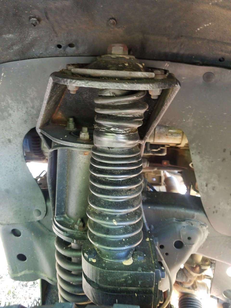

    I need help identifying and fixing a lift kit on a 2000 Tacoma. the Upper control arm was removed with this lift and replaced with a bracket of some sort and then attached to a shock absorber that bolts on to the factory spindle via u bolt. this knuckle extension has worn and the bushing that attaches it to the new bracket (that replaced the upper control arm) is worn. I do not know how to fix or where to buy new parts.

    Can you post some pics, we might be able to identify the parts or lift you have.

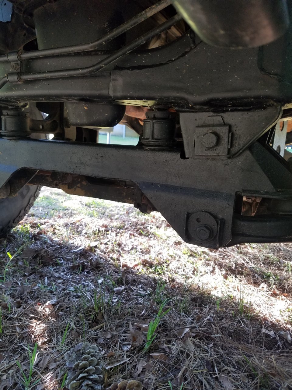

    Is this on a 2 wheel drive?

    Is it a 6 inch lift? I'm asking so I can narrow down some Google image searchin.

    This is the trail master lift kit
    GOOD LUCK
    These kits are a disaster and impossible to find parts for

    Can you take one more picture of the front of the truck at ground level looking at where the front axle would be.
    If it is a 6 inch lift in the image we will be able to see a part called the crossmember.
    At about that angle maybe a bit more front.

    It is the trail master 6” lift kit
    So yes it has a drop bracket

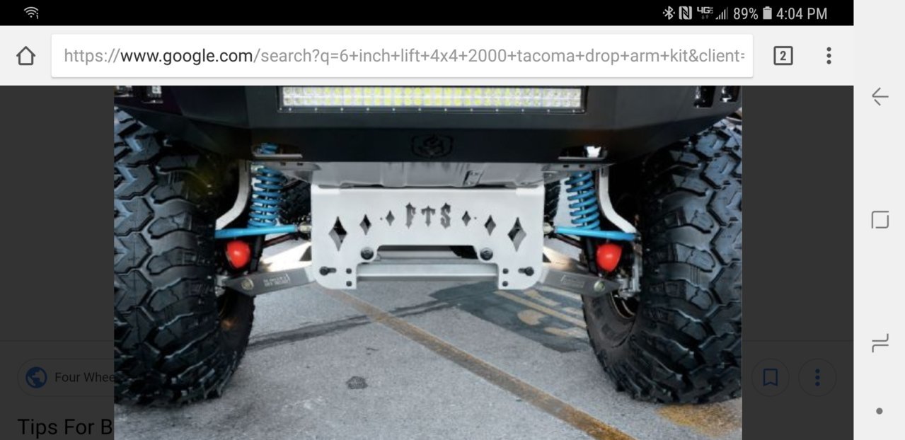

    More like this
  16. Apr 30, 2018 at 4:05 PM

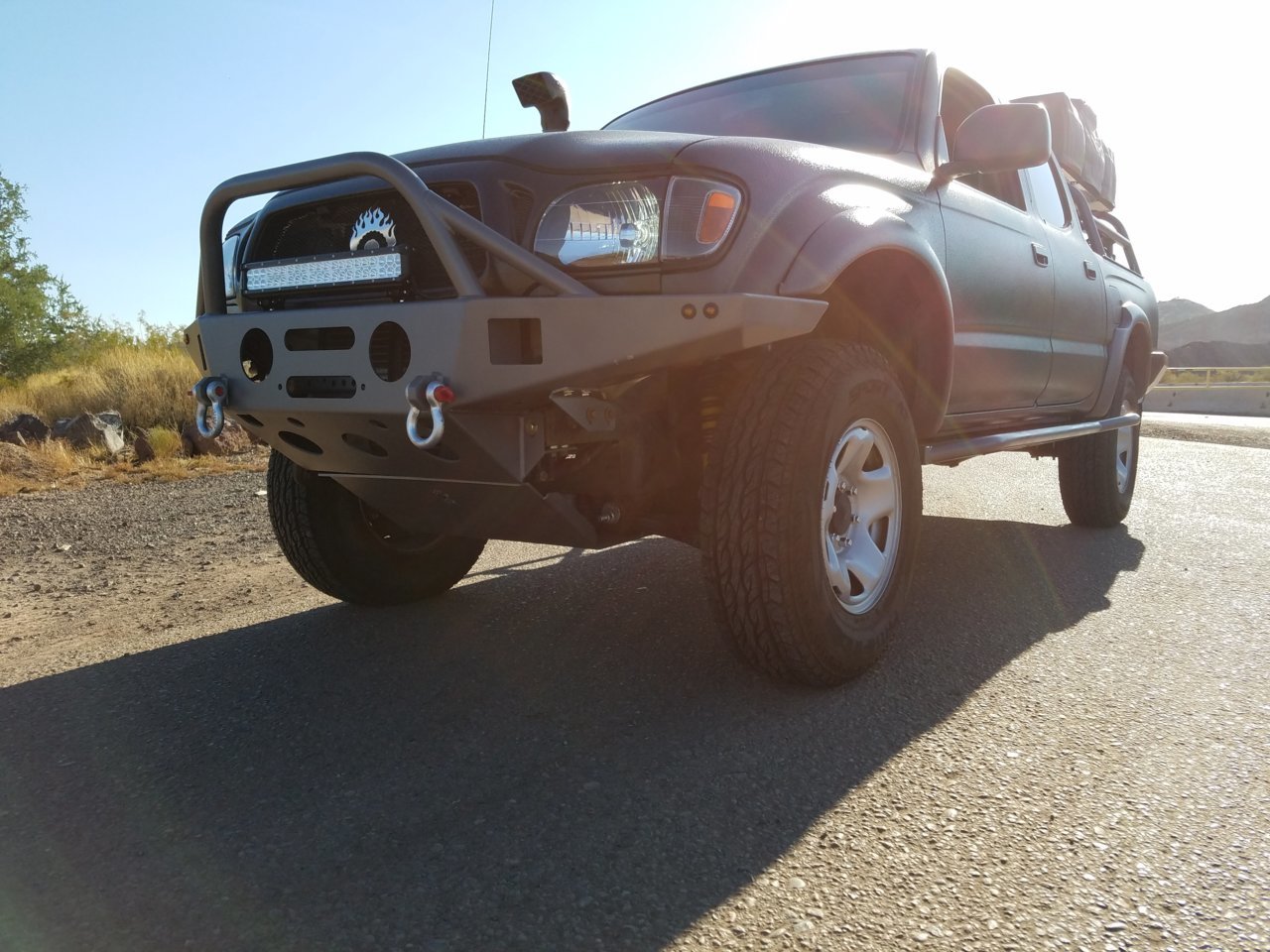

    sorry wrong pix

    do yall have any idea how to fix or will I be able to replace the lift kit with a Rough Country etc...

    Thanks well done.

    I would replace the kit with a different 6” lift
    Also you will have to buy or find some upper control arms/ boltz
