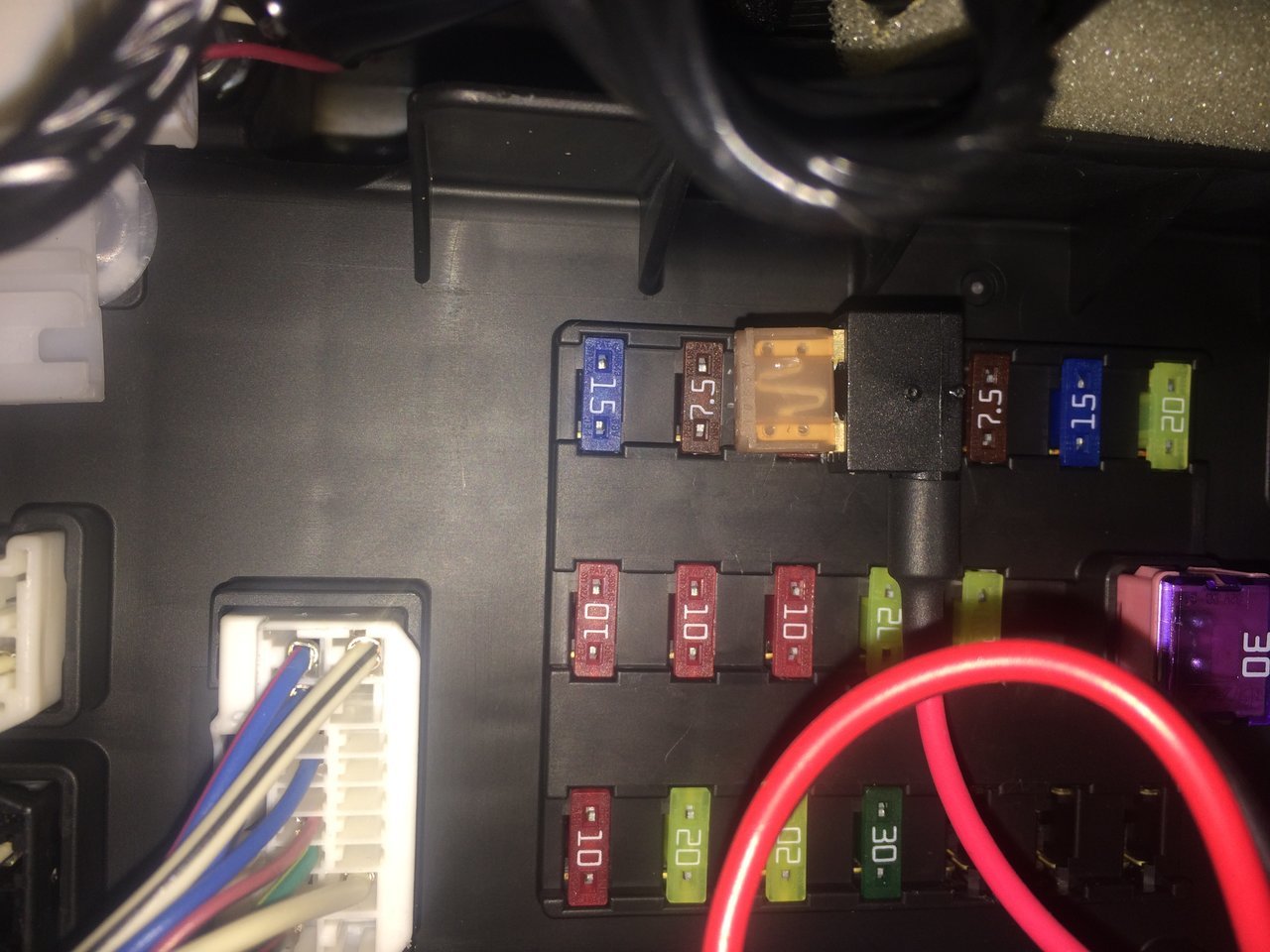

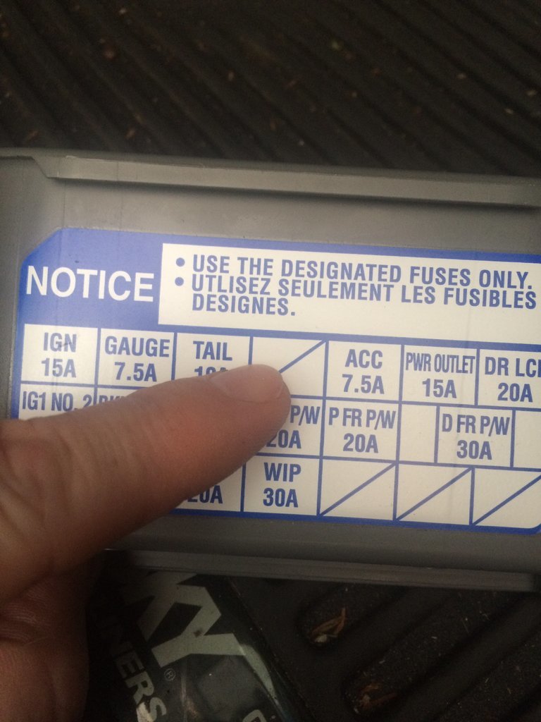

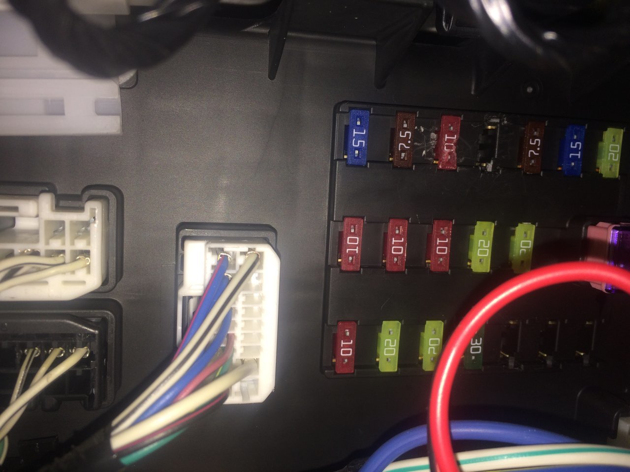

    I ran a fuse tap into the fuse panel under the dash. I wasn't to keen on splicing into factory wires. IMG_4983.jpgIMG_4984.jpg image.jpg

    CountryDan, I like your idea. Is the outlet you tapped into only hot when the lights are on? I only want the switch illuminated while the headlights are on not anytime the ignition is on.

    That worked perfectly CountryDan, the vacant fuse slot you pointed out is only hot when the headlights are on. And I'm definitely going to get some more CH4X4 switches, they fit perfectly, the label lights up with the headlights, and the icon lights up when the switch is turned on to lt you know your lightbar, foglights, etc.. are on.

    so forget dimming. now i am trying get the same result OP was looking for - getting the upper led of my switches to illuminate with the headlights on and the lowers light up when the switch is activated. i have the upper switch led positive lead connected to an add-a-fuse per @CountryDan.

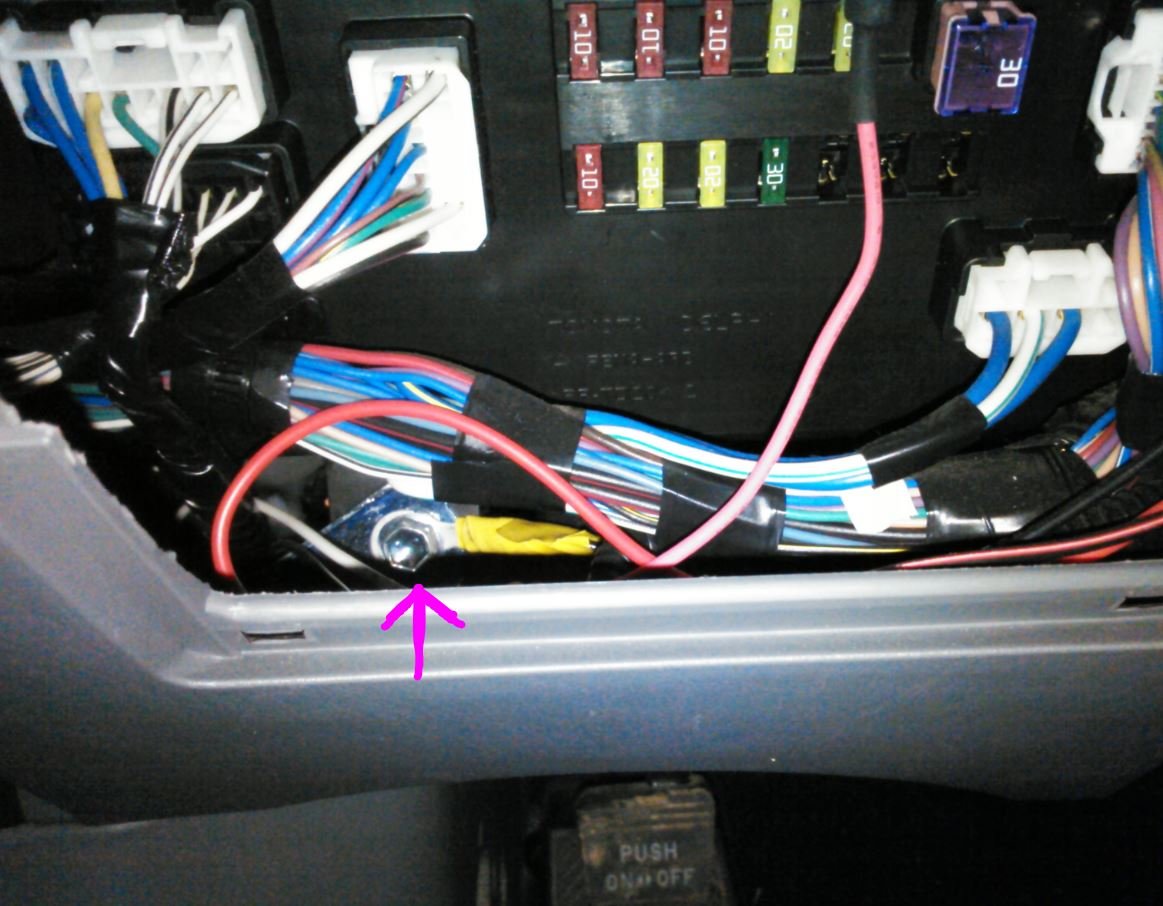

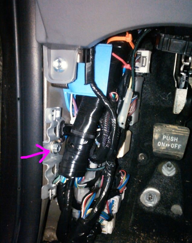

    question: is there a spot to ground in the fuse box area?
    edit: i'm just talking about the ground for the switch light. i don't have much free wire so a screw in the fuse box or somewhere behind the gas or break pedal would be good.

    I grounded my switches on a little screw behind the kick panel.

    2 options for you that I'm using on driver side. Just need a ring style terminal on the end of your wire that's the right size for the bolt to pass through.
    1: Behind the fuse access panel there is a bolt you can use. I have my CB grounded there. It works.
    2: Behind the kick panel there is a mounting bracket with a bolt you can use. I have the switches for my light bars grounded here.

    edit: I couldn't put tap the same spot that @CountryDan used a few posts up because I already have an add-a-fuse in the ACC slot next too it. Not enough space for 2 of those side by side. That's why I just spliced into another dash light to make my switches light up whenever other dash lights are on.
